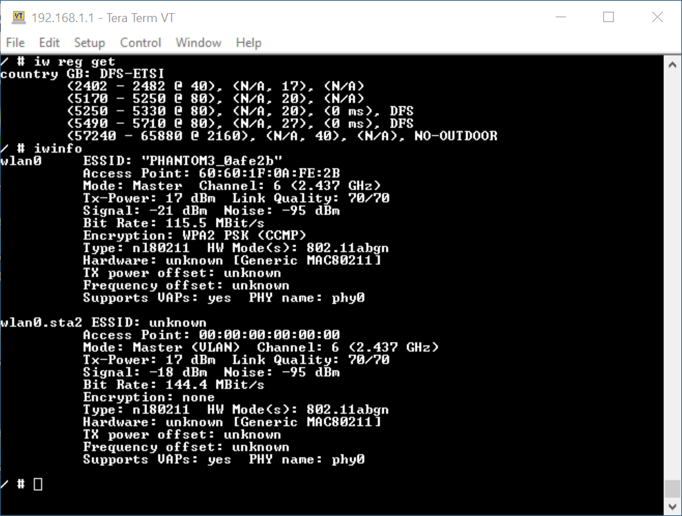

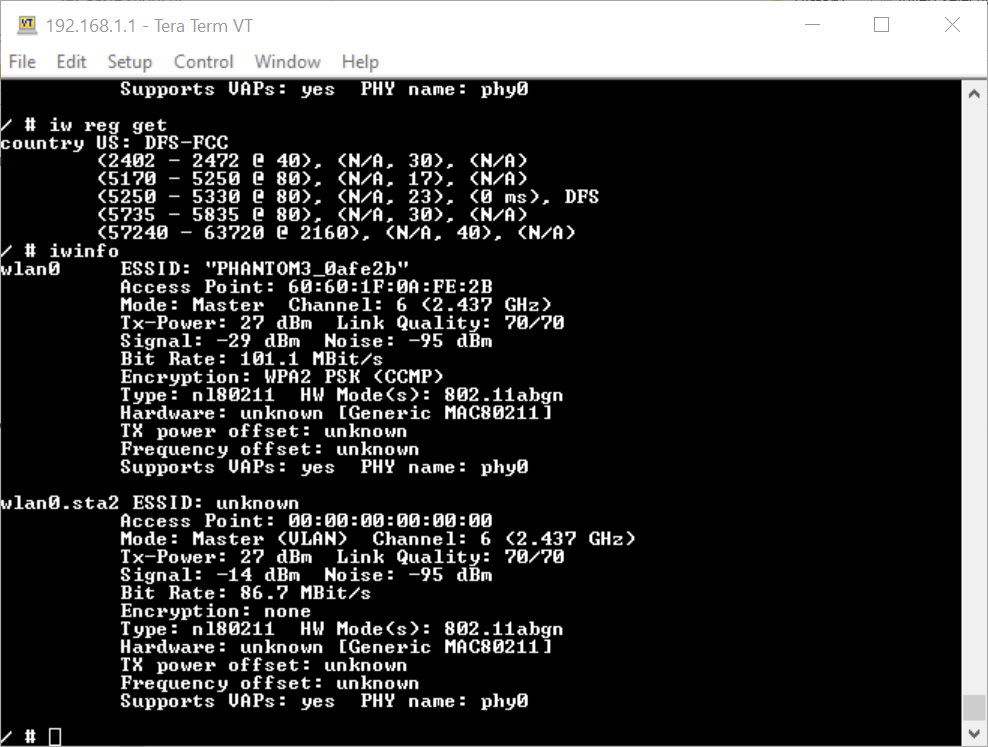

Tend to agree. I stripped my configuration back to stock and on boot up, the RC and AC starts out at 17dBm and my country registration shows as GB (iw reg get). Once the AC GPS locks in and you start the DJI Go App, the country designation changes to US and the TX power jumps to 27dBm on the RC and AC. So, for FCC do you even need to mod? Making any changes to the rcS file makes no difference it always jumps to 27dBm. I can see how the mod would be useful in you are in a CE country but if you are in the US, you are maxed out. I am reading this right?
2016-10-07 10_19_46-192.168.1.1 - Tera Term VT.png 2016-10-07 10_21_50-192.168.1.1 - Tera Term VT.png
