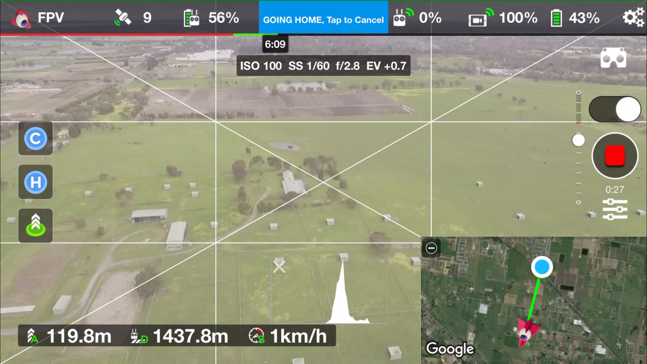

Several times noticed rc signal is still good while drone doing rth and after downgrade did not happen again
