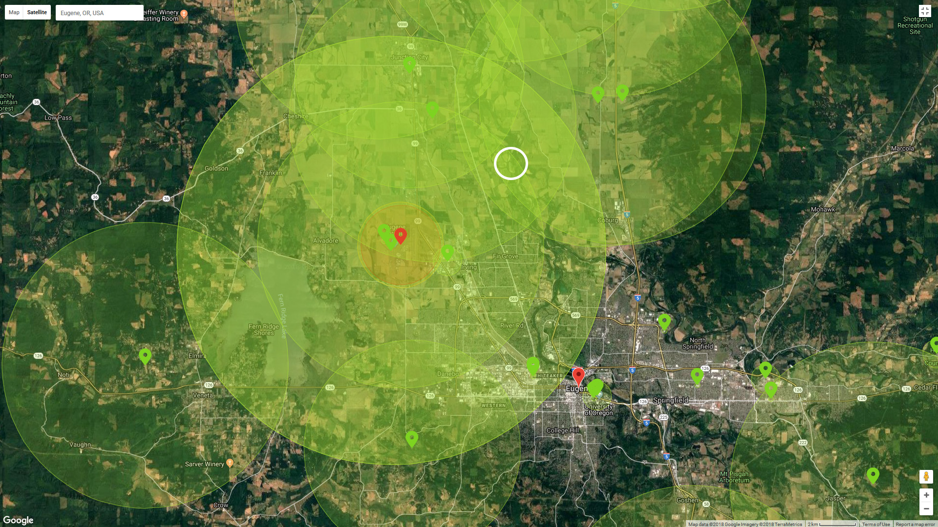

Unfortunately all of this doesn't seem to work any more. It shows 0.000 in DJI assistant 2.0, but it gives no options to update it, and says you must update the main controller before connecting.
Unless I'm doing it wrong. Oh God please tell me I'm just an idiot doing it wrong so I can downgrade. I can hardly fly my P2 anywhere as all the "Warning Zones" even the big ones that you normally just hit ok in the app, cause the P2 to land.
This issue has killed my P2. It won't fly anywhere there is any sort of warning zone. That includes 5+ miles out from airports, tall buildings, etc. Every time I take my P2 off it flashes red and lands. I thought maybe this wasn't a Geofencing issue, but a battery issue. Then I looked at the DJI map here and did some trial and error and anything green when P3 Pro is selected and Enhanced Warning Zones are selected, my P2 will not fly. Find a place on that map where there isn't a warning zone, it flies fine. So it's definitely a warning zone issue. P3s+ just go to the app and select ok fly (my buddy has a P3) but us with P2s are being told by DJI to shove it and buy a new drone from them.
As I've stated in other threads, I'm all for reasonable restrictions. If I can't fly my P2 at an airport (with authorization) because they can't unlock it for me, so be it. I'm a private pilot, so I am all for not allowing flights around airports without permission. Too many idiots out there. But not letting me fly miles from any hazards is just ridiculous. DJI responses to me have wavered between, "That's not how it's working, it's another problem with your drone" to "That's the way it works for safety, we can't make everyone happy, buy a new drone."
Is everyone else with a P2 experiencing this? Is it just some of my zones? Is it a very convenient coincidental problem with my P2 that has just happened to several times work fine in open areas, but land 10 seconds after takeoff if in one of these green zones? I'm absolutely flabbergasted and frustrated.
P.S. I forgot to mention that I avoided upgrading my FW past 2.XXX for this reason. I have done drone videos at small airports with full authorization as I am a videographer and private pilot. one of my videos
I lent my P2 to another video producer friend and told him DO NOT UPDATE THE FIRMWARE! He then proceded to hand it off to one of his assistants who... you guessed it... upgraded the firmware. That was 2 months ago and I've been pulling my hair out ever since.
