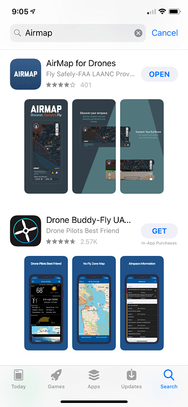

1) Install the Airmap app from the app store on your iOS or Android mobile device.

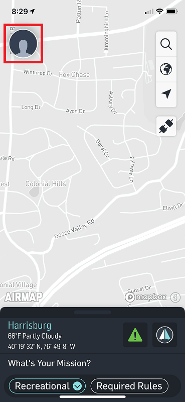

2) Tap the avatar icon at the top, left corner and log into your Airmap account.

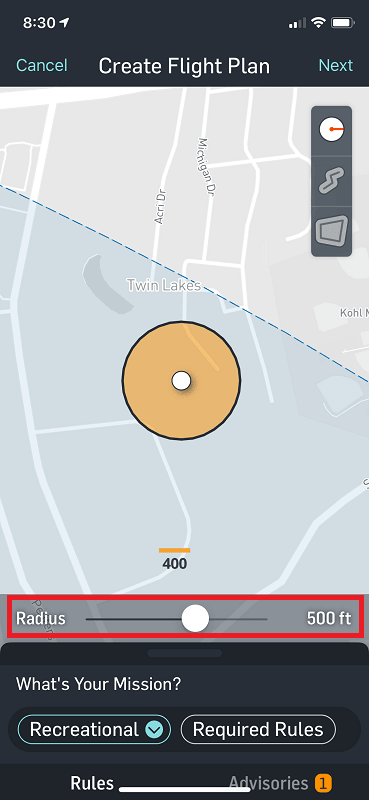

4) Drag the map to the location where you’d like to fly – and then tap and hold the map in the location where you’d like to take off. That should create an orange circle on the map. This orange circle represents the area where you’re going to stay within during your flight.
Tap and drag the “Radius” slider to increase/decrease the flying area.

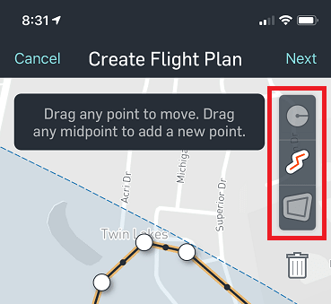

If you’re flying area is not a perfect circle, you can use the other tools in the toolbar on the right to map out the flying area by drawing the flight path or draw a non circular area on the map.
full
After setting your flight area, tap “Next” at the top, right.

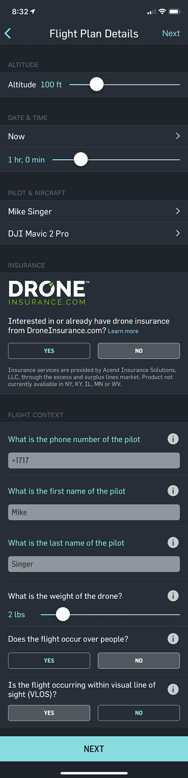

5) Enter your flight plan details and tap the “Next” button.

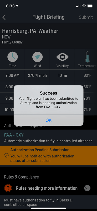

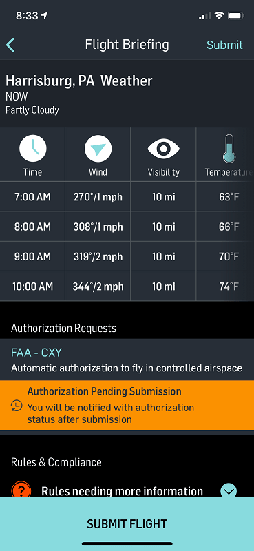

6) Tap the “Submit Flight” button at the bottom to submit your flight plan for authorization.
full
__________
full

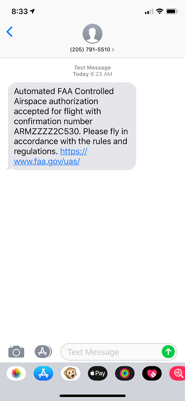

7) You’ll receive a text message when your flight has been authorized. This normally takes no longer than a minute after your flight plan has been submitted.

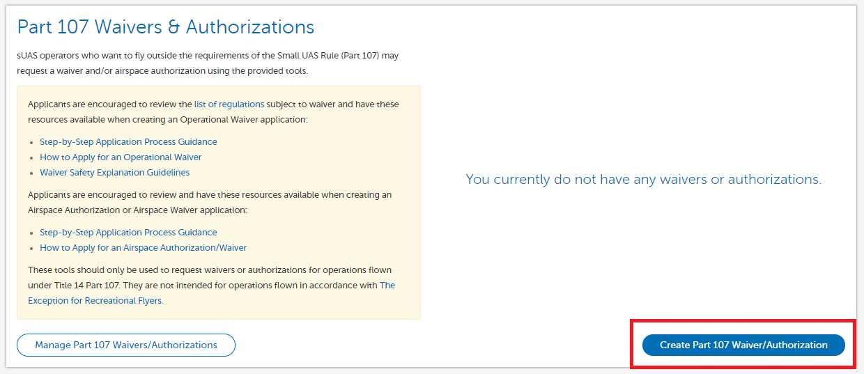

remind me: How do i get clearance if i am not lucky enough to have my airport in LAANC?
You need to log into your FAA account at the top, right here and submit an airspace authorization. If you're flying recreationally, then you need to wait until LAANC is available.
113199
You'll need to fly under Part 107 if you cannot use LAANC.
