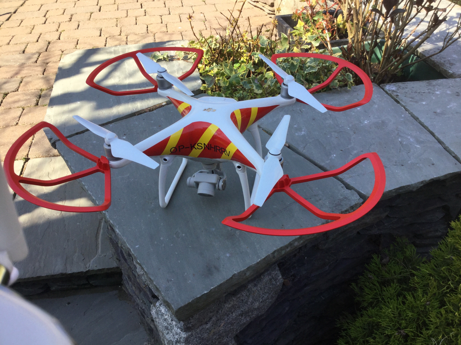

Hello you guys just trying to do some filming to entertain the kids in the village during this awful time. Got my drone out and it doesn’t wants to start, all batteries are charge and in good order. Has anyone any idea what I’m doing wrong please
How did you attempt to start it? What happened instead?

Just as I normally do. Battery in then press and hold the button for a few seconds and ...... nothing instead of booting up
Hello you guys just trying to do some filming to entertain the kids in the village during this awful time. Got my drone out and it doesn’t wants to start, all batteries are charge and in good order. Has anyone any idea what I’m doing wrong pleaseView attachment 118027
We do see this question come up from time to time when someone hasn’t used their drone for a while and they forget the power up sequence.
Are you doing a short press, release, long press sequence?
As stated above, both the remote and the drone need a double press to start. Short followed by a long press.
Please reply if it works or it doesn’t so we’re not left wondering.

Hi, Thanks for your reply and this is where i've got to
I've tried that ... alas .... the drone it's self started but then would not switch off. the controller only has one light lit and not charging ... i'd not used it for about 6 months
I looked on youtube and it looks like the controller I need to take apart and heat the battery which could cure that something to do with its memory, the drone i'm not sure about
I think i'll have a go at the controller first
