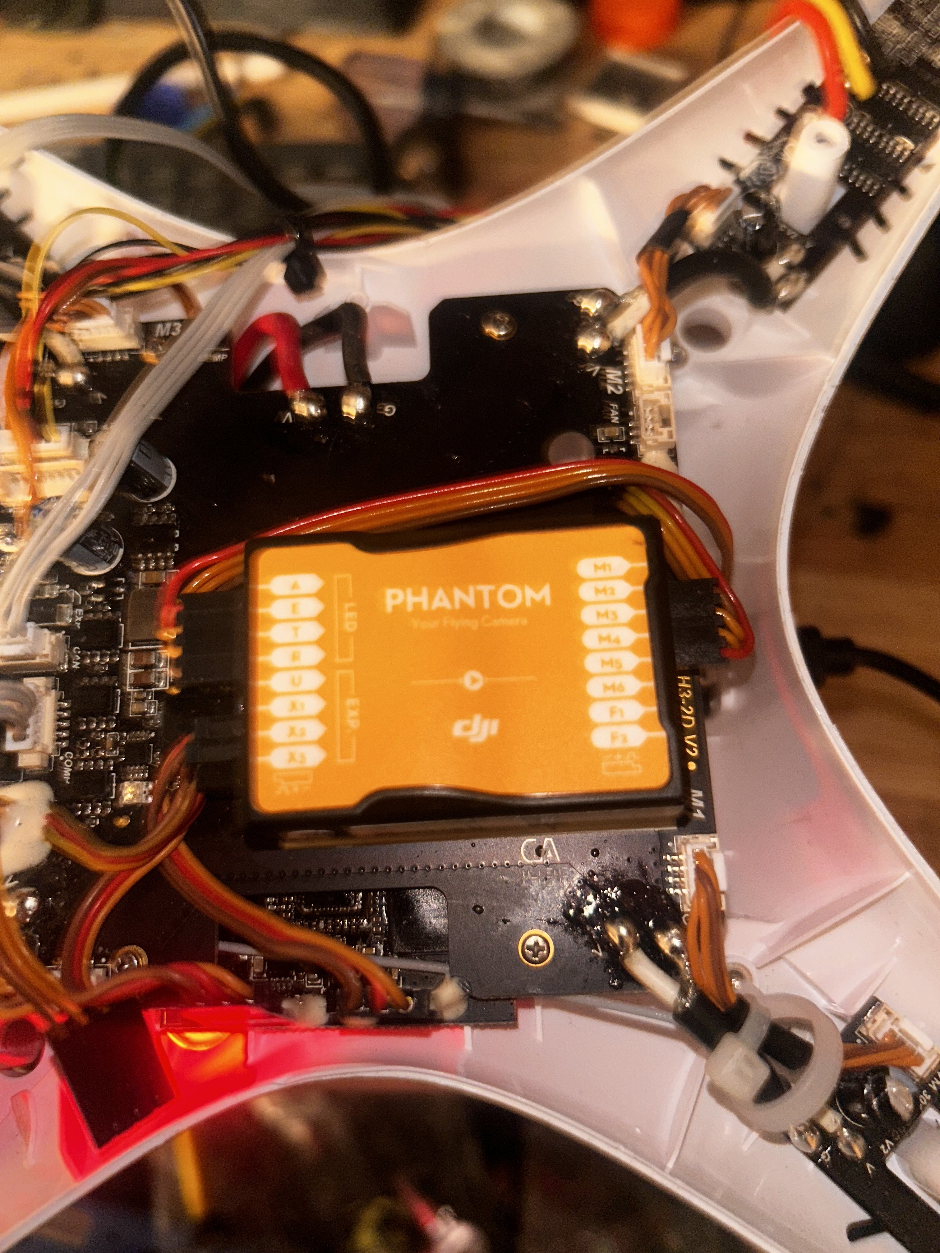

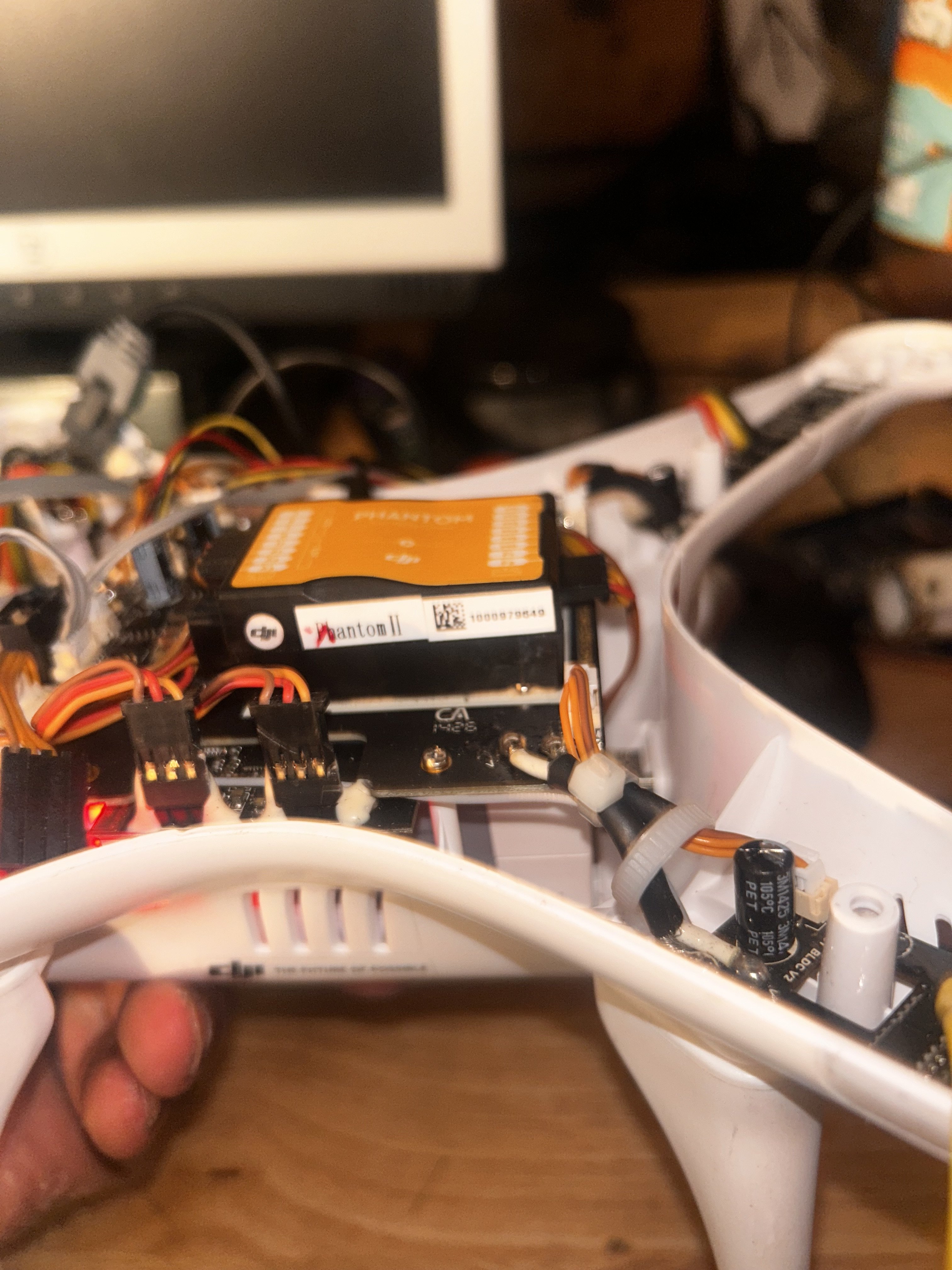

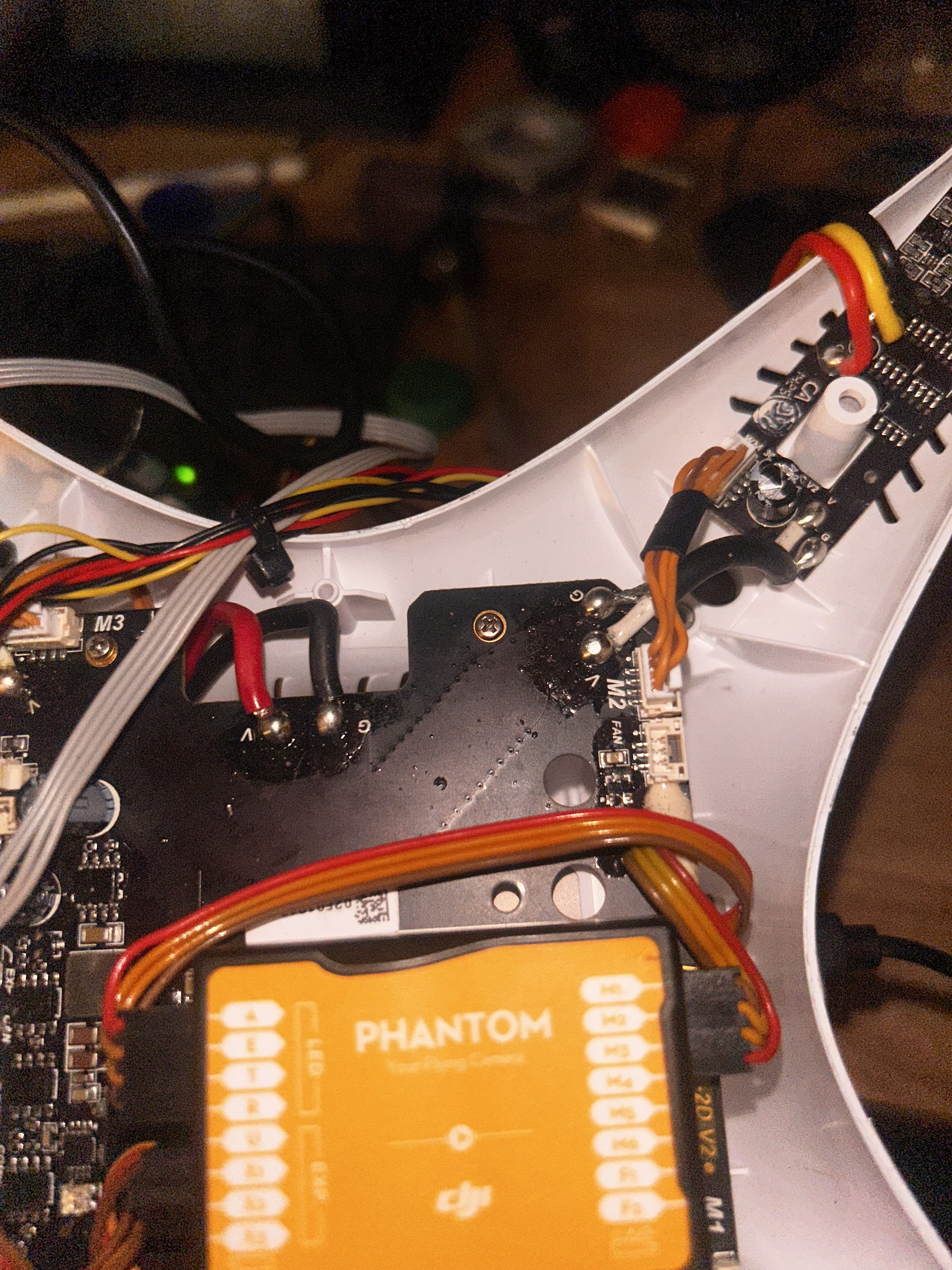

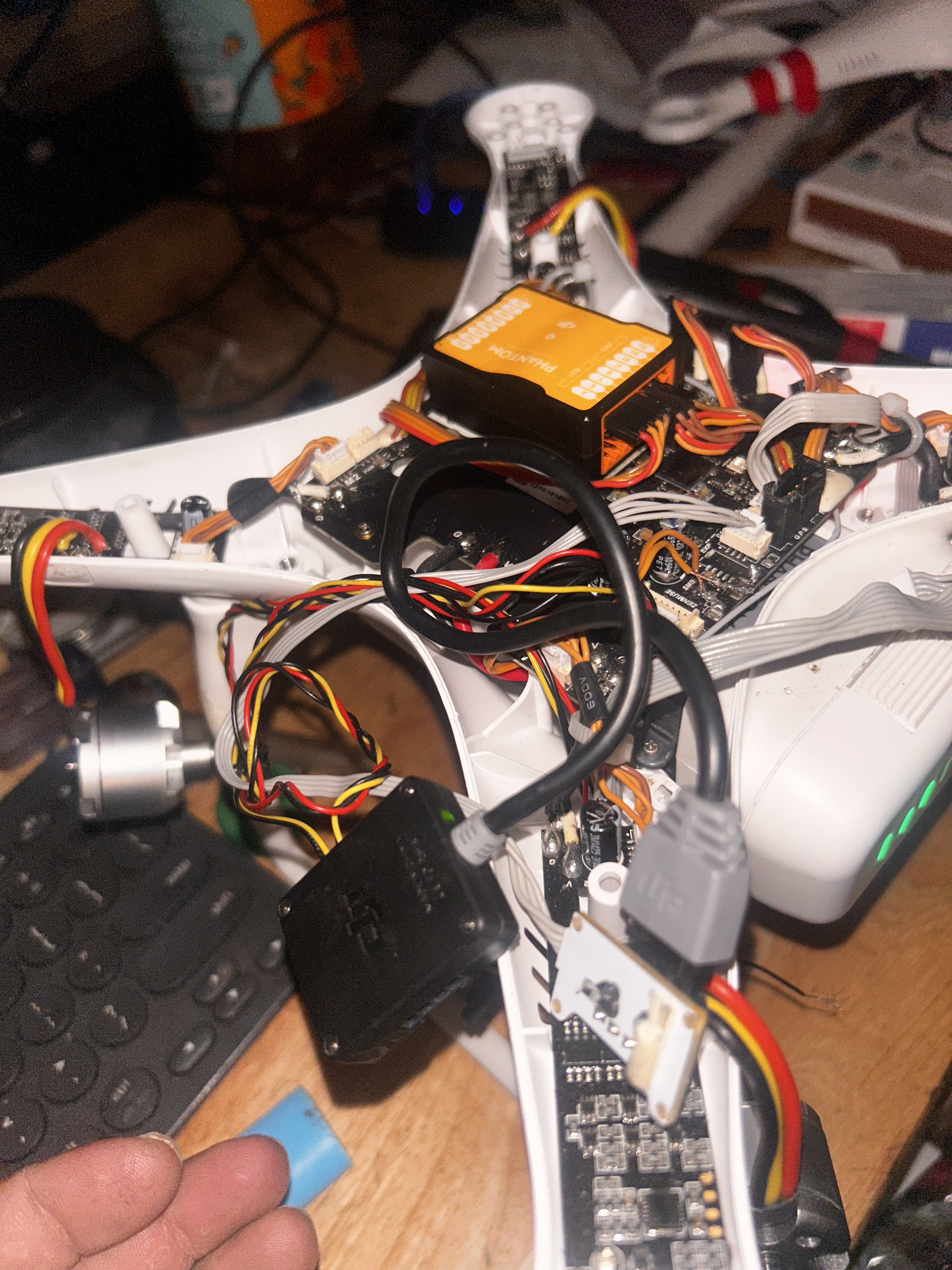

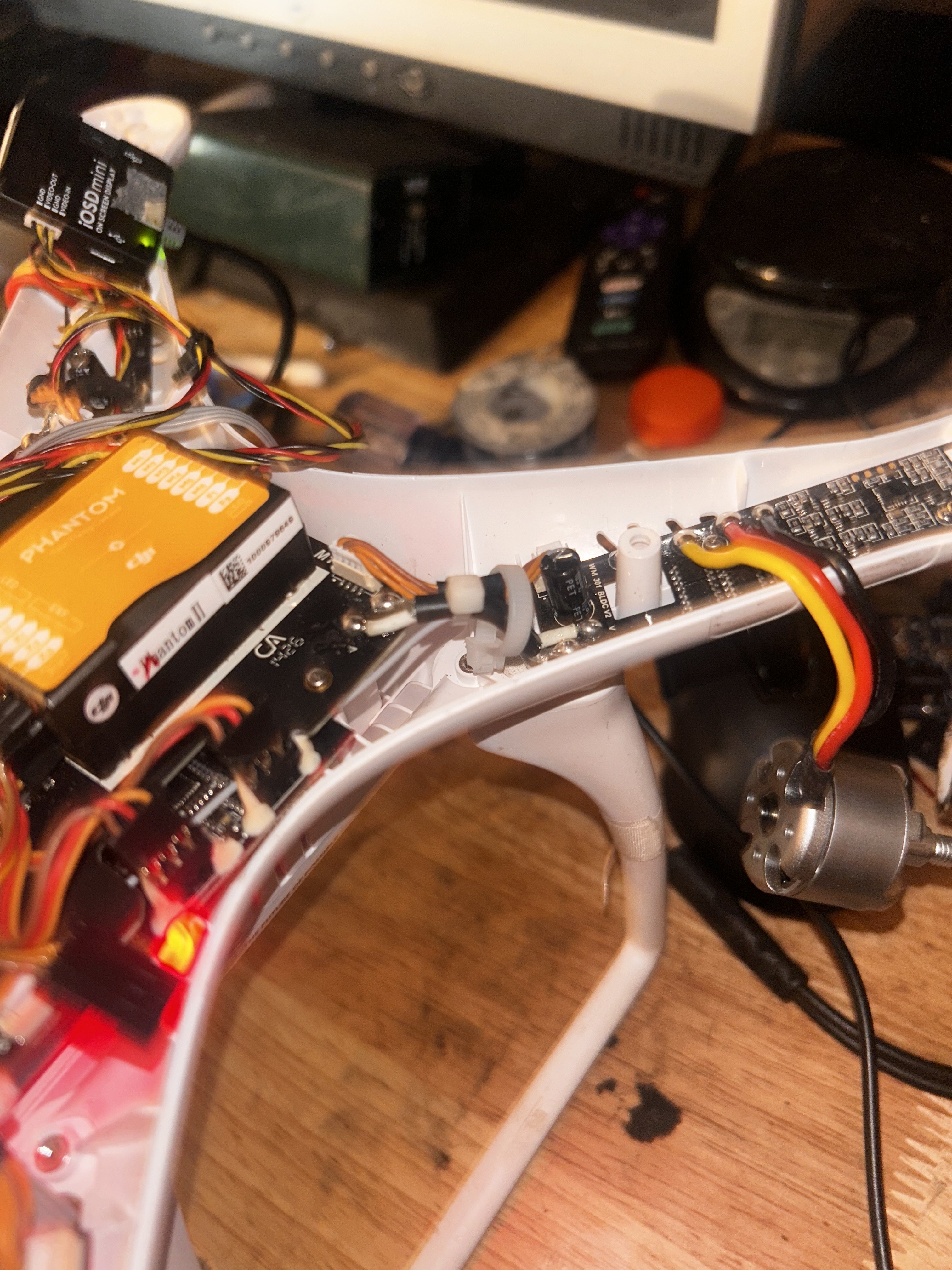

I don’t wanna sound stupid, but how do I find that out? 🤦🏽‍♂️which I probably sound stupid, I know nothing about drones. I found this one online for very cheap price and I thought I’d give it a try. And I hope these pictures to give you that information.

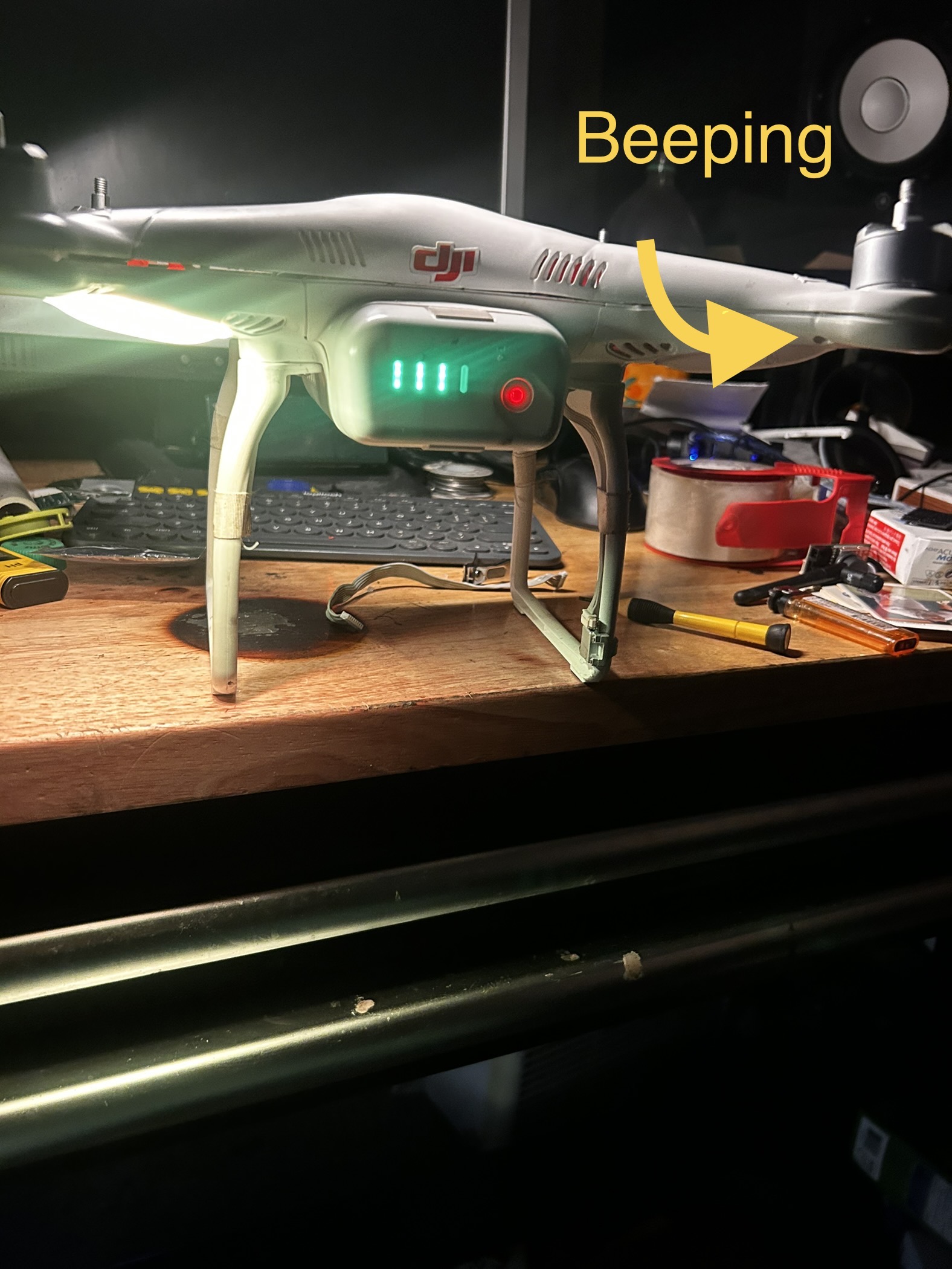

Thank you Rod, for the quick start. I possibly think there’s maybe something wrong with it. When I plug it in and turn it on one of the motors constantly beeps and the controller constantly beeps. Could you possible send any info to how diagnose the two or is there any list of codes, cheat’s sheets on diagnostics? I appreciate all the help.
Any info will help I’m not sure if it’s
Rod any info will help. Anything I’m not sure if it’s even hooked up correctly meaning the wires also, is there any place you can find information about parts and what they do and how they operate etc. Rod, I got a a blink yellow lights on the battery side left wing

Rod, I got an undate. I changed the Battery in the remote and stop beeping. I opened up the motor that was beeping adjusted it and it stop beeping (I need to get a new one) don’t know what I did but it’s not beeping anymore I tried to calibrate the first 360 tern get a green light as I
OK Rod I got the update. I change the batteries. The remote stopped beeping. Of course I should’ve read that. I opened up the motor that was beeping. I touched around little bit move some wires at stop and possibly may have to get a new one. I have no clue why it stopped or what made it stop, I go to calibrate it the first 360 turns solid green the horizontal 360 turns solid yellow and then he goes to a red?

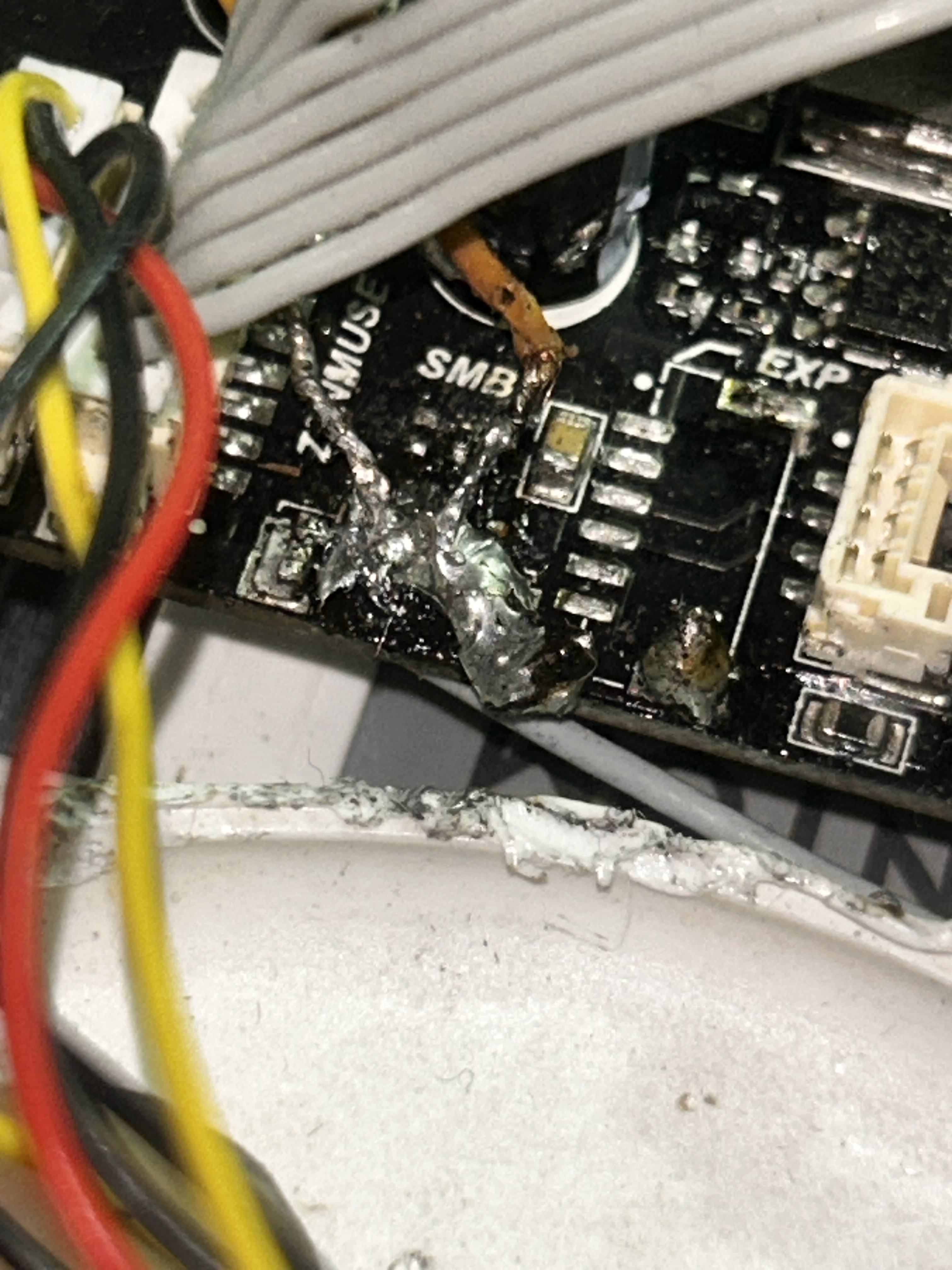

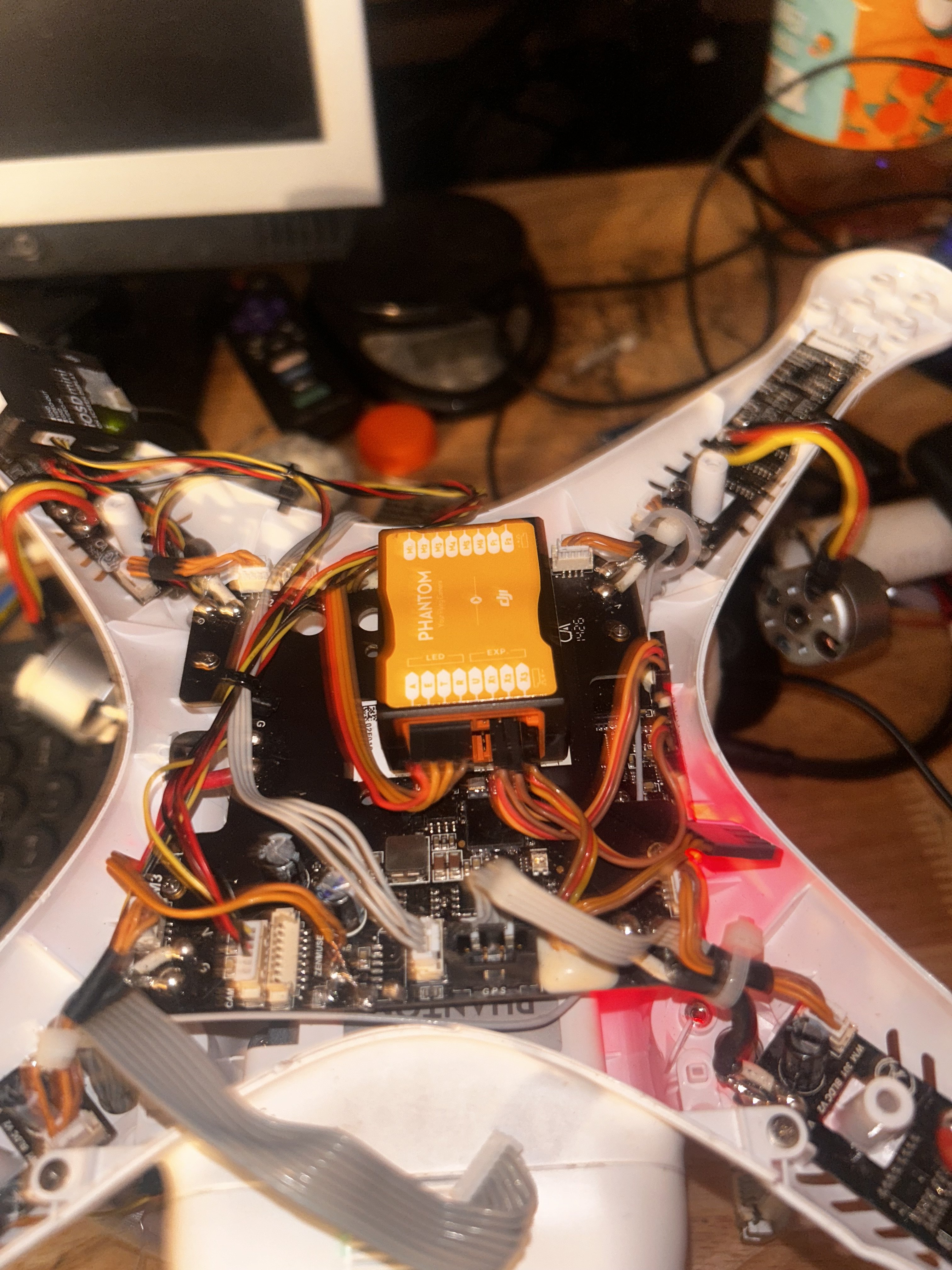

Rod, Thank you for all the info. I can’t get it to calibrate correctly so I did notice some not to great soldering job on the circuitboard and possibly that could be causing it to malfunction I’m going to be ordering a main circuit board. And try to go piece by piece to diagnose the problem. Any suggestions on anything or upgrades I should purchase.

That is a nasty solder joint, OMG!

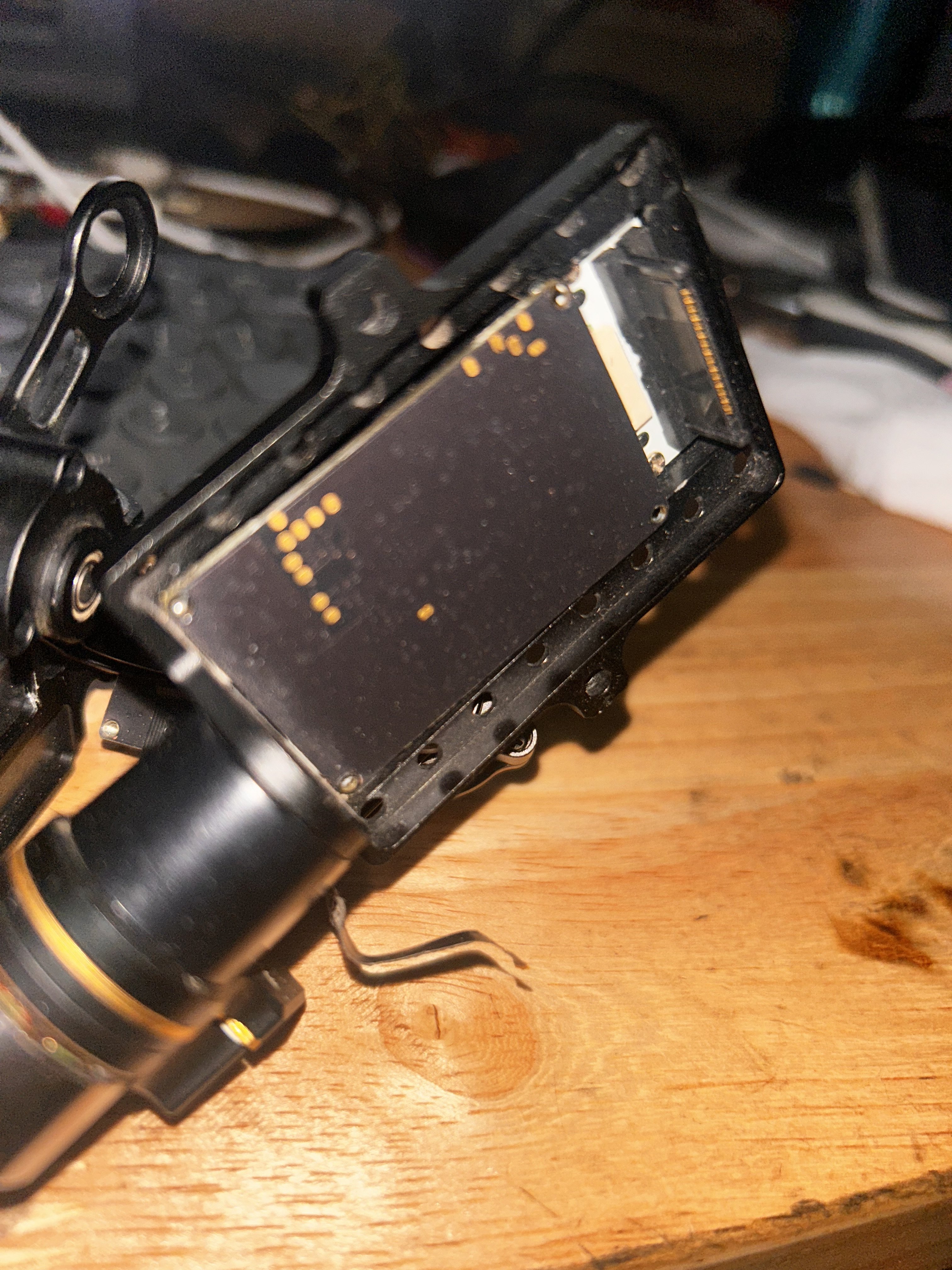

That was another question I was going to ask it came with a gimbal, Zeus’s h33D gimbal but no camera attached to it. And it looks like it was built for some type of camera is that camera available or do should I just buy a whole new gimbal and the new camera? Shall I can’t seem to find the camera plate or shell of the camera that attaches to the gimbal by itself hope that makes sense?
I have know clue about this question. 👌
