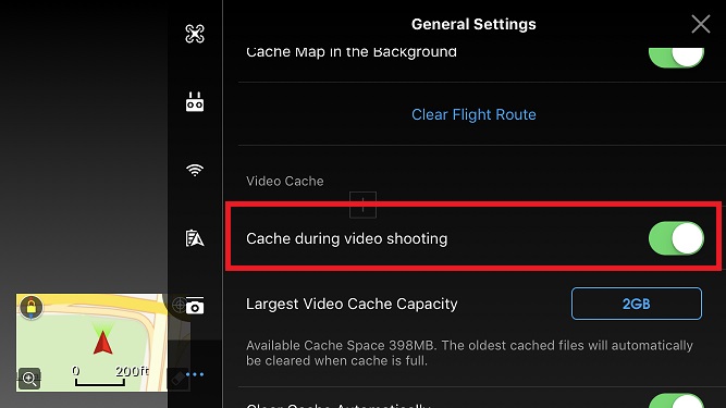

Disable the "Cache During Video Shooting" setting too.
