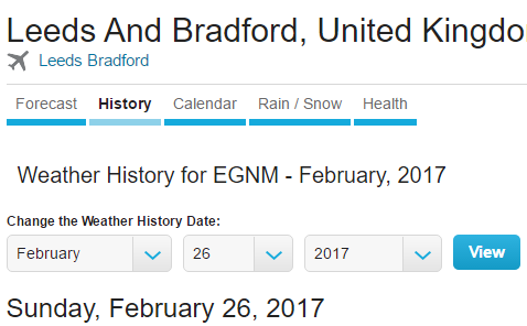

What's your point. Settle is about 100 miles away from both Bradford and Leeds? ??
Again? ??? What's your point.

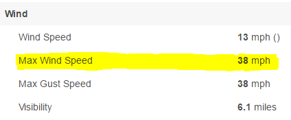

Looking an overview tour highlight. Wind speed 13 miles an hour. Gusts max 38.
Definition of a gust is: a short burst of wind not prolonged.
It states that the max wind speed was 38mph as well. The average wind speed for the day was 13mph, with winds up to 38mph. At 700', winds could have easily been 25-30mph. I'm not saying DJI was right or wrong and I'm not saying it was pilot error. I'm only added facts to the post.
