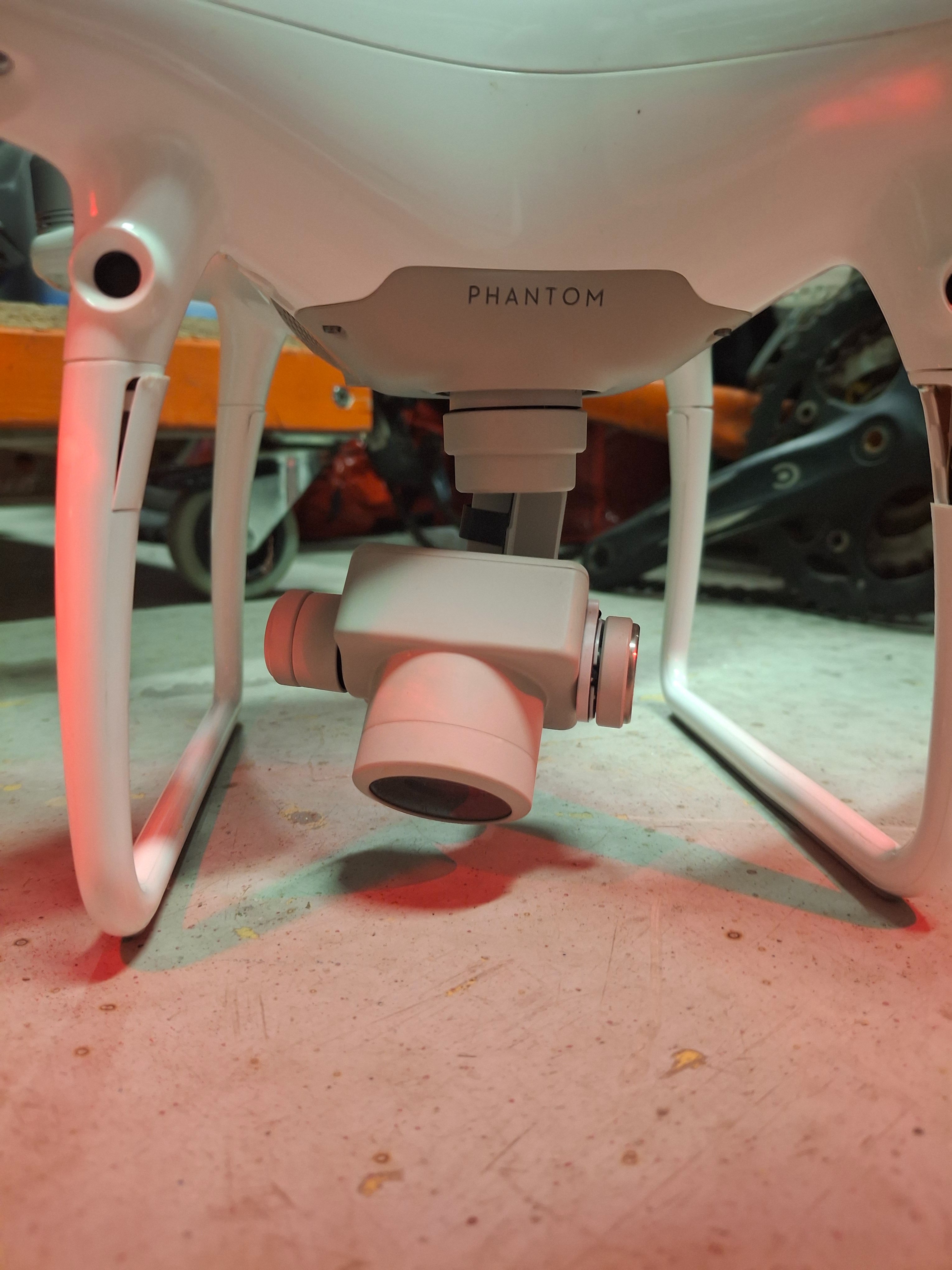

When the drone is off is the camera npt straight. It points a little to the left.
And when I start it up the camera can only look down.

From the looks of the legs, it probably had a hard landing in the past. That could easily cause gimble problems like from a broken ribbon cable, a bent shaft or arm, weak gimble motor, etc. History of this drone is needed, especially before pouring money into elusive repairs.
Even when the drone has had a hard crash it would be helpful to get some more info for instance on color and action (flashing) of the front and back lights of the drone when the AC is on (see the P4P manual page 14 for explanations and the various patterns).
