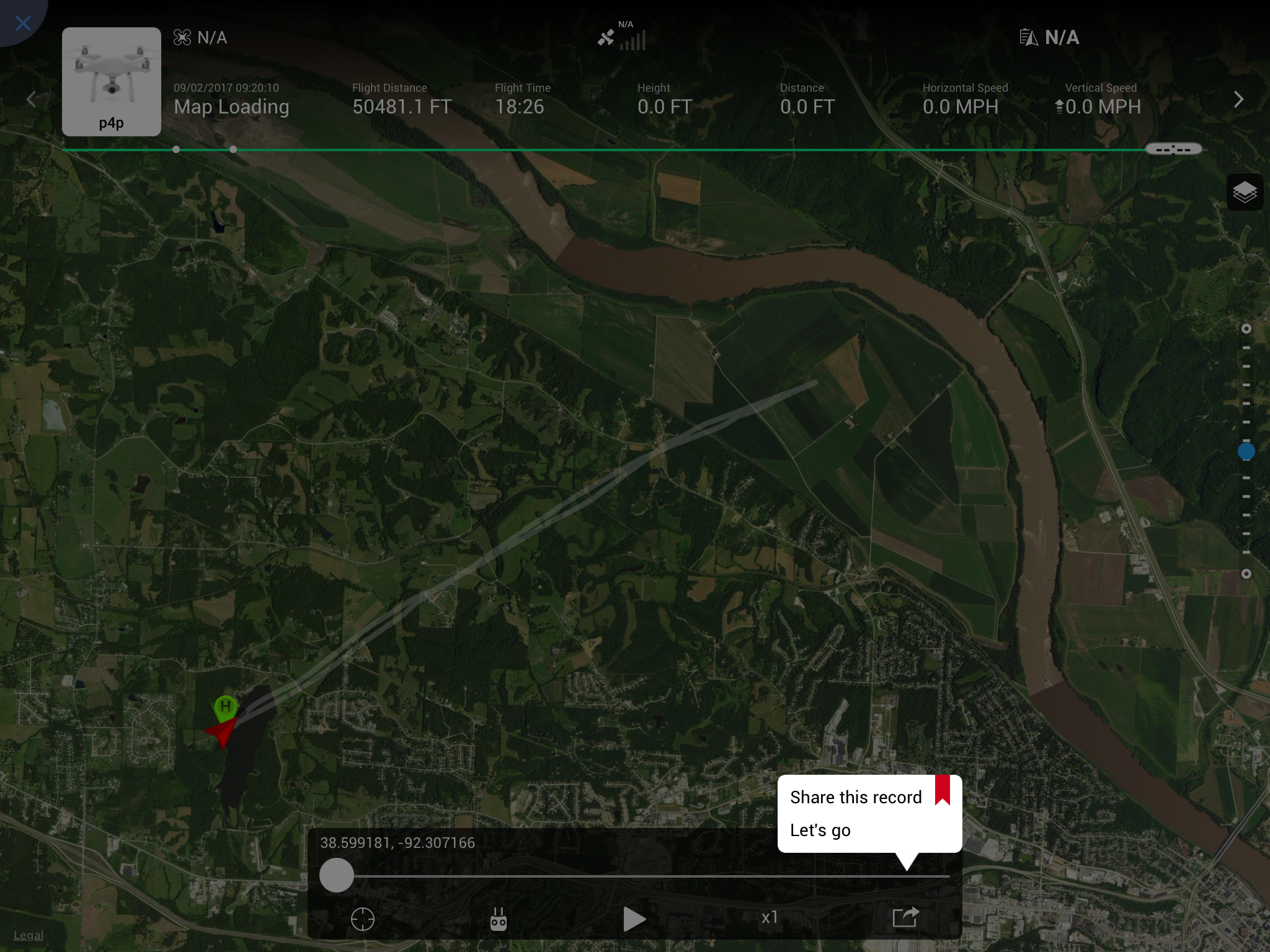

Little testing with the l-coms and p4p set to channel 21 on 2.4ghz. Landed at 7 percent. Managed to stay under 250ft till about 20,000ft. Do you guys still plan to upgrade the stock 195 out of the magnetic base? Heck even my inspire 2 can hardly make a run like that. Obviously it can but not by much more.
Little testing with the l-coms and p4p set to channel 21 on 2.4ghz. Landed at 7 percent. Managed to stay under 250ft till about 20,000ft. Do you guys still plan to upgrade the stock 195 out of the magnetic base? Heck even my inspire 2 can hardly make a run like that. Obviously it can but not by much more.View attachment 75771
I am still using the bases with the 195 also. That LMR-195 isn't very impressive looking next to the 400..
But doesn't seem to hurt the distance any.
20K was how far I ran mine out with them on also. Ran out of balls before signal...lol
Check out notifications, Not 1 video drop out :)
I do seem to get a better video link in the trees with the L Com's rt. on the amps.
Not a night and day difference though.
