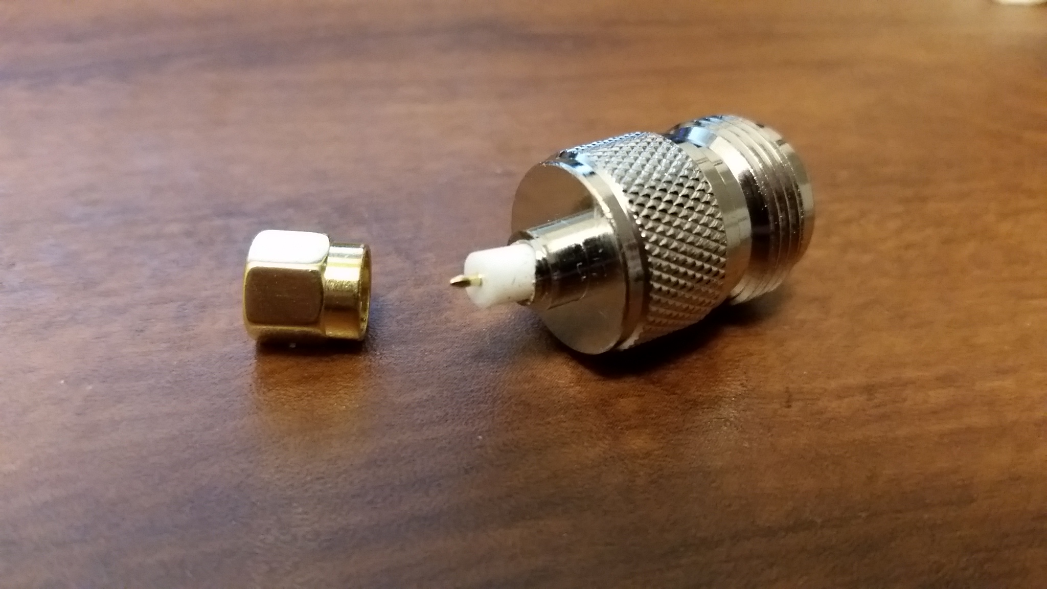

Was setting up mobile antennas on car roof for a quick fly before work. Felt resistance from one amp as I was pulling it out of back seat to place on the roof.... SNAP. The SMA to N adapter broke in half. I gotta figure out way to reinforce the antenna to amp connection. Good thing I had bought backups eh Johnny?
Reactions: JohnnyB
Was setting up mobile antennas on car roof for a quick fly before work. Felt resistance from one amp as I was pulling it out of back seat to place on the roof.... SNAP. The SMA to N adapter broke in half. I gotta figure out way to reinforce the antenna to amp connection. Good thing I had bought backups eh Johnny?View attachment 75017
Ordered 2 of those.. came in yesterday. Just ordered 2 more. :)

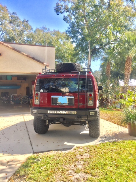

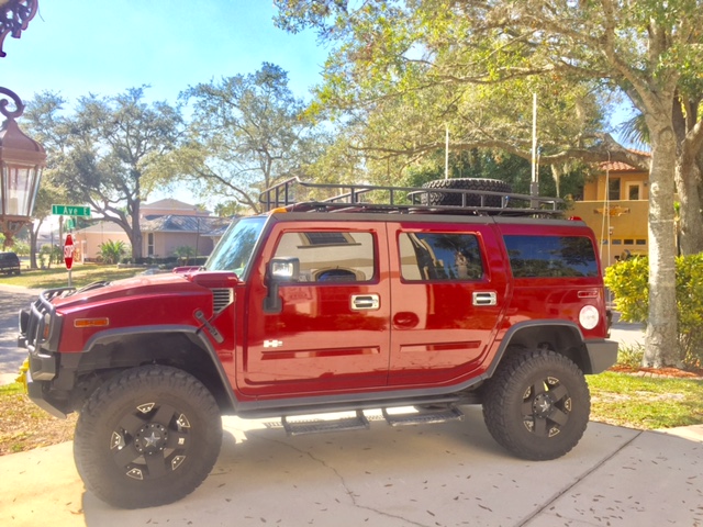

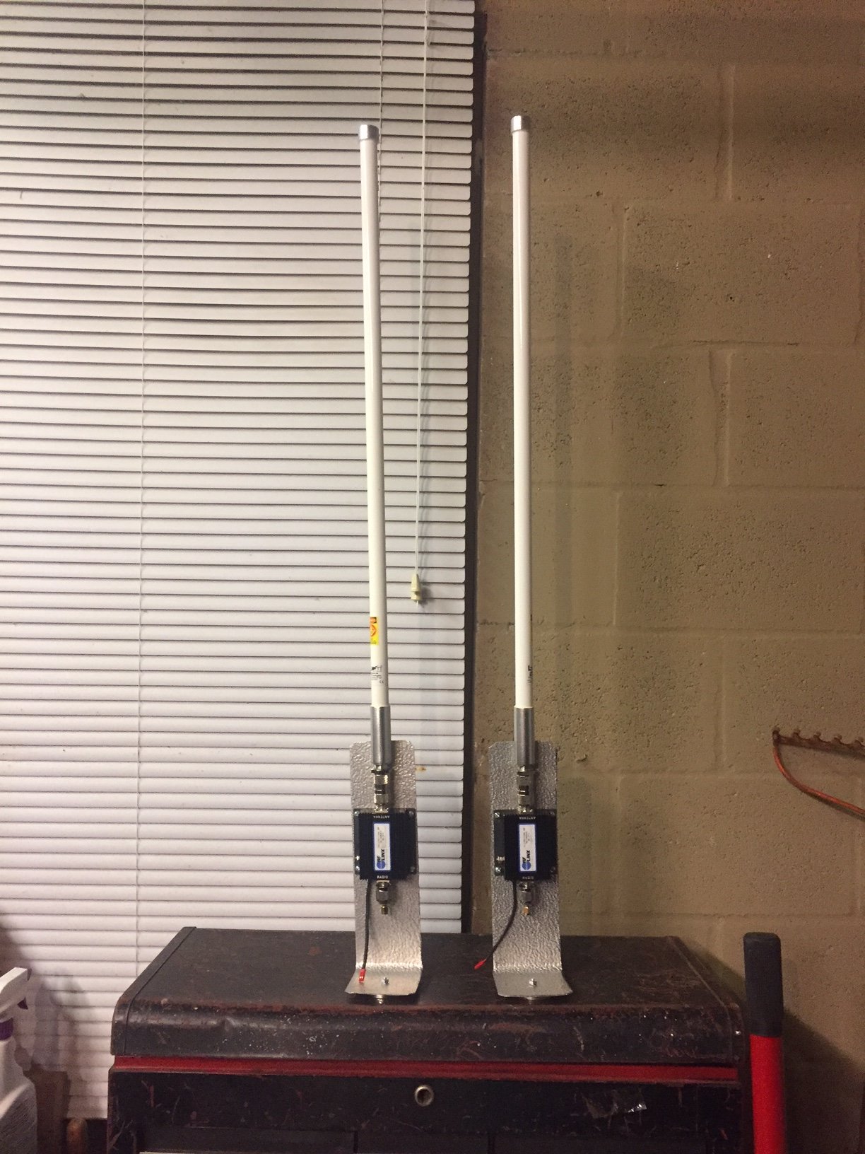

These L coms were bigger and heavier than I anticipated. Ordered 100lb holding 3" round magnets needed to support aluminum bracket, amp and antennae. N male / N male connector for antennae to amp, RPSMA to N male to connect amp to cable routed into truck. External power hack completed for amps. Power supply will be 110v to 12vdc 6amp with noise filter plugged into car inverter and routed to amps, plugged into pigtail with JR connector. Easy disconnect and relocate for all components, LMR 400 cables will stay with vehicle.

These L coms were bigger and heavier than I anticipated. Ordered 100lb holding 3" round magnets needed to support aluminum bracket, amp and antennae. N male / N male connector for antennae to amp, RPSMA to N male to connect amp to cable routed into truck. External power hack completed for amps. Power supply will be 110v to 12vdc 6amp with noise filter plugged into car inverter and routed to amps, plugged into pigtail with JR connector. Easy disconnect and relocate for all components, LMR 400 cables will stay with vehicle. View attachment 75162
Nice!! Let us know how it work's out...
Turbo
First test flight this morning, unfortunately a lot of fog so could only go out to just under 10000' away at 250' elevation over some farm land before losing video feed. Surprised by the amount of moisture on the camera/gimbal and bird when I brought it home! I will wait for better conditions before I rush to judgement. Still, very nice to sit in the car drinking coffee with my cinemizers on and this is farthest that I have been able to go with the P3A. Obstacle penetration seems very good and that's what I want it for, not distance. Made my buddy stand outside and spot for me, he was not so happy since it was a 18min flight! He's used to controlling the camera/gimbal on the inspire.:laughing:
