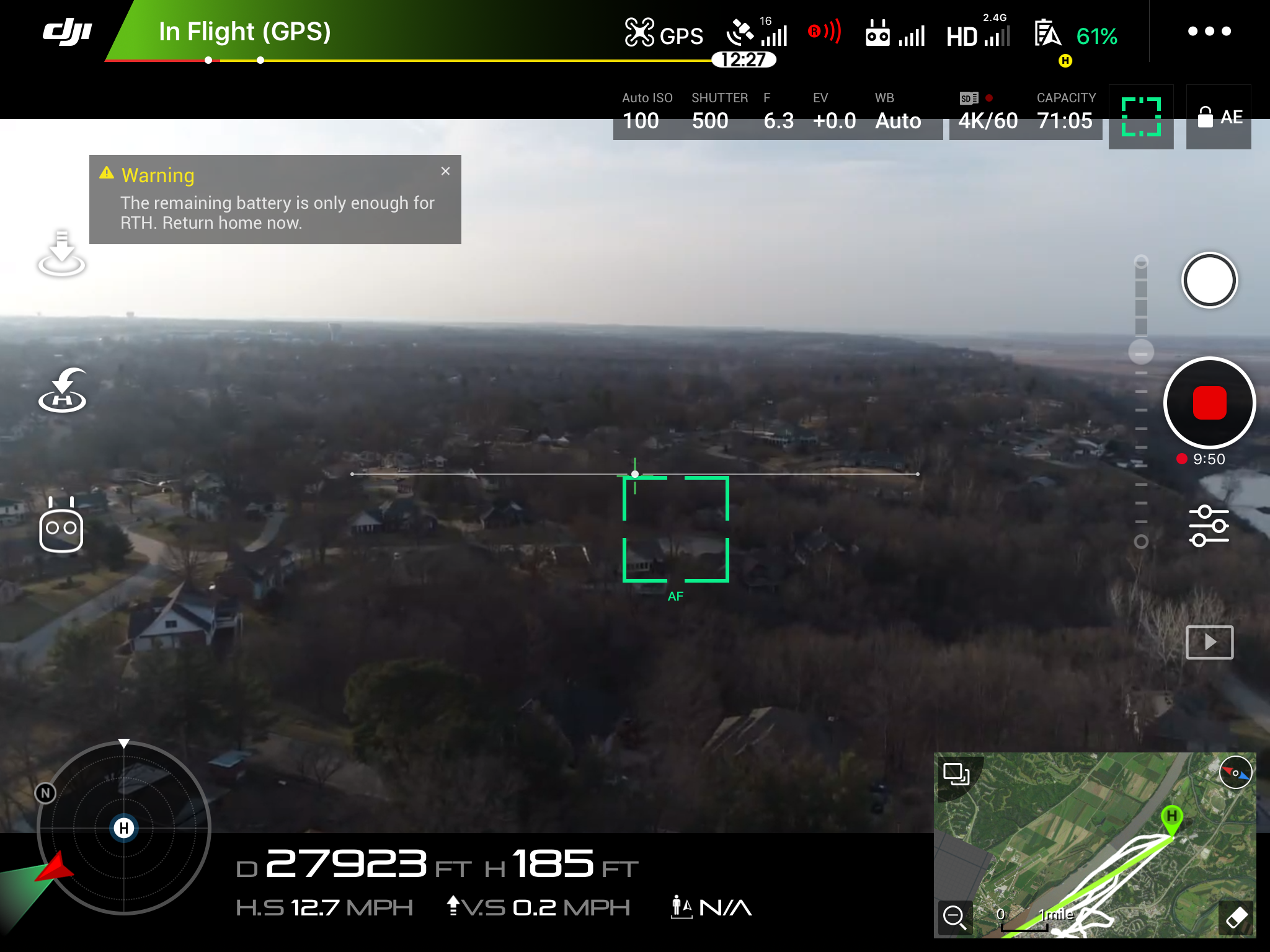

Well I finally found time for a little L-com flight today.
And I found birds on the way back Jeremiah lol
Dropped down behind trees to get the pic.. pretty awesome!
My RTH kicked in just after 15,000' because of battery. Flying against a pretty strong wind. Should've got a longer flight time but hey, I'll take it!

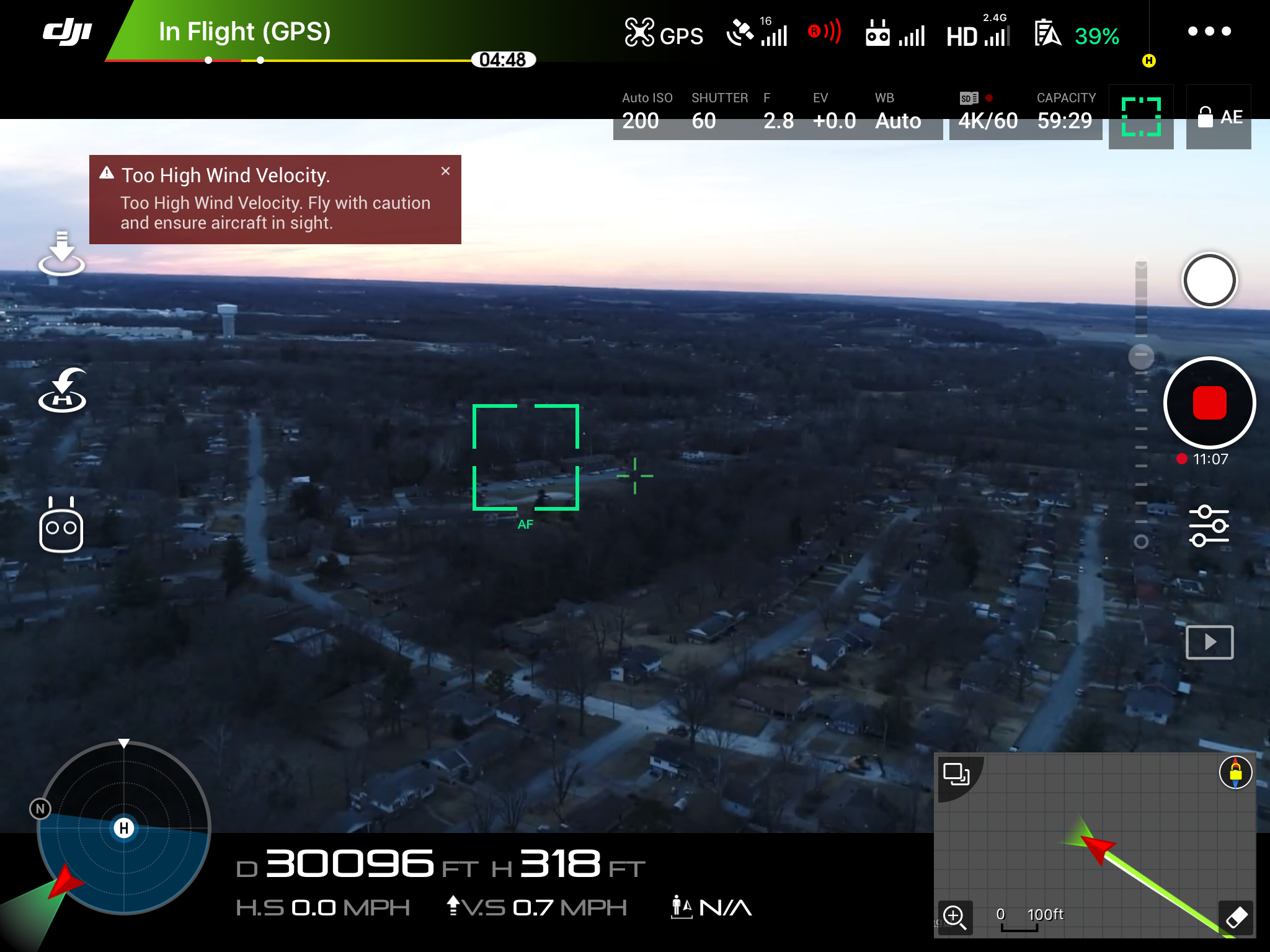

View attachment 75983 Nice flight! Freaking birds are everywhere! Been messing with the P4P and l coms all day. This p4p will hit 30,000. So close. Stayed at 133ft till the last few thousand feet. Signal was solid entire flight till I stopped for this screen shot.View attachment 75982View attachment 75982 View attachment 75982
There's the nice flight! My flight I had to keep climbing because the ground elevation was rising throughout the flight. I know I could've went on but the battery.. seems to kick in early. Not because of signal either. Oh well, still fun as heck!!

View attachment 76145 This is my last p4p distance run. I didn't think I would make it back I did and hit that 30,000ft.
Awesome dude! I guess I'm gonna have to do a battery mod or something. All my antennas way outlast my battery. Would I be better off just to send it to Jake for the mod or is it something that a person that can mod their remote can do?

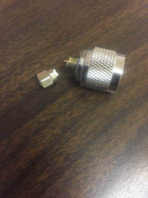

Well a bad "n male to rpsma male adapter" got me this weekend with the inspire 1 test. Only got out to 7000' in optimal conditions before signal lost. Checking the connector I found the problem. Same distance with the P3A.......Beware the quality of connections........

Well a bad "n male to rpsma male adapter" got me this weekend with the inspire 1 test. Only got out to 7000' in optimal conditions before signal lost. Checking the connector I found the problem. Same distance with the P3A.......Beware the quality of connections........View attachment 76236
Same thing happened to Grammaton. Same connector too. After his broke.. I bought extras. Thanks for heads up.
Thanks for sharing! I hate adapters... but it get expensive having a cable for every set up.
