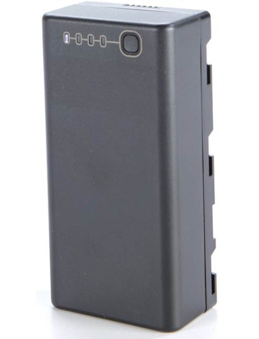

Because of other commitments, I have not used my P4ProV2 in a couple of years. I did periodically charge the Drone batteries and the control console, but not the CrystalSky batteries. It looks like I will need to replace those batteries, because they give no indication when I press the press-to-test button, and when I try to charge them, the charging indicator turns red.

Not sure if they are used elsewhere, but I attached a pic of one.

"OP is talking about batteries for the DJI Crystal Sky monitor."
Now I know, why I didn't Know, no way. :rolleyes:
