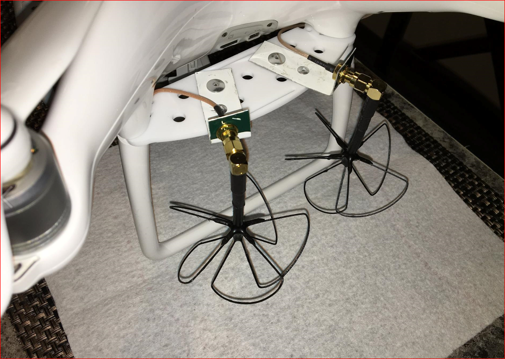

I later changed it to have the antennas point down.
Well dirt, I can see why it cuts thru trees like a chainsaw. Very interesting video. So what made you end up turning them down? And, did it help? This mod looks a little complicated, but I do believe I could do it. You done well explaining, but you sound different than I imagined..lol I was hearing this gritty voice with the name dirt. Guess that came from the crash vids throwing a little dirt. [emoji16]
I'm a dirtbike rider at heart. Been playing on them in the dirt for 45 years but as you can imagine, I'm slowing down. Can't ride it like I used to but I can fly it!
At the extremes of my range I was loosing signal when I turned the drone. Pointing them down seems to have eliminated that. It was just trial and error until I hit on the most reliable signal.
The job wasn't really all that bad. It took some time to be sure but that's because I was super careful. It's not something you would want to start at the kitchen table after work thinking you'll be done in time to eat. I do think anyone with a half decent mechanical skill and the right tools could do it. Good drone shops charge around $250 for the install so even seasoned people don't do it real fast. The biggest drawback is simply that mistakes cost money. No mistakes=no problems and it was a fun little project.

This is what I ended up with
I like this better than other pics I've seen where they drilled holes and they stuck down near the camera. Seems the bit of extra distance apart would help too. I like it.

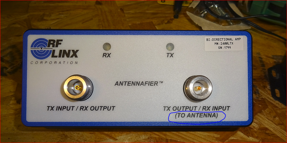

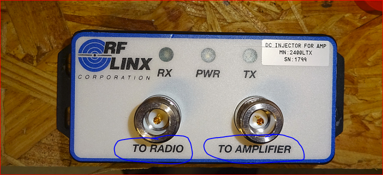

Git the amps today. Just got home and opened the boxes, all looks good.
I've seen the pics that were posted here and really didn't see how the cables were hooked from the antenna to the amp. So my question, does one antenna hook to TX input, and the other the RX input? I looked online for answers but no luck.
Sent from my XT1585 using PhantomPilots mobile app
Did you get the Rf linx DC injected set? If so, and you got 2 sets, antenna>short cable>lightning arrestor>amp terminal that says antenna>long cable down>DC injector>short thin cable>RC. Both will be exactor the same. And of course hook the power supply to the injector.
Yep, that's what I have and thanks for the reply. I should've looked a little closer. Pretty self-explanatory.
