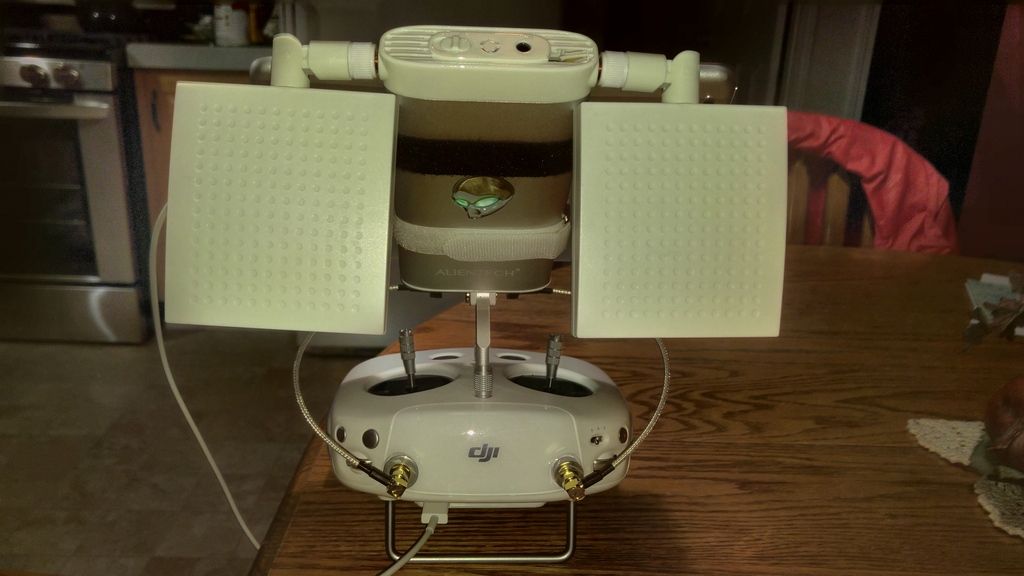

This came in the mail yesterday. Am going to try this Amp on my car/boat set up for www.fstop-labs.com
Same L Com Omni's, but on Magnetic bases with 10' of LMR-195 to the amp. Battery is built in.
Turbo
Mounted it on the RC just for the heck of it, put cheesy antenna's on upside down just because I could :mask:
My thought was to just attach the antenna cables from the Omni's to the amp there.
Not sure I like it mounted there.
Yeah... Uhhmm... Good luck? Lol
Pretty cool for a free test though. I've heard of cutting the cheese, but not testing the cheese. [emoji15] lol
I agree, an under the remote mount would probably have a better feel.

My Alien Head Amp looks much better with the Omni's hooked to it. I would love to see how it works, but have a shortage of props :tearsofjoy: I am thinking prop guards for off roading :)
