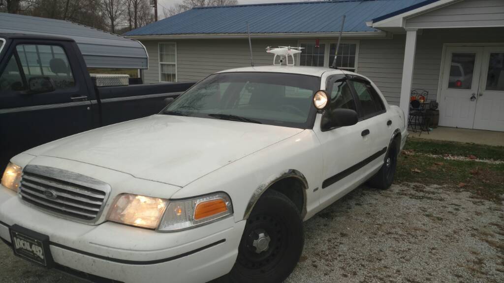

Flying from inside house or car anyone?

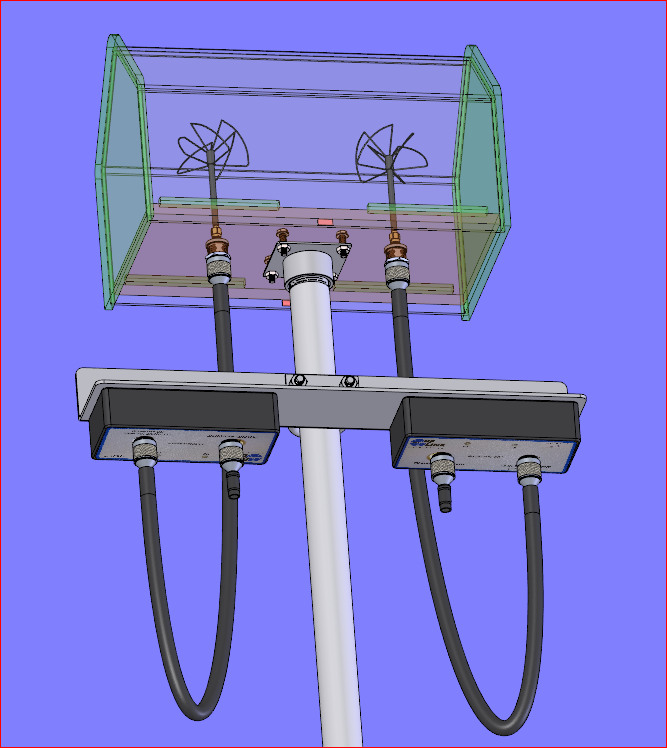

this is what my system will look like.
Nice !!! With the on bird amp you will be able to dial back the Receive Gain and get nice video.

That sir, is gonna be tuff!! Pretty creative I must say. Can't wait for the first vid!
I sure hope so. Those antennas are exactly matched to the ones on the bird too. Great distance isn't all that important to me but great signal through the trees is. I will probably end up with both but the higher dB sticks or panels will certainly out reach my setup. I should be able to fly under the brush a little better though. I have high hopes.
