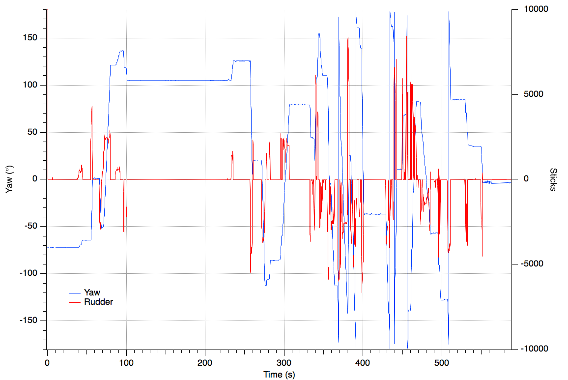

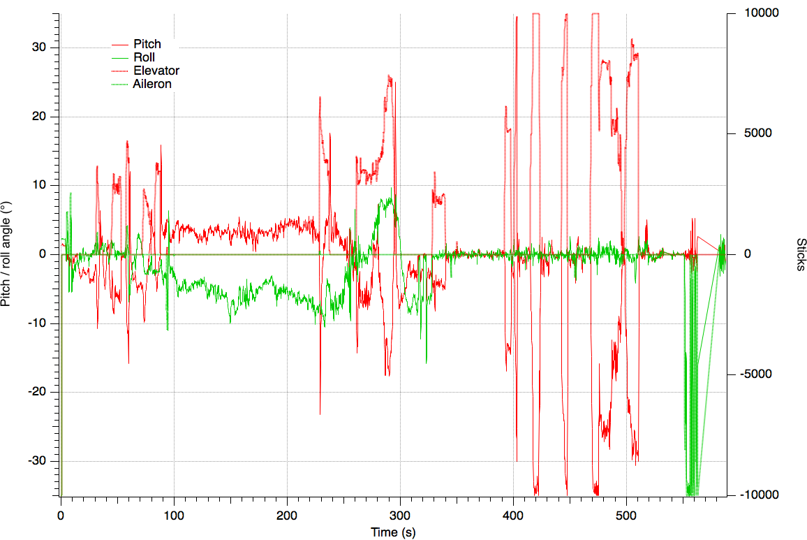

According to your flight log, you were still communicating with the aircraft. You can see the stick movements in the flight log during the period of time when the current position was not being updated.
Yes - control was good. Unfortunately the control inputs were complex and rather random, and so it is going to be difficult to predict the flight path. Definitely need the DAT file.
