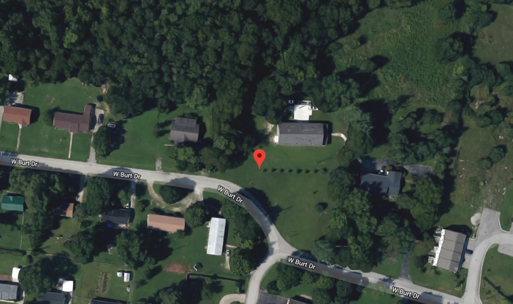

Your flight log shows your Phantom auto landed at 35.65269915, -87.01612198.
Me, my father and my niece have searched that area over 10 times...its definitely not there :(
But it also shows it at over 200' still at that point...maybe the wind took it? You can clearly see where it put itself into ATTI mode
Last known Direction it was facing was this way as well. Could it have possibly landed in that direction? I've been back in the woods several times looking and haven't found it back there but... could it be a possibility?

Standby for some estimated drift calculations. Also - if you can retrieve the DAT file from the mobile device it may be possible to use the inertial data to reconstruct the flight path up to disconnect, which would narrow the search area somewhat.
Reactions: Kissthesky
That's correct, but the aircraft had been in ATTI mode for over 4 minutes at that time with no position updates
That's also correct and quite odd.
