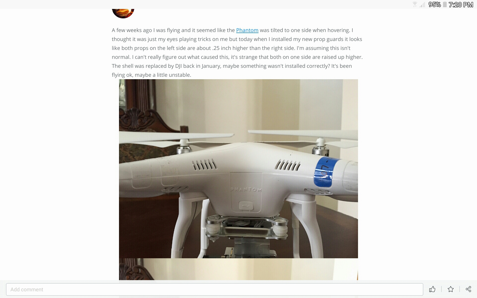

Also even if props are new do you have another set to try,sometimes when prop turns the blade tips can be uneven which could cause this intermittent shake,I see if I can find picture to be explain
This pic show uneven so check cause it does happen,,I'm sure my p4 had this aswell
