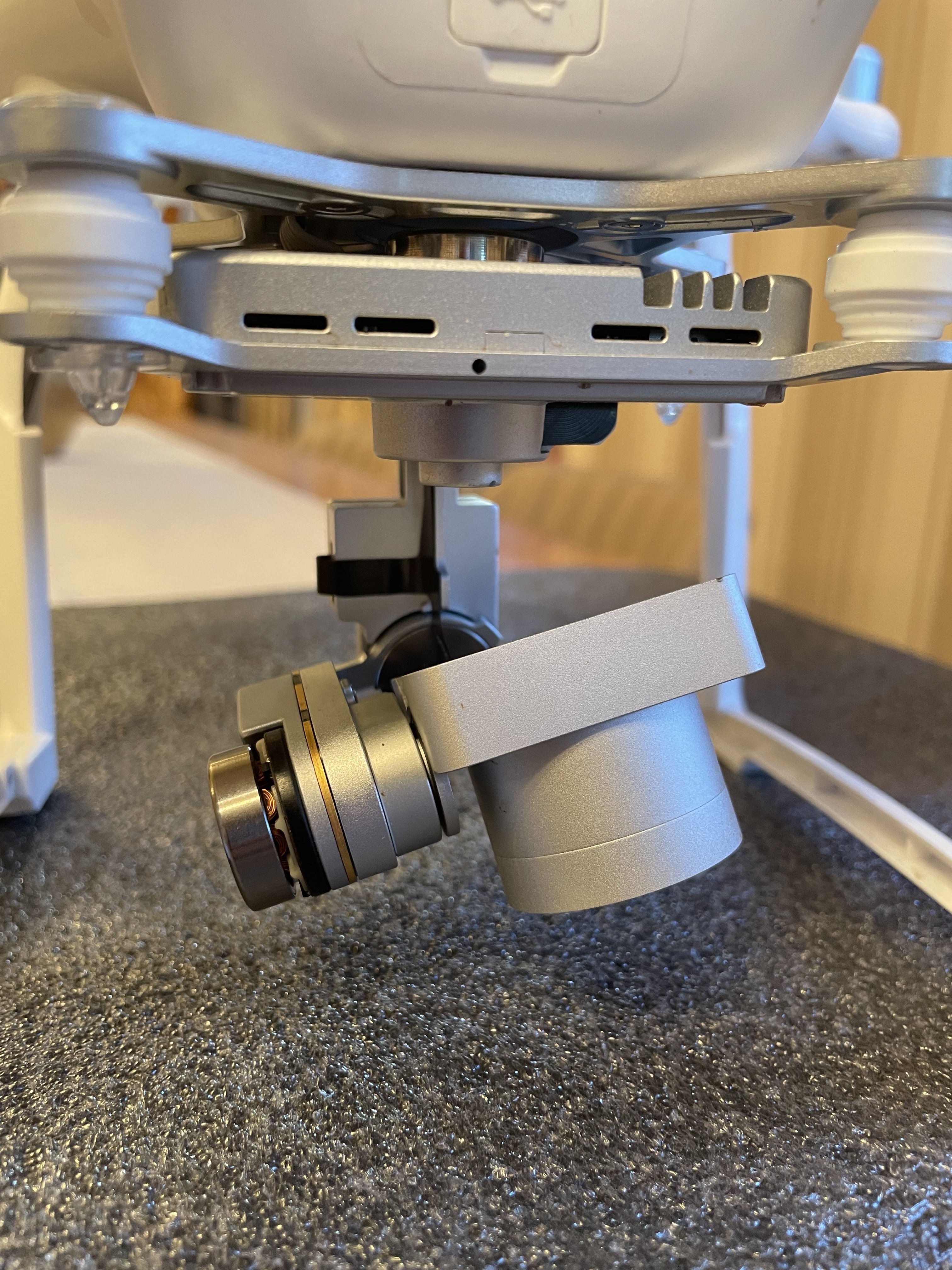

I have replaced the dampers, and the props are just fine. I start to believe the problem might be with the gimbal. Thing is, the gimbal doesn't make any weird noise or movements when i turn on the drone, nor i have noticed any component to be out of place (i have also took the gimbal apart yesterday).
I'm no expert at drones, so a clue on what part of the gimbal could cause this issues would help :)

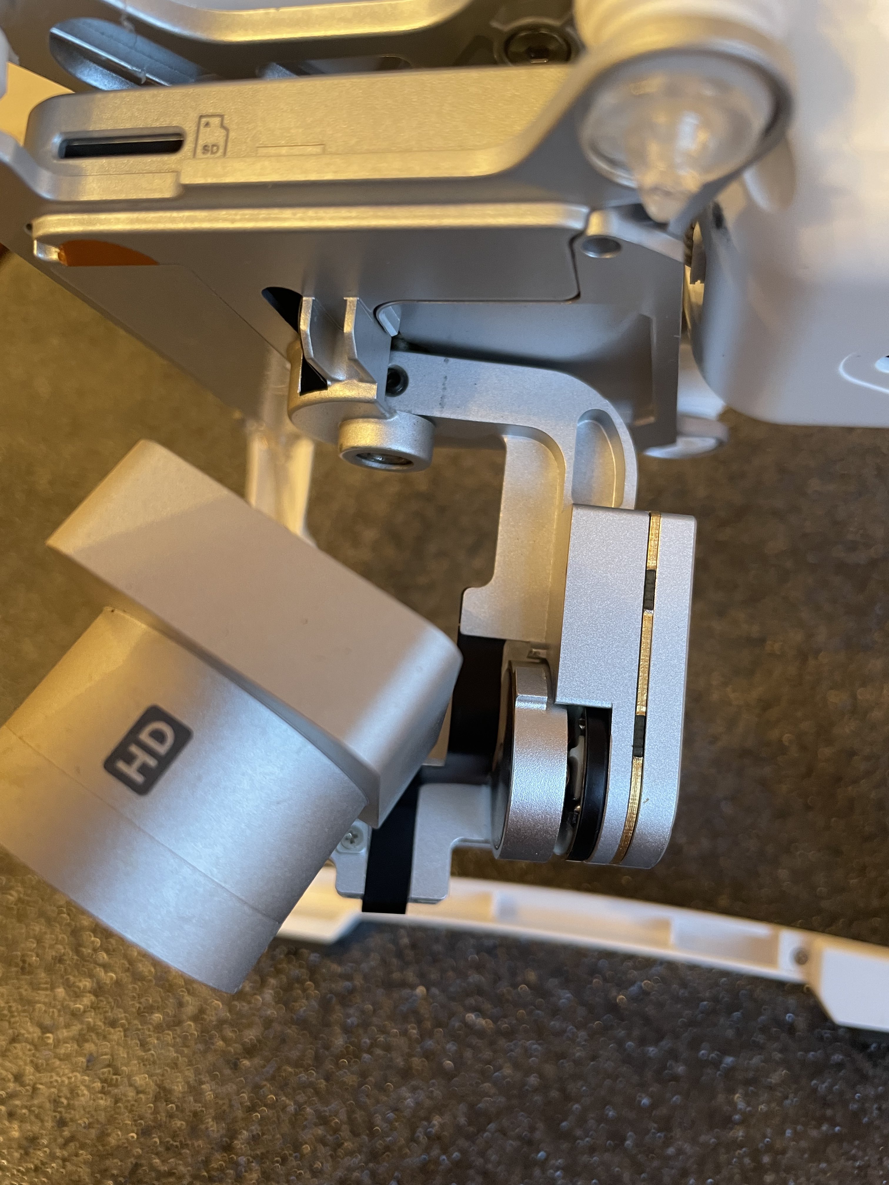

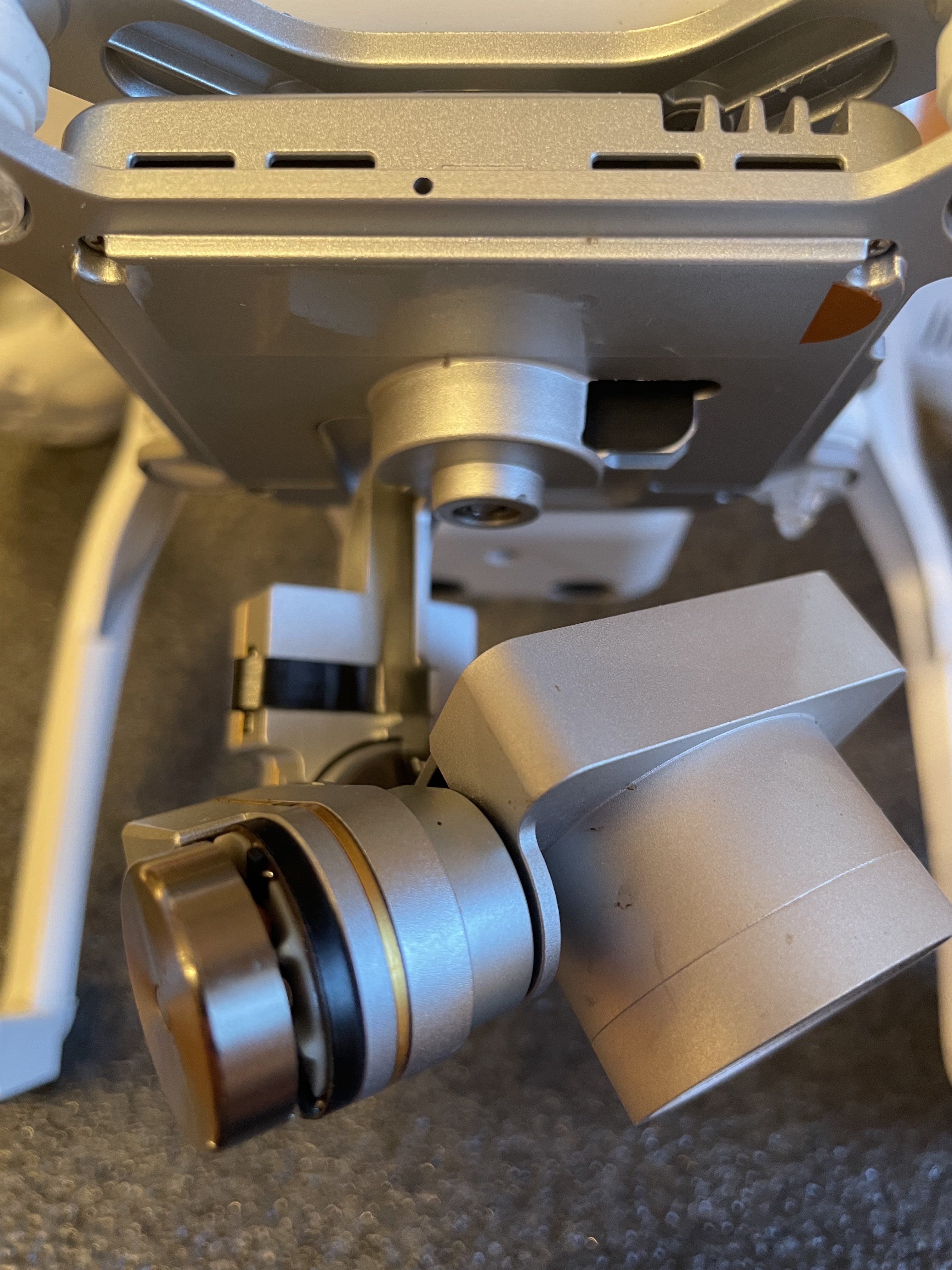

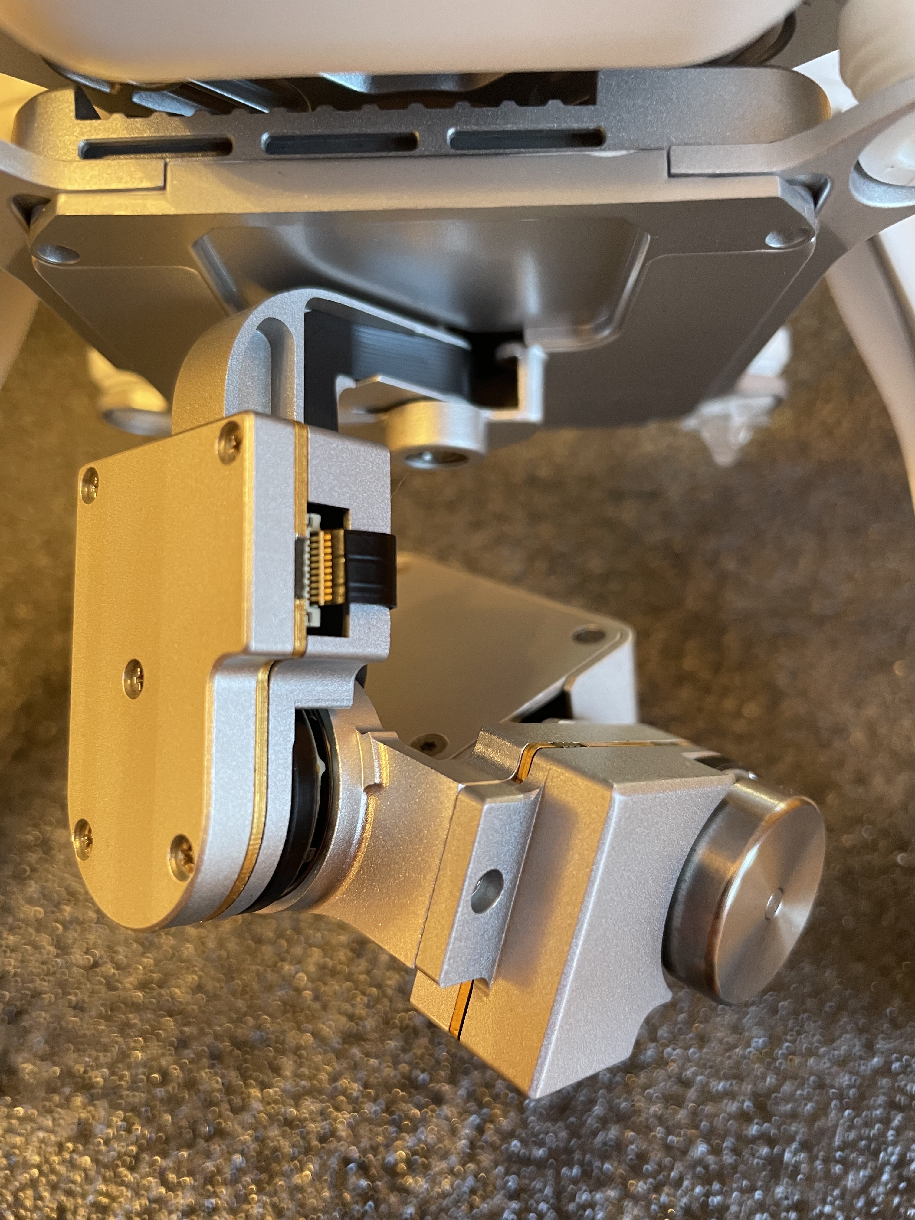

On second thought, I was thinking the opposite, meaning that something could be a bit loose.
I have also attached a few photos of the gimbal.

By the looks of the footage, its in the motor at the back of the gimbal. I think I would take the back cover off and see if I could see anything amiss in there... Has it been involved in a crash or anything? Or just started happening?
