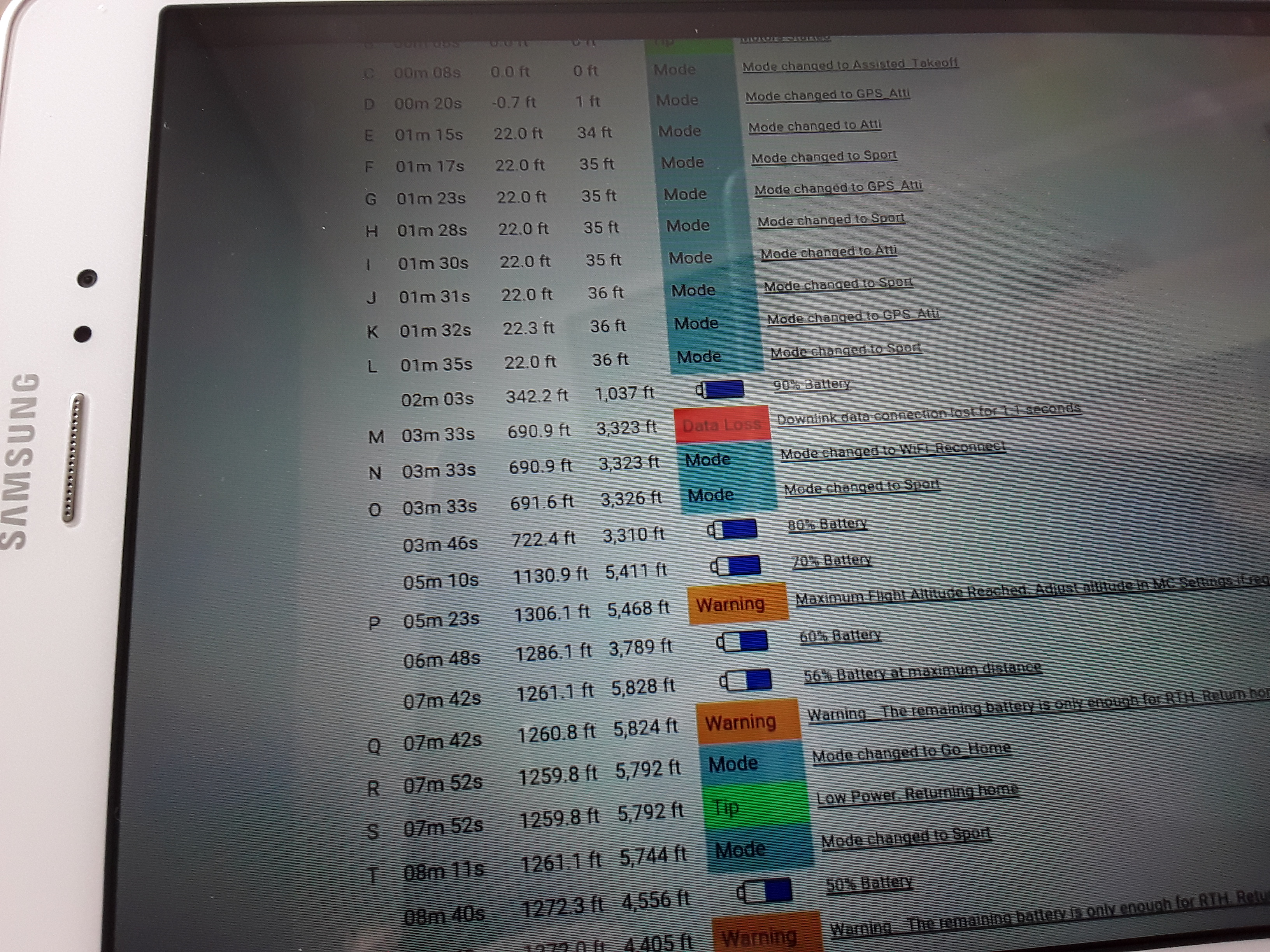

View attachment 81638 this flight here things start to go odd,,,notice it changeING modes,,,,battery warning,,rth because flat batterie but landed with 30%,,,,

I'm on 30%warning and 10%critical,,,,,,do you notice all the changes in flight ,,,only engaged sport mode once I think when I was ready to go,,I think 36ft I change,only time I touch switch till I come in to land,,,,yes no flag comes up

Actually had a closer look at the other mode changes and apart from the low battery RTH which is automatic if you don't cancel it, it looks like you are switching in between modes. I have noticed in the Airdata logs that I check that I have seen similar changes in flight which I haven't initiated. Be interesting to see what that flight looks like in the phantom view log that many use on this forum, wouldn't be surprised if it is different to the Airdata info.

Wow I look at that when I home,,Yeh it looks like it preselecting my flight mode for me,,,I think this where me trouble with sport mode started?????and I is hanging to fly:)just redone my stick calibration,,,,got a help somewhere,,,

Yeh that rth I couldn't cancel,,was pressing cross on me screen to cancel and head back anyway but it keeps initiating,,stopped rth very close to hp
