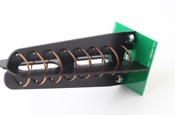

So what does the inside of dbs antennas look like and are either of these dbs or fpvlr made to handle amps or is amps a bad idea and should I just do a bird side antenna upgrade? If bird side how does the standard bird side antennas work and what would be best cost effective way to do it?
Basically it uses antennas similiar to the wi-fi antennas on the standard or vision plus

anyone ever took apart a DBS panel? wondering what's in side. What are you getting and is there a better panel?
I have seen one in here and looked the other day but couldn't find it . Think it was in P2V+ antenna mods .
Has 3 panels in it .1-5.8 and 2-2.4's .

For the money I like the itelite and if you want more than what range you get with just that then I would add the birdsides .
Or try the FPVLR .

When you buy the dbs mod you get a YouTube tutorial link with it . I recommend that you install your antenna underneath . When you open your controller to do the mod . Undo your top bracket and turn it upside down this gives you good room if you have a mount for what ever tablet you have . The reason I mount under is most if not all Areias are directional so if your drone is up 1000 ft but your pointing your antenna forward then !!! Loss of signal . Hope the postures help in what I mean

I think cables on these are gonna make a big difference in performance. Think i'm gonna try dbs, but going to use very high quality cables inside the controller and outside.
Reactions: dirkclod
I did try the ones that came with the panel then changed them and did see a difference with mine . It just makes sense to use the best cables you can IMO . I think you will be pleased with what you see whichever way you go but them cables are like your blood vessels .

Yea i'm just thinking about how "noisy" it must be inside the radio controller, you got processor(s), power, power regulation, all inside then 3 antenna wires with their own set of issues and emi, good quality shielded cables is going to be a must to get "max" performance, just guessing here with my knowledge from the "marker" world... Can't wait to try it out
