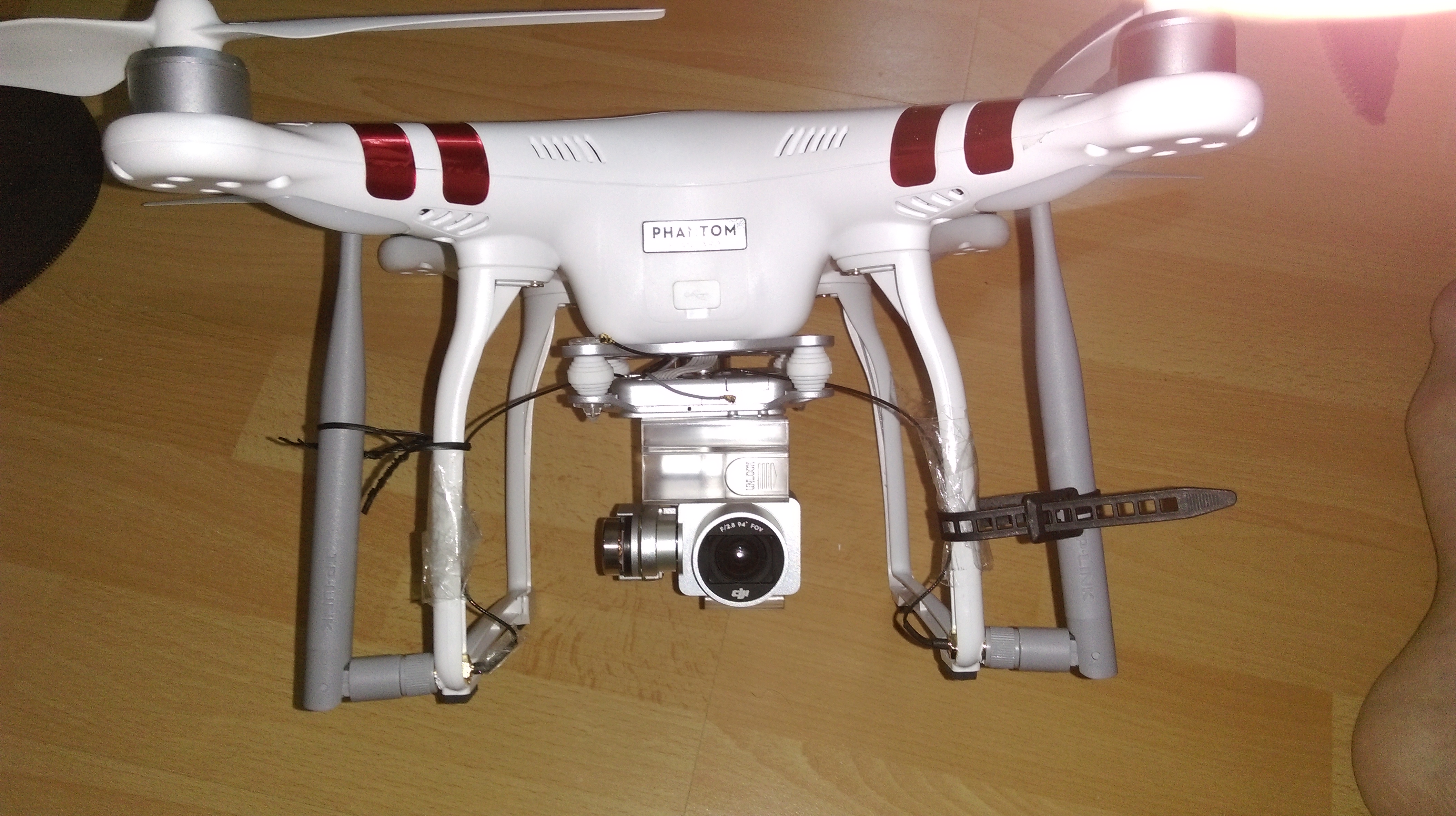

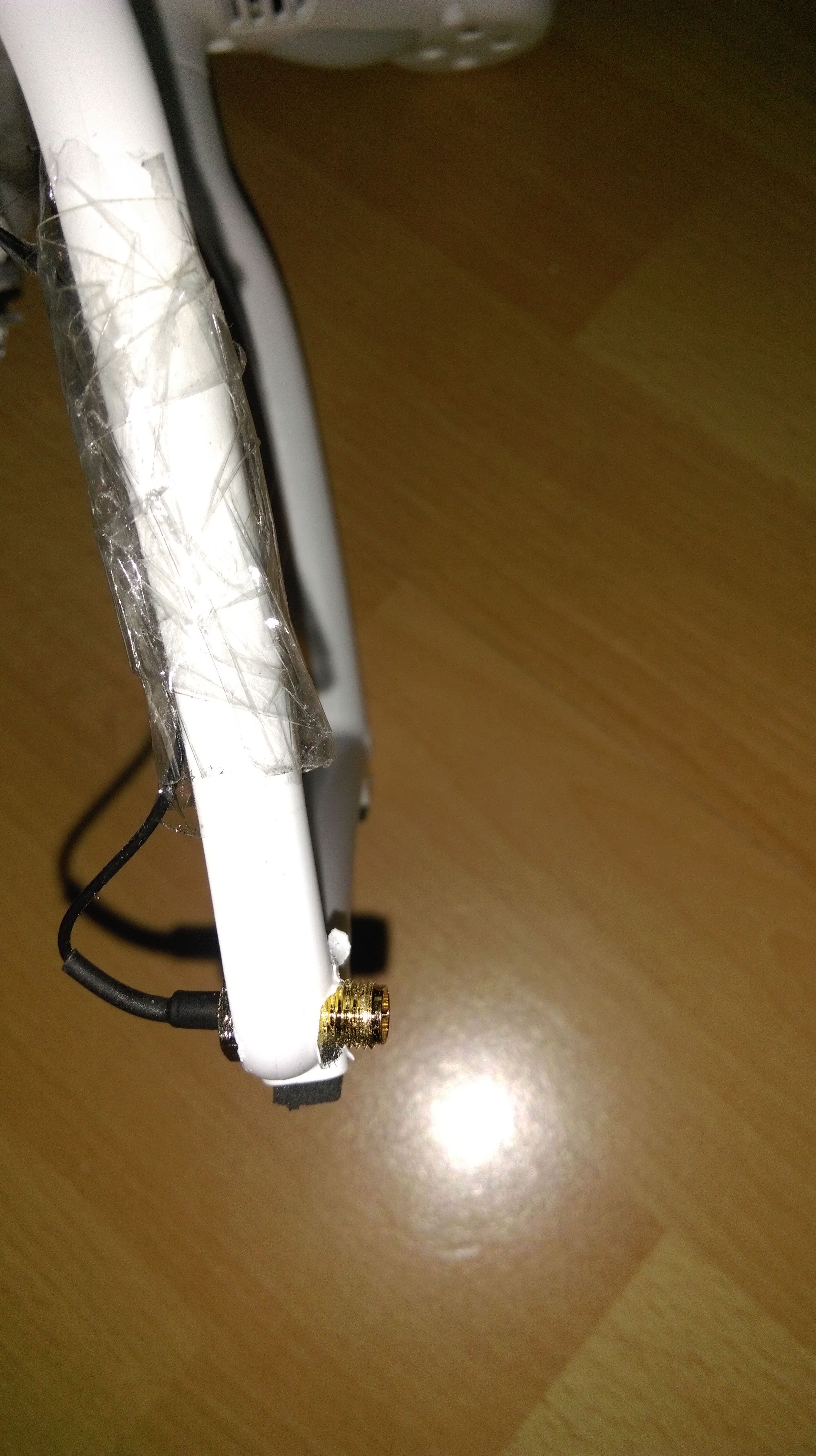

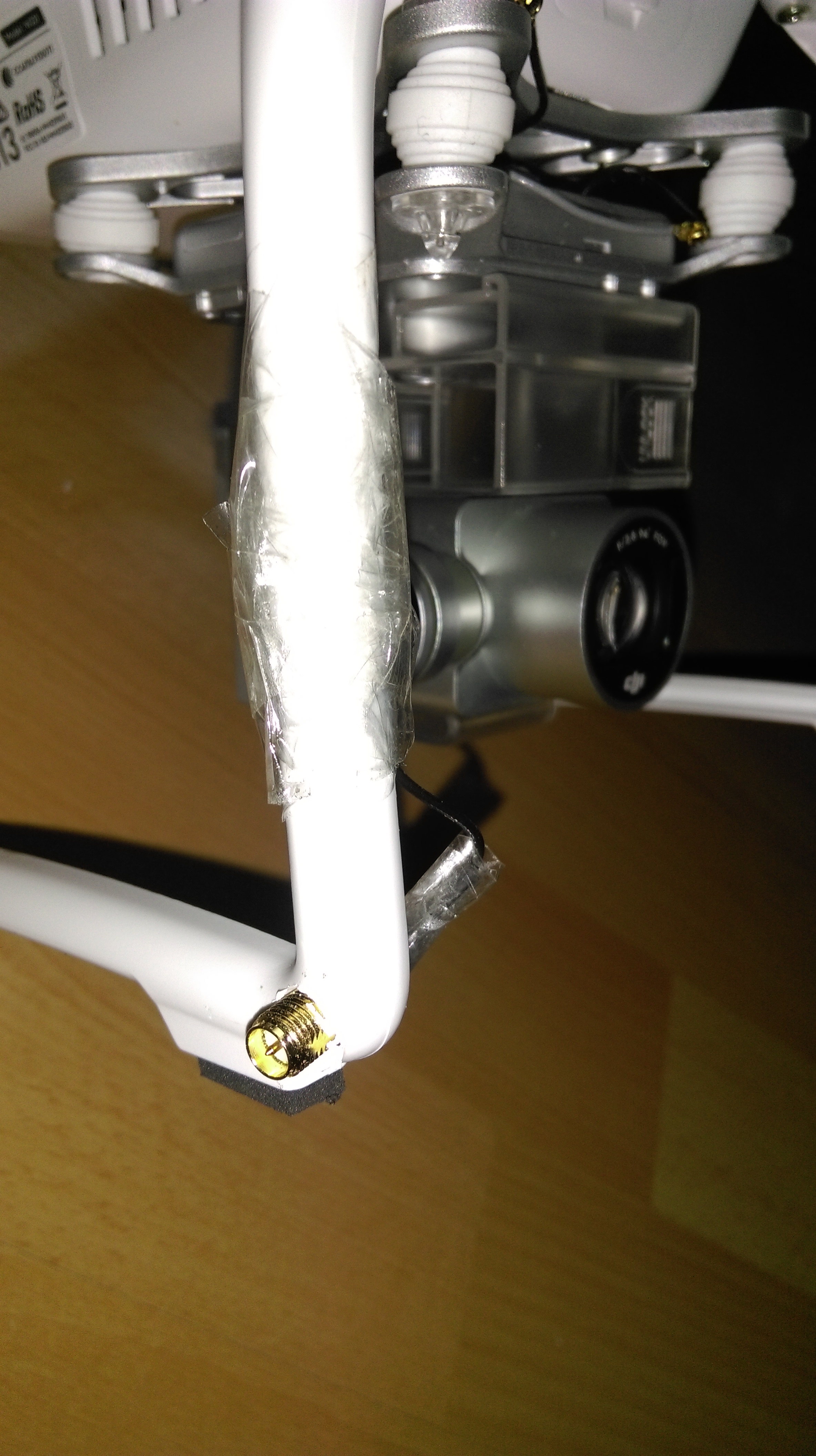

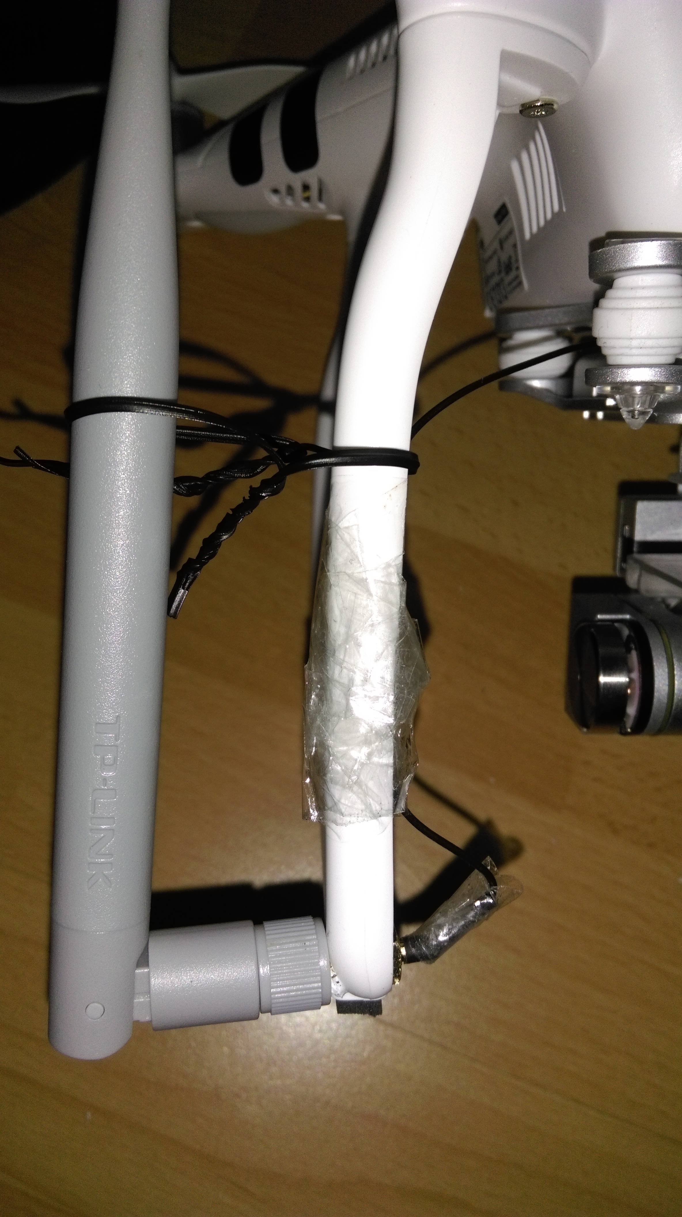

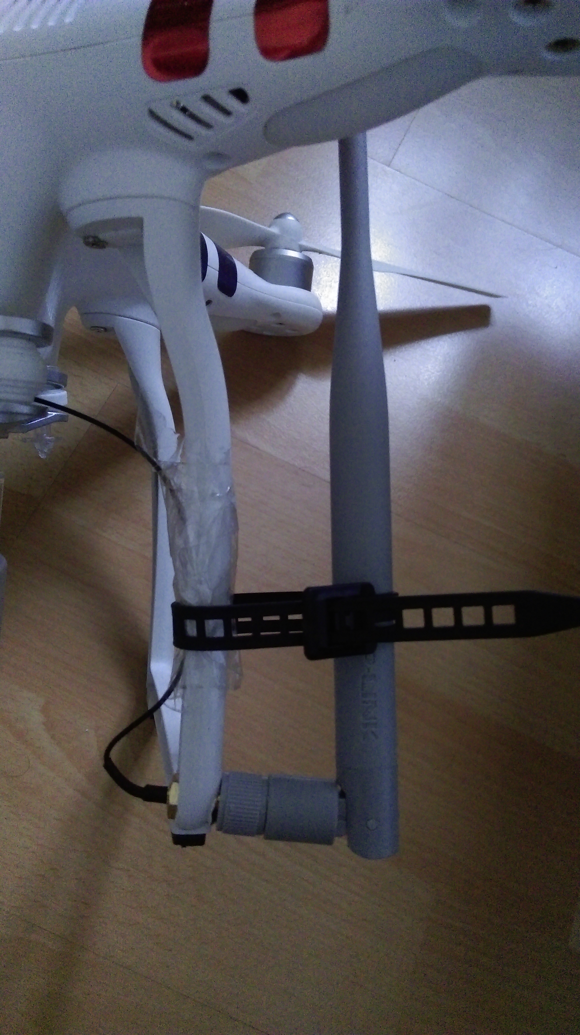

I also installed DBS-Mod and got over 2km, which is about 1,3miles distance. To make the connection more stable, I made this (look at the picture) IMAG0092.jpg IMAG0097.jpg IMAG0096.jpg IMAG0095.jpg
I did not fly it yet as the weather here did not allow to fly :D
I used the two 5dbi omni-antennas from the tp link wa830re range extender.
Why I did this: I had in the past a crash due to my brother, he crashed into the tree. I repaired the shell but sometimes I could not go further than 50m. I checked the internal antennas for 2.4ghz. I saw a little crack on the antenna with black cable on it. As I do not have enough money for the antennas ( I am 18 years old student) I decided to bring the antenna connection out. I had 2x u.fl to RP-Sma cable. So I drilled two holes on the landing gear. Tehn I started the drone and there is: the video is working, so the antennas works.
When the weather allows I will do a range test

I also installed DBS-Mod and got over 2km, which is about 1,3miles distance. To make the connection more stable, I made this (look at the picture)View attachment 46429 View attachment 46432 View attachment 46431 View attachment 46430
View attachment 46433 I did not fly it yet as the weather here did not allow to fly :D
Nice idea!
Be sure to let us know how it works :)
