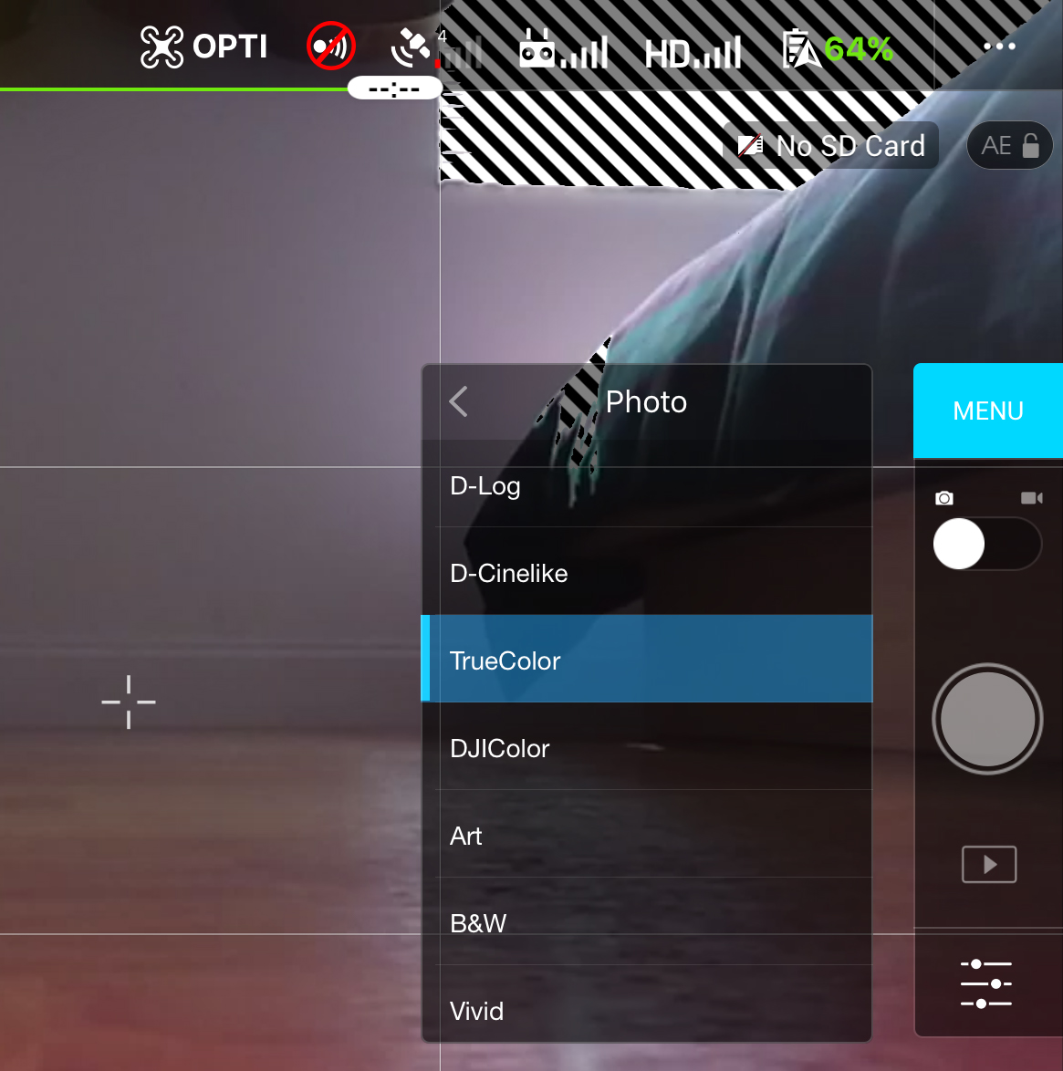

What app version are you using, and on what device ?
well.."none" is not longer there...it seems they changed it to DJICOLOR instead...I just learned
Very interesting.
I wonder if its a rose by any other name or if TrueColor is somehow treated differently than "none".
I am wondering if maybe they made their own algorithm that controls gamma a little but is not D-Log because they can't fix the issue a lot are having with D-Log.
Hi Guys, this is a very interesting and informative thread ! Are there anymore views/info on the TrueColor and Art settings ? Definitely the last time I tried D-Log it was just unusable, total mush in the lower mid-tones like the op illustrated.
