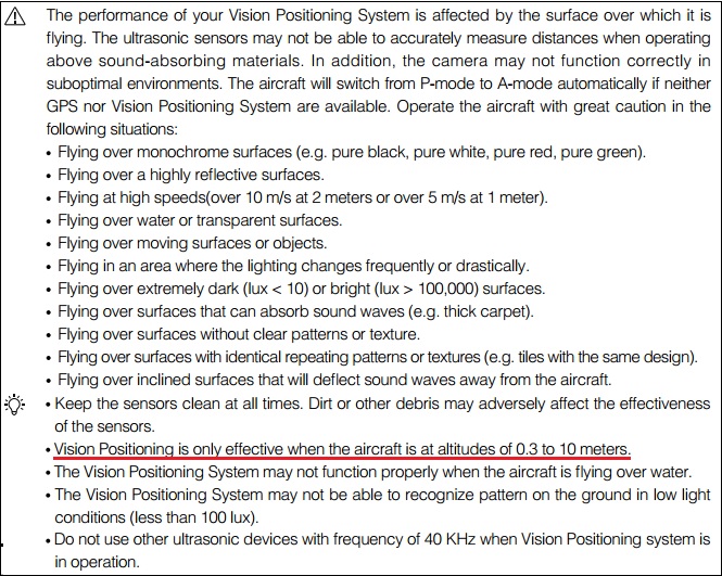

I seem to remember reading somewhere it doesn't work above 3m?
Per the P4 manual:

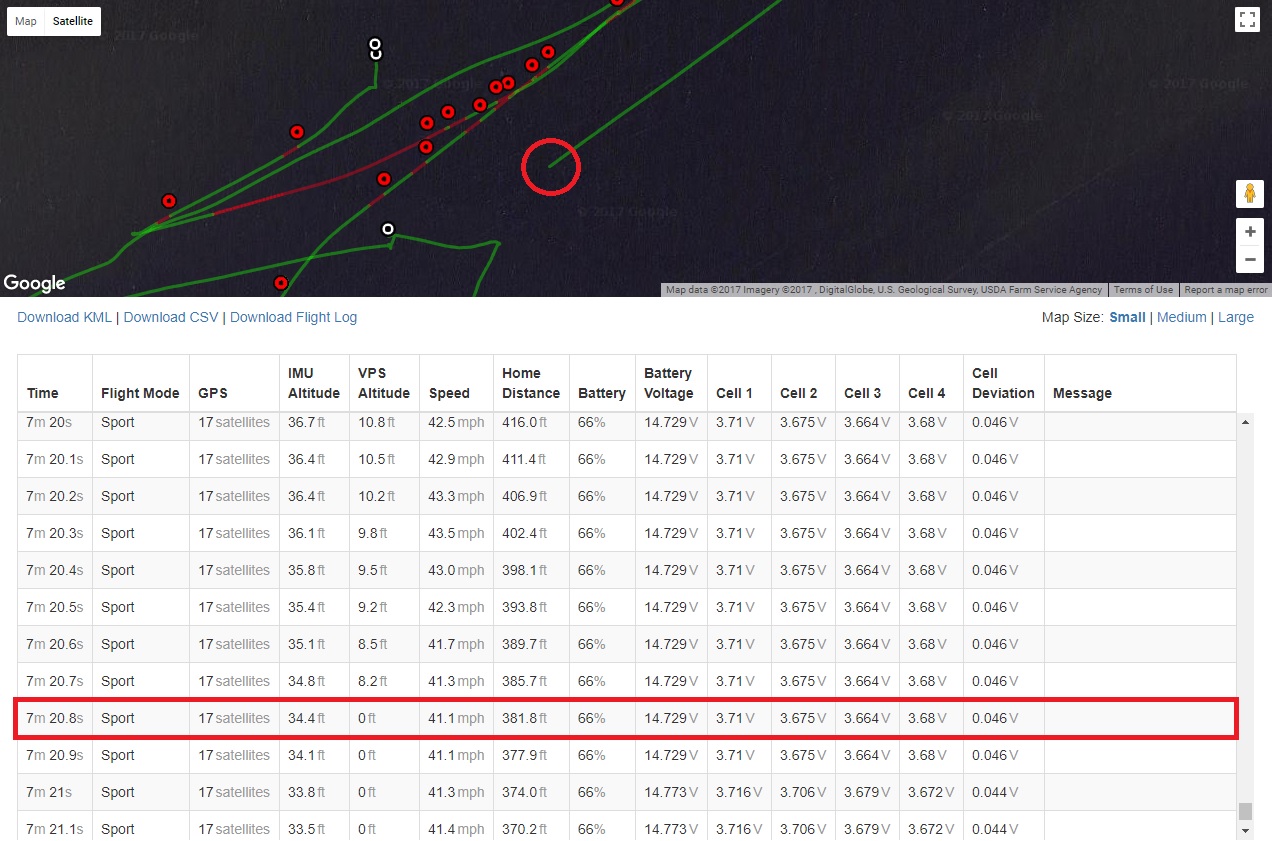

DJI is still reviewing the data. Clearly if they find malfunction, it will be a 100% coupon code. If they find pilot error, what do they do typically?
I'm a bit late taking a look at this, but I have a couple of observations:
Firstly, the data show no sign of impact with the water. All the sensors are consistent with forward, slightly descending flight, right up to the end of the record.
Secondly, the late discontinuity in the VPS altitude 2 seconds before the end of the record is unphysical and does not represent impact - the other sensors continue to report undisturbed flight.
That suggests two possibilities: (1) it was flown into the water and the impact disabled/ejected the battery within 0.1 seconds and prevented any data of the impact being transmitted or (2) the battery failed/disconnected in mid-flight and it just fell into the water. The latter is consistent with the description of the event, but probably so is the former given the speed of the aircraft.

Here is the video flight log showing controls. I had line of sight. The VPS is more accurate on the log than in this video, it shows I was 29ft when it went down which is clearly not true:

I was flying last Thursday following a boat (over water). Got the video I wanted and put it in Sport mode to return home as I was 2000 ft away. I was coming down to get about 5 feet off the water (less wind and my height to catch it - I was on a boat) and then all of sudden it crashed in the water. See attached data from the flight log.
What is the next step to determine if there was a malfunction? See attached JPEG for the exerpt from the flight log. I circled where it landed in the water and highlighted the first 0ft height line.
Hi I'm a newby and don't pretend to know much at all yet was reading this with interest trying not too fall into the same trap I'm still studying the user manual I download and on page 22 there is a vps performance warning when flying over water would poor vps and poor gps of switched it to a mode I wouldn't think the barometer would be very accurate at this height
Hi, I had exactly the same thing happen. I was filming over a river, about 8ft above. it was around 10ft from me and just decided to land in the water. The flight log showed both control sticks moving identically down at the same time. This didn't happen. The video would therefore have shown it flying back to me and descending. It just dropped! I sent it off with all my contents, expecting a replacement. PILOT ERROR came back via email. They wanted £1500 to fix. I can buy a new one for that!! Anyway, they sent it back with all of the screws out, minus my camera lens'. They don't reply to anymore emails. They are con artists!!! ANYWAY!!! Dry it out!! Mine now works fine....100%. Don't put the crash battery back in. Good luck!!
I have contacted them. Just curious, what is your justification for claiming pilot error? The IMU height has to be ignored here clearly. It hit the water at speed and kept speed amd signal so the last blip of downward stick is a reaction because I straightened my arms putting the controller at my waist after I saw it crash.
