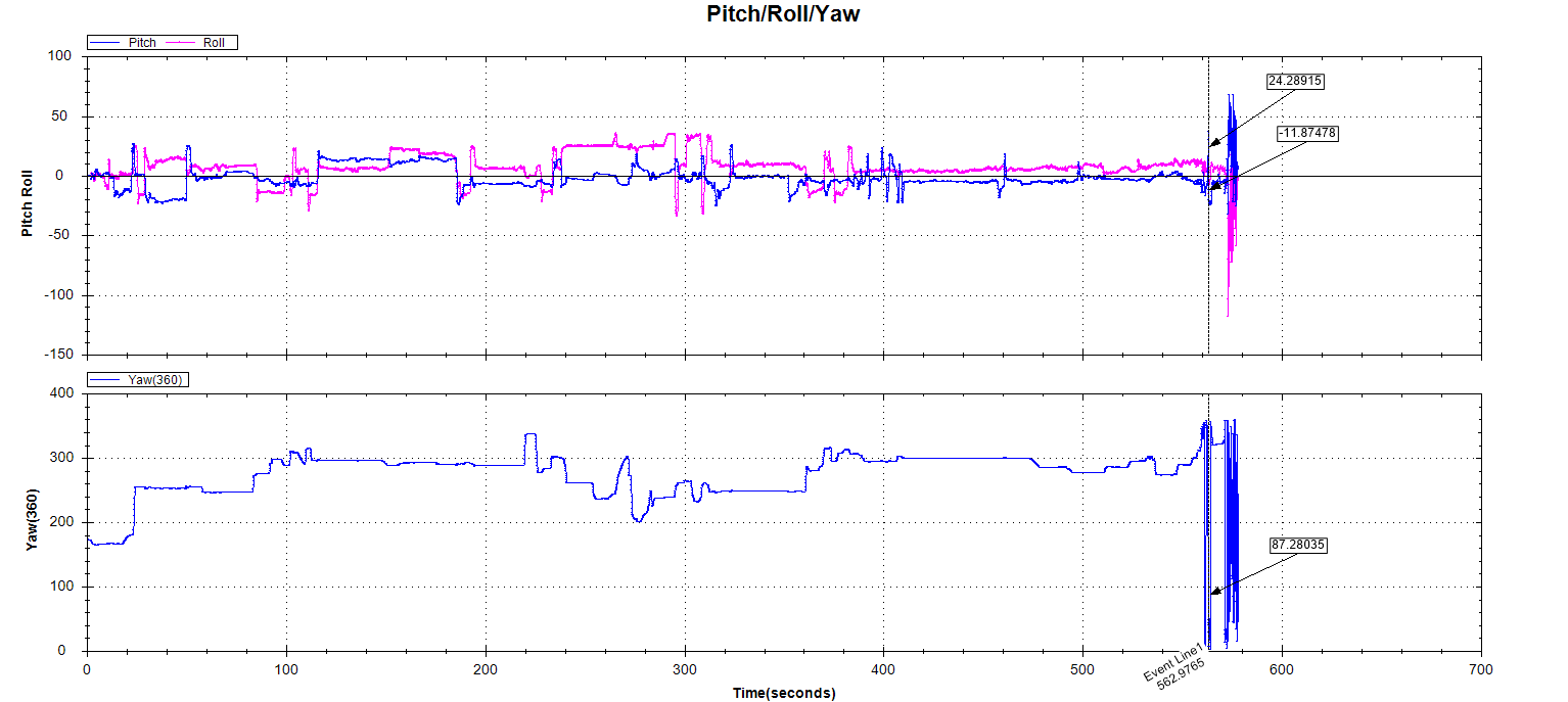

After tripod mode (you made a movie of the pier there I think?) it switched (did you do this?) to Atti-mode, short after Sport mode and in the end (while descending) atti-mode..
So this switching seems to be the start of the problems. Maybe you didn't see you switched it to atti mode?
Did you see the bird go down or didn't you have any sight on it?

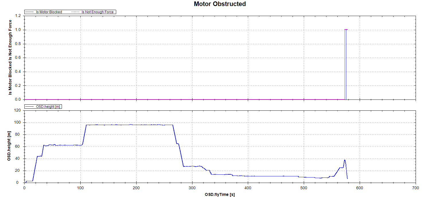

From the data, it appears you had a motor issue. At ~570 sec, you had an obstruction warning, which means most likely either you hit something or something hit you. You began spinning out of control from approx 38m in altitude right in to the water.
I didn't see anything. I was watching the general area. It kept switching to atti mode. I didnt switch it.
It switched to ATTI because you were spinning out of control. No way from your position could you see such a thing as possibly a small gull. Just a guess but you were too high in ALT to have another theory. An I never said you switched it, by the way. That is neither here nor there.
