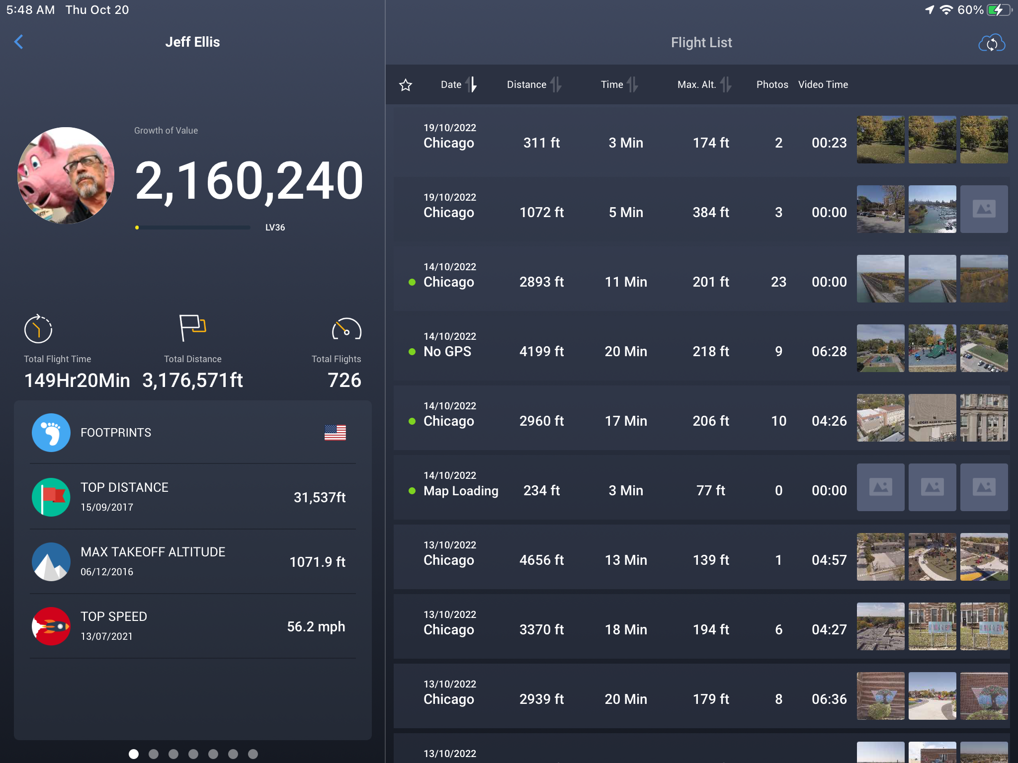

OK then. This should be the last flight. Have to work this morning so I don
t' have time to look at it - but will be Greatful if you can.
Let Me Know if that isn't the right one.
The top record I should be the last flight:
  • DJIFlightRecord_2022-10-19_[15-14-50].txt
Update: not sure this is the correct flight log.

Do I have to upload 1 file at a time for the DJI viewer? Or can I select several?
From that screenshot it looks like the correct file at the top, but when I just opened it up its a flight from last week I did at a different location.
The flight log you posted first was the correct (the last) one.
Here is how that looks on the Phantomhelp log viewer:
