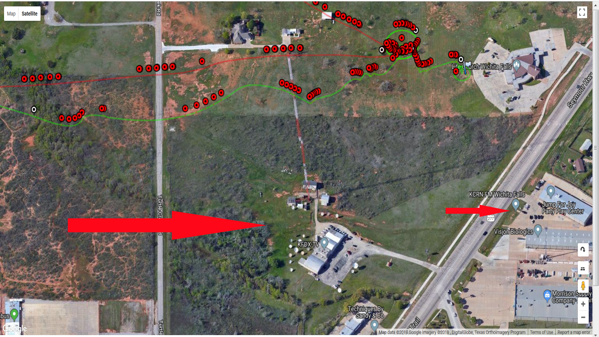

Looking around the satellite map of the flown area... I notice several potential problems. Microwave central? The notifications of STRONG interference may be a giveaway. At least 2 FM stations, but the TV station with its 200' mast near the flight path
is a real eye opener. (2nd FM station is to the left on map not in view in this pic.)
I sincerely appreciate ANY suggestions and will take your word that the area could be a bit problematic. I must say tho that I have flown that area probably 100 times (literally) with no issues. My ‘last flight’ was a trail I have flown consistently for the past year. I am never closer than you can see during this ‘trip’. I’m NOT discounting your observation one bit!
