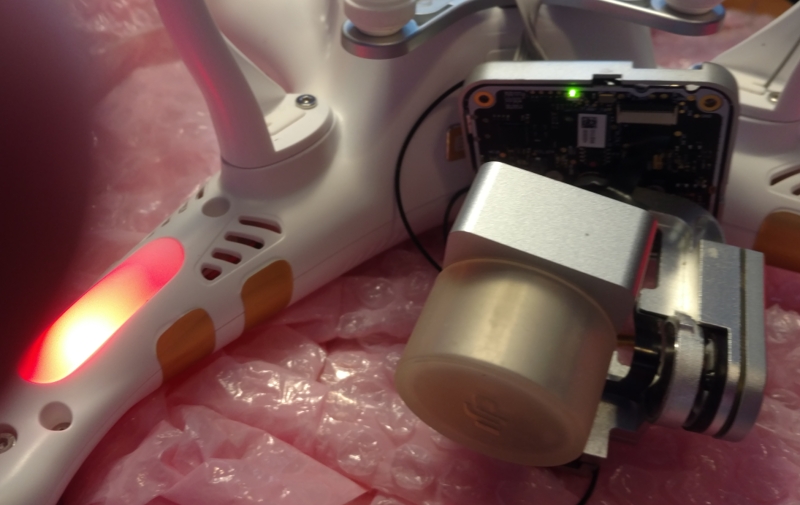

Change ribbon and now Green light ended with reed then no light from signal diode for camera that came in loop still weak signal at APP in phone
