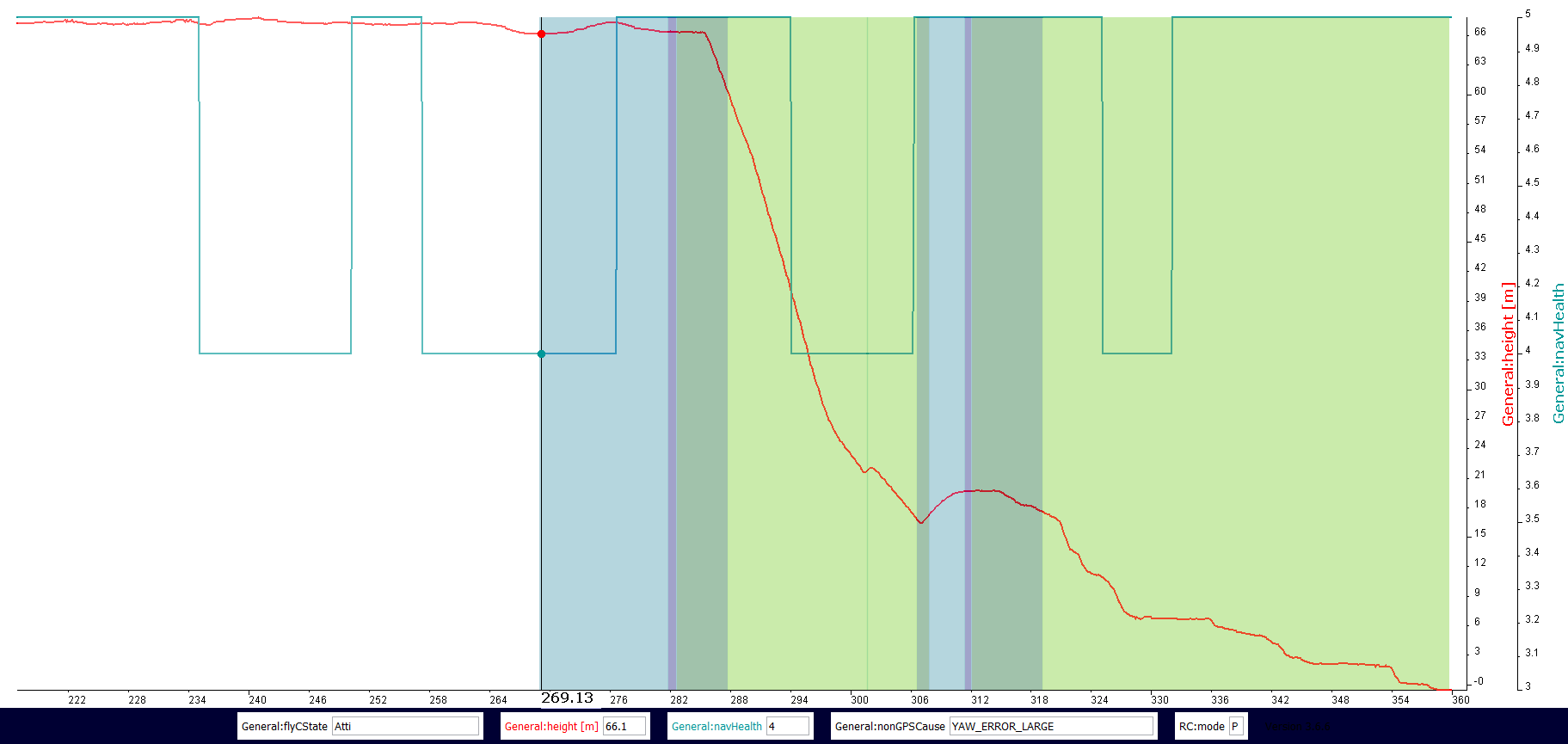

imu & compass are calibrated.. values are continusly changing.. mod gyro is 0 .. acc is 1.00 and compass around 1500 .. no errors are reporting when on the ground.. and yes ive switched to atti mode as there was a huge compass error and the drone was flying away from me.. so.. what could be the cause of imu failure midflight??
I'm really not sure. Unfortunately the P3 doesn't have redundant IMUs, so it's very hard to know which data are wrong.

Without looking at the .dat file are your recollections of the flight accurate? You mentioned switching to ATTI. However, it looks like the aircraft had already auto switched before you toggled the RC to ATTI. That may not mean much, but I don't think that I have seen a manual switch following an auto-switch.

you re right.. it switched in atti mode because of "compass error" and was flying away.. meaning no failsafe to me.. no rth.. i did that to prevent the worst scenario of losing it.. i switched to atti mode to bring it back to me and land it.. if you see at the log.. when i pressed autolanding when gps mode was back.. it flipped again in atti mode because compass error was back.. it couldnt make even an autolanding so.. i switched again in atti mode to land it safely..
You didn't need to switch it manually. It will fly the same. You most likely would have in and out Nav Health as the data shows but you would have been able to fly it back either way. I am not sure that the manual switch was or wasn't an issue. It should not have been, but as I mentioned I have not seen one set of data that initialized an auto switch and then the OP manually switches. It is a conundrum, if you will.

I have been looking at your first post data from the .original log file. That should have been posted as FLY0070.dat for that flight. Your second flight posted is FLY0142.dat, which you did post the correct .dat for. I have been looking at FLY0142 in comparison to the original .txt log post for over an hour and just realized after attempting an overlay that it is the wrong flight.
Can you post the .dat file from the original flight? FLY0070? Yes, my fault on that but can we get a bit more specific on the data involved here?
I don't think so - it looks like it was the RC mode switch. There is no mention of the FC switching:
187.058 : 11632 [Ctrl<1>] REQ_RC_NORMAL ATTI ctrl_atti
195.558 : 12057 CTRL reset all by rc mode switch
195.598 : 12059 CTRL reset all by rc mode switch
195.918 : 12075 CTRL reset all by rc mode switch
