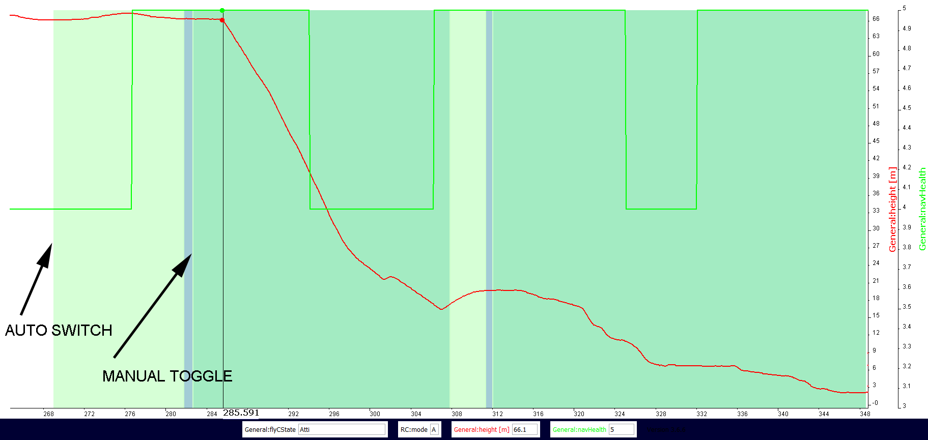

I don't think so - it looks like it was the RC mode switch. There is no mention of the FC switching:
Which flight? First or second? My post was the first flight, originally posted. Not from the .dat but from the .txt file. This is where the confusion enters, between the two. The second flight has an AC .dat. The first does not.
Reactions: sar104
@sar104 ...This is what I saw in the original .txt log....
Reactions: sar104
Good point. I was looking at the second one (DJIFlightRecord_2019-07-19_[15-07-42] and FLY142).

how can a manual switch conflict with auto switch?? if i hadnt switched i could have lost it...
fly070.dat isnt available anymore... so.. lets see what can we discover from fly 142.. i gave you everything i could..
and the riddle is getting on.. is that the imu?? if i swap it could that solve this flyaway attitude??
I am not saying that it can. Only bringing up the possibility. There was no need for the manual switch because the aircraft was already in ATTI mode. Which means that if the Nav Health recovers, GPS positioning is automatically restored. Not so with a manual switch except for the availability of RTH.
