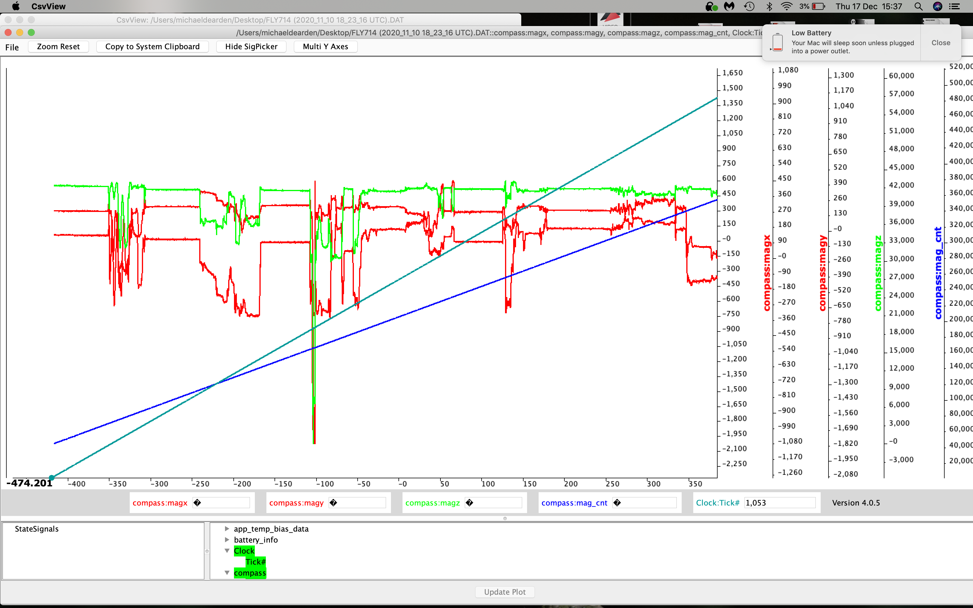

Xrider - was the fight just over 5 minutes (am I reading the data correctly). This is the compass plot, can't see anything significant there?? Bit of a glitch about 1½ BEFORE lift off. Maybe someone more experienced can read more into it.

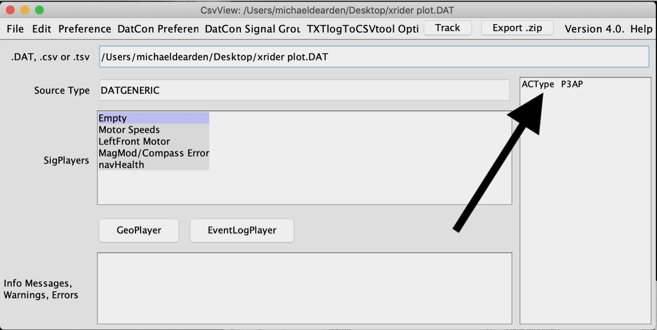

You're right the only compass problem occurred at -104 secs - probably because the P3P was being handled prior to launch. I suspect that @xrider posted the wrong .DAT. The one that was posted doesn't match the snapshot that was shown in post #15.
Hi Bud, yes quite agree and yes, this is a P3A file!

hello there again.. hold on a sec.. how a p3p can write on its .dat thats a p3a??
