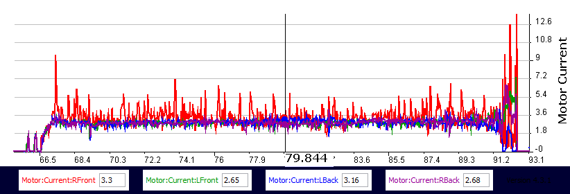

It would appear that the right front motor has a problem. Compared to the other motors the current is generally higher and very erratic. Here the red plot shows the right front motor current.
Looking at the last second or two of accelerometer data the impact with the ground occurs at 92.418 secs. Immediately before that the right front was commanded to 100%.
Also, the P4 started tumbling; rolling CW, yawing CCW, and pitching down/forward. All consistent with right front reduced propulsion.
I'm guessing the right front motor is the culprit.
There were no indications of a compass problem.
