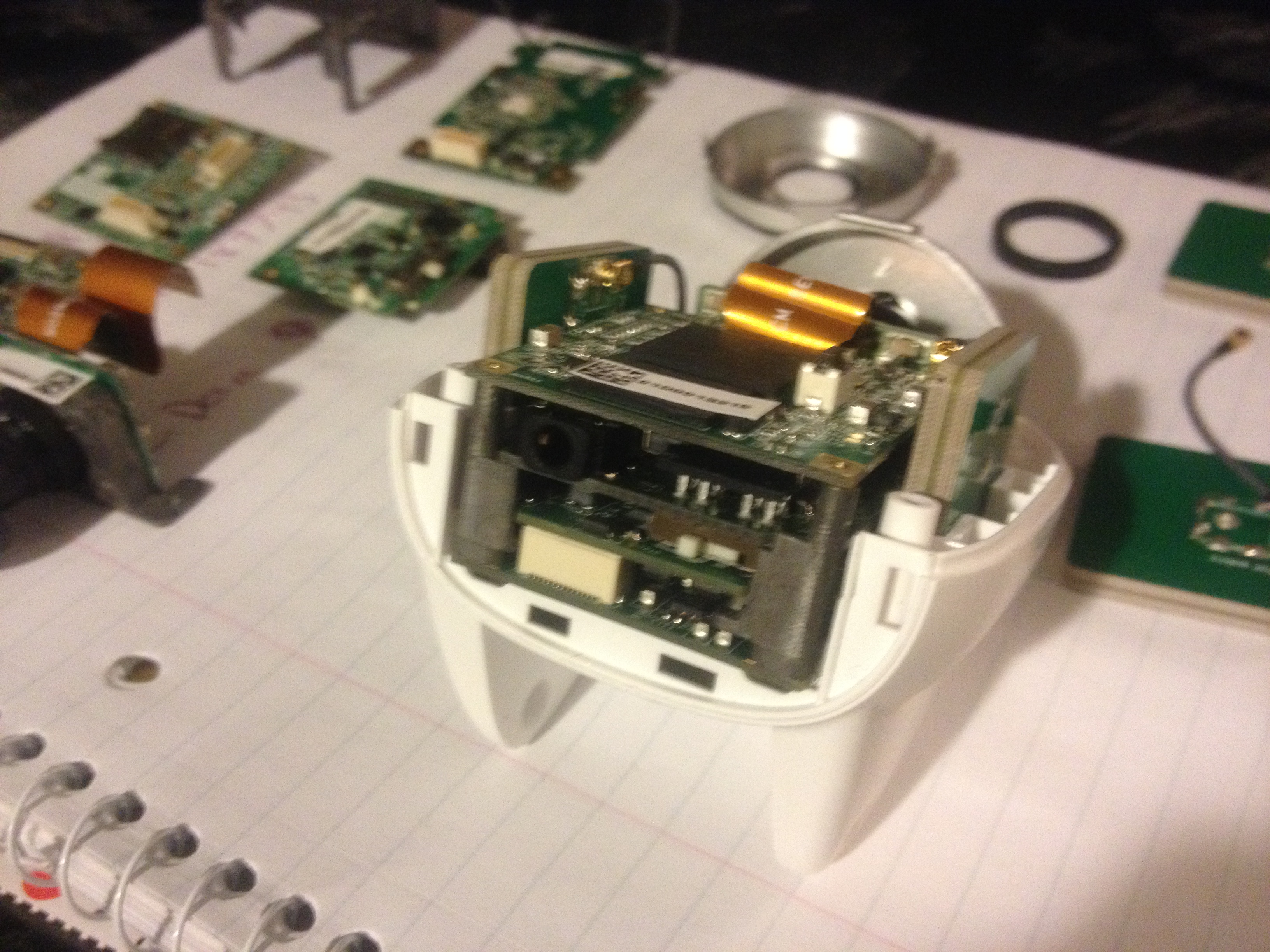

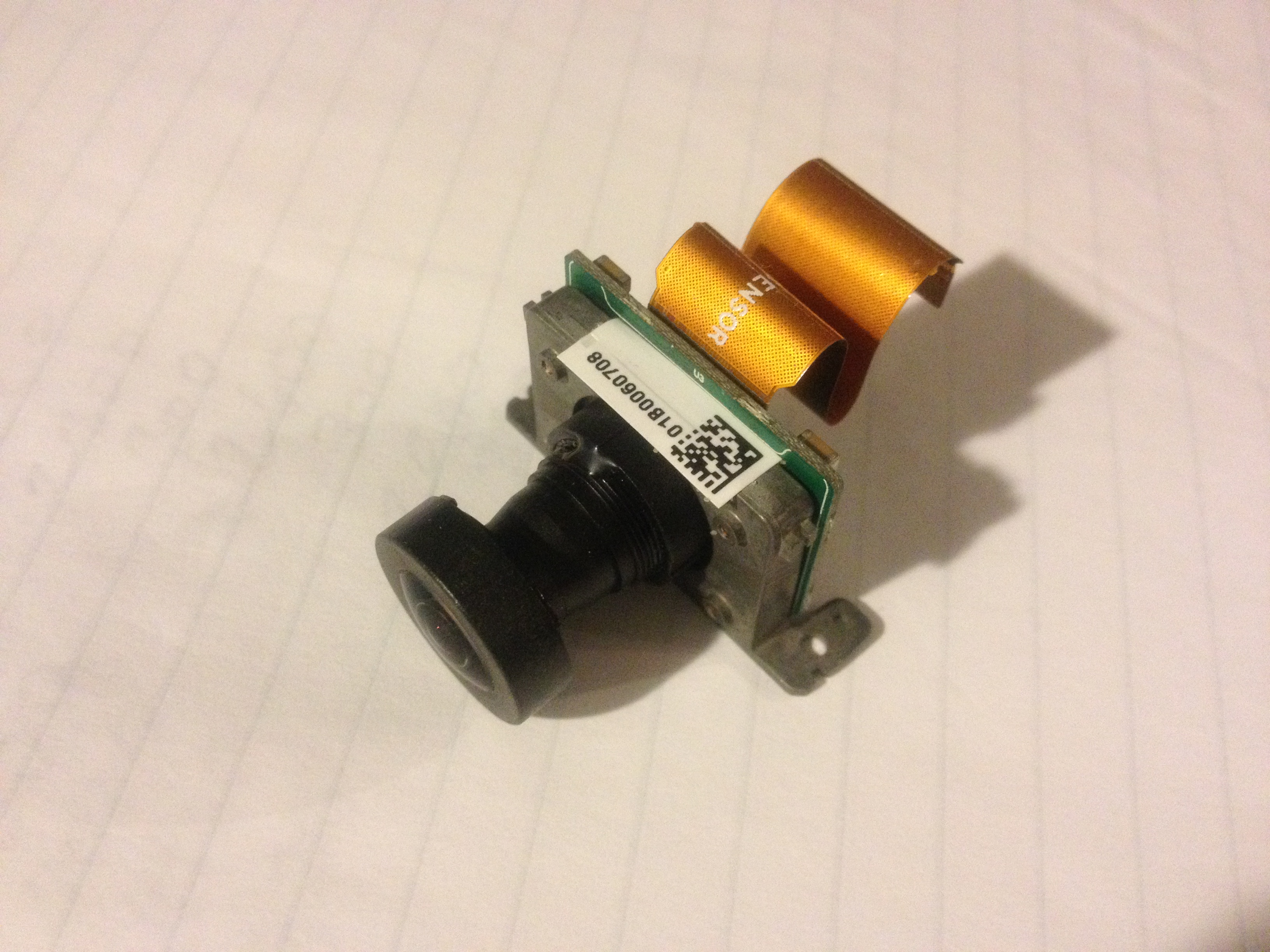

I recently bought a P2V and have been struggling with the FPV. Are these boards available anywhere as replacements, or are you dismantling other cameras to make the repairs? Thanks for all of the help with this widespread problem.
@J Dot has been dismantling them and has a source and sure he will help or tell you shortly . He has helped me several times .
I did say several didn't I ? :)
Welcome to the forum !
Reactions: J Dot
Thanks! I appreciate the support. It is a great flyer, but I would like to be able to use the FPV features also. The forum here seems like a great set of resources. Looking forward to learning and contributing.

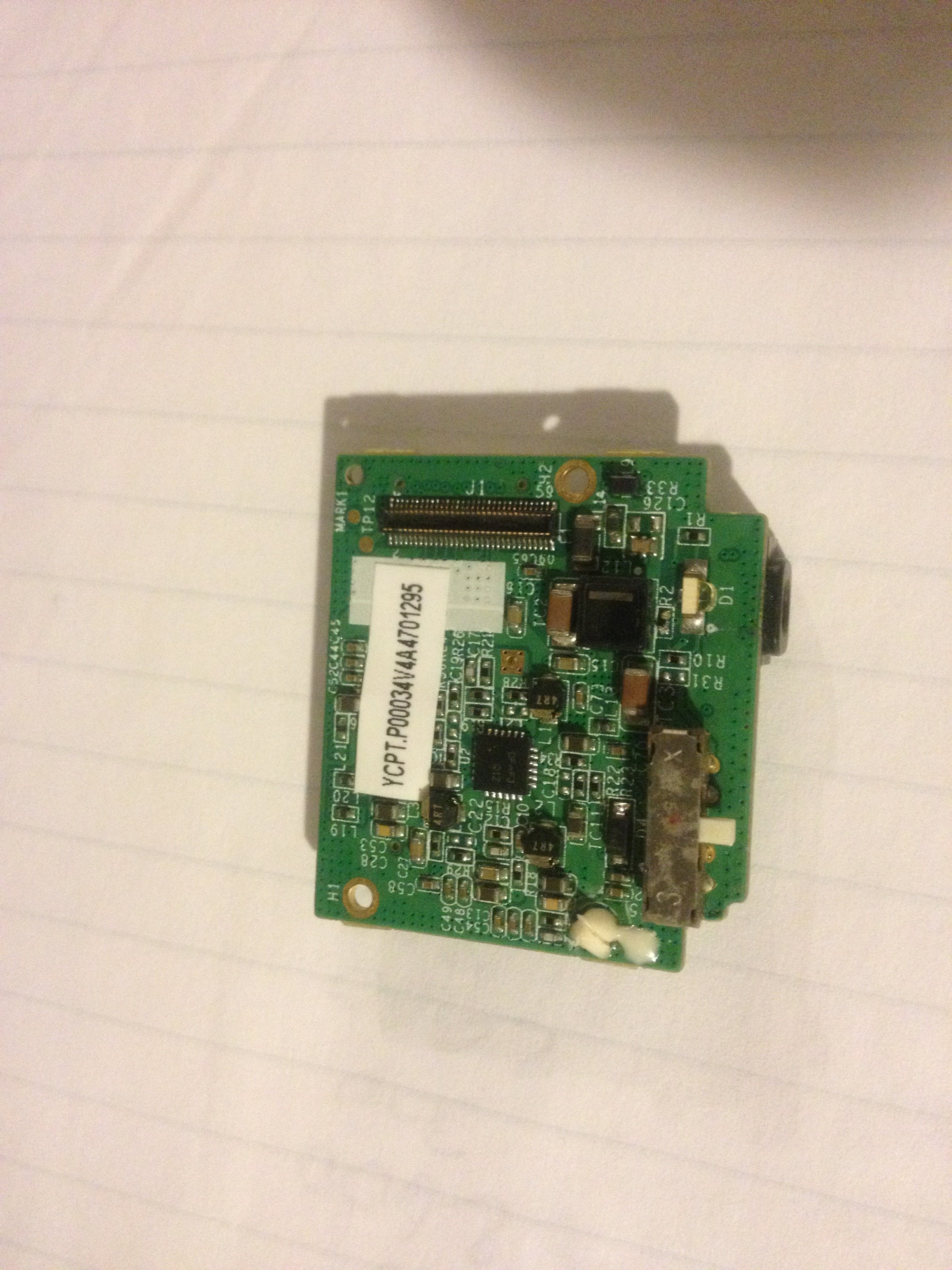

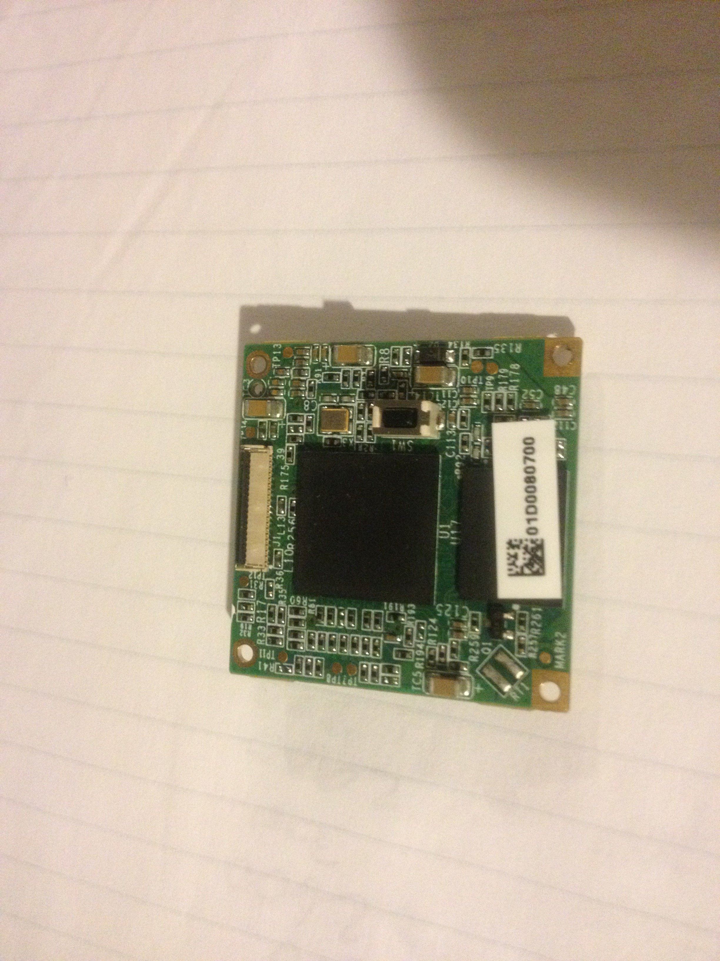

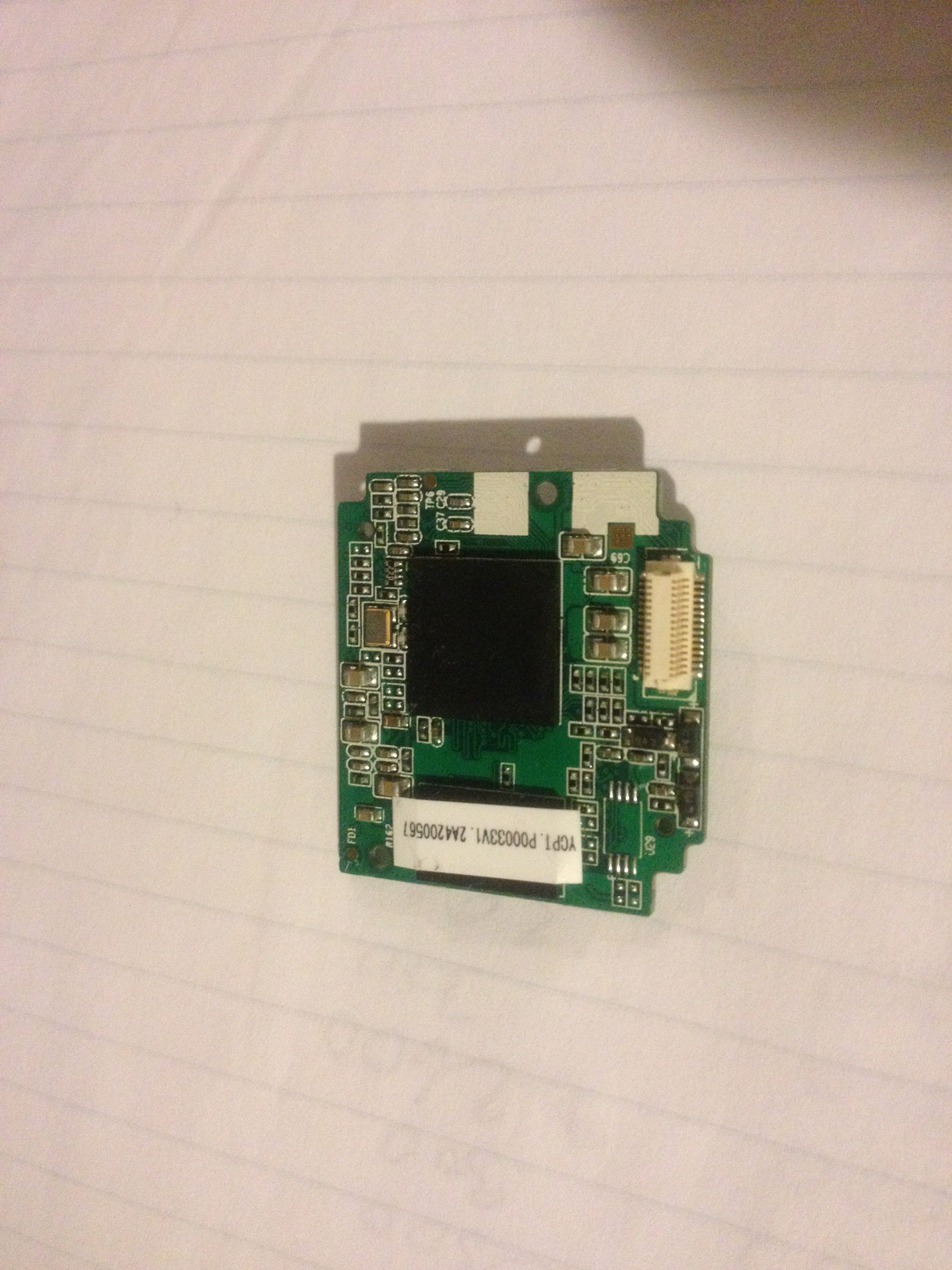

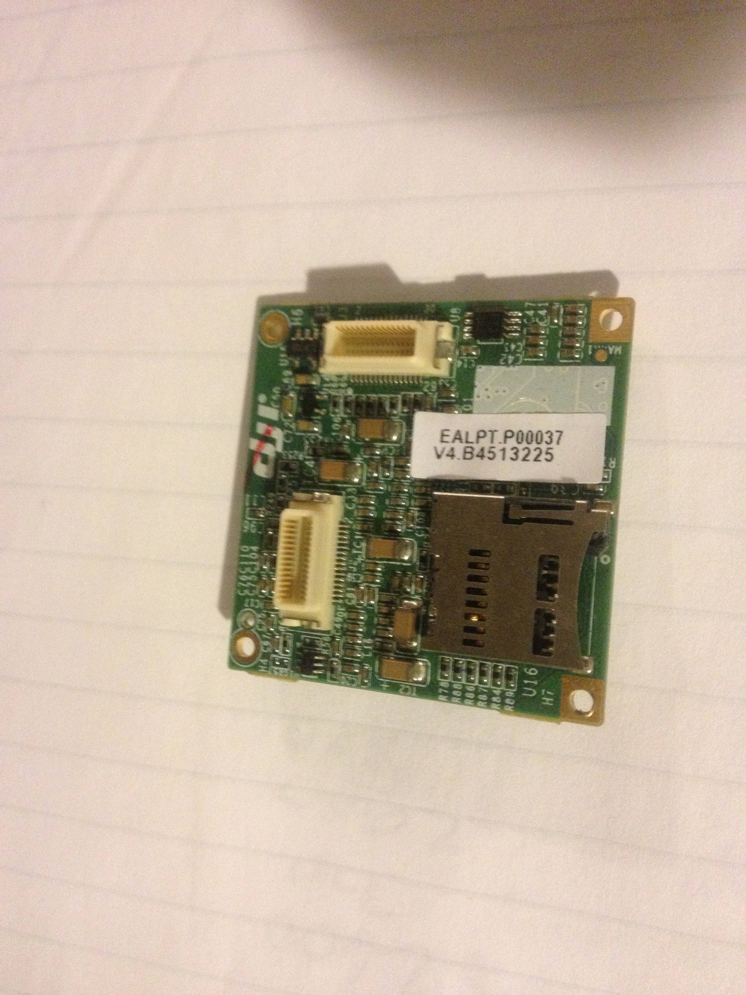

Unfortunately these boards are not avail. When the P3 was introduced, I started buying up cheap cameras. Some broken some working. Personally I use a working camera's components to test each board. But since this epidemic, I'm nearly out of cameras and parts. I do have a friend who is a great parts guy. But you'll need to figure out what board is bad before you start buying stuff. But hard to do without working components to test with. You can test wifi board with ( android InSSIDer app )
Turn on only phantom ( with camera set to wifi on ) open app and look for ( 60:60:1f:??:??:?? ) question marks are your Mac addy numbers/letters. 6 in all.
Make sure these numbers match your box or wherever you got your numbers from. And make sure they match the numbers bound to extender ( in vision app under settings, binding ) numbers should match if they don't manually type in numbers in binding procedure click both blue checks, reconnect to phantom wifi open app check camera. If you see NO signal ( 60:60:1f:??:??:?? ) than your wifi board is bad, if you get telemetry but no FPV only spinning circle thing, than top or 3rd board is bad. I've not seen board 2 ever go bad, except for SD CARD slot wearing out or damaged by inserting card backwards. Do some of this testing and get back to me with results.

J.Dot... Took the P2V up for her first real flight since the camera replacement. FLAWLESS flights. Went through a battery with not even a hint of a problem. Thanks yet again...
-slinger
Reactions: J Dot and dirkclod
Thanks, J Dot for your description on troubleshooting. If I understand correctly, based on what you described, I am assuming my wifi board is bad (can see telemetry info, but no live video through the vision app). Picked up a used camera and will try experimenting with swapping the wifi board.
Thanks again for the help. It seems these cameras are getting difficult to come by, and there is no formal servicing offered outside of DJI. Will update if I am able to get it working with FPV.

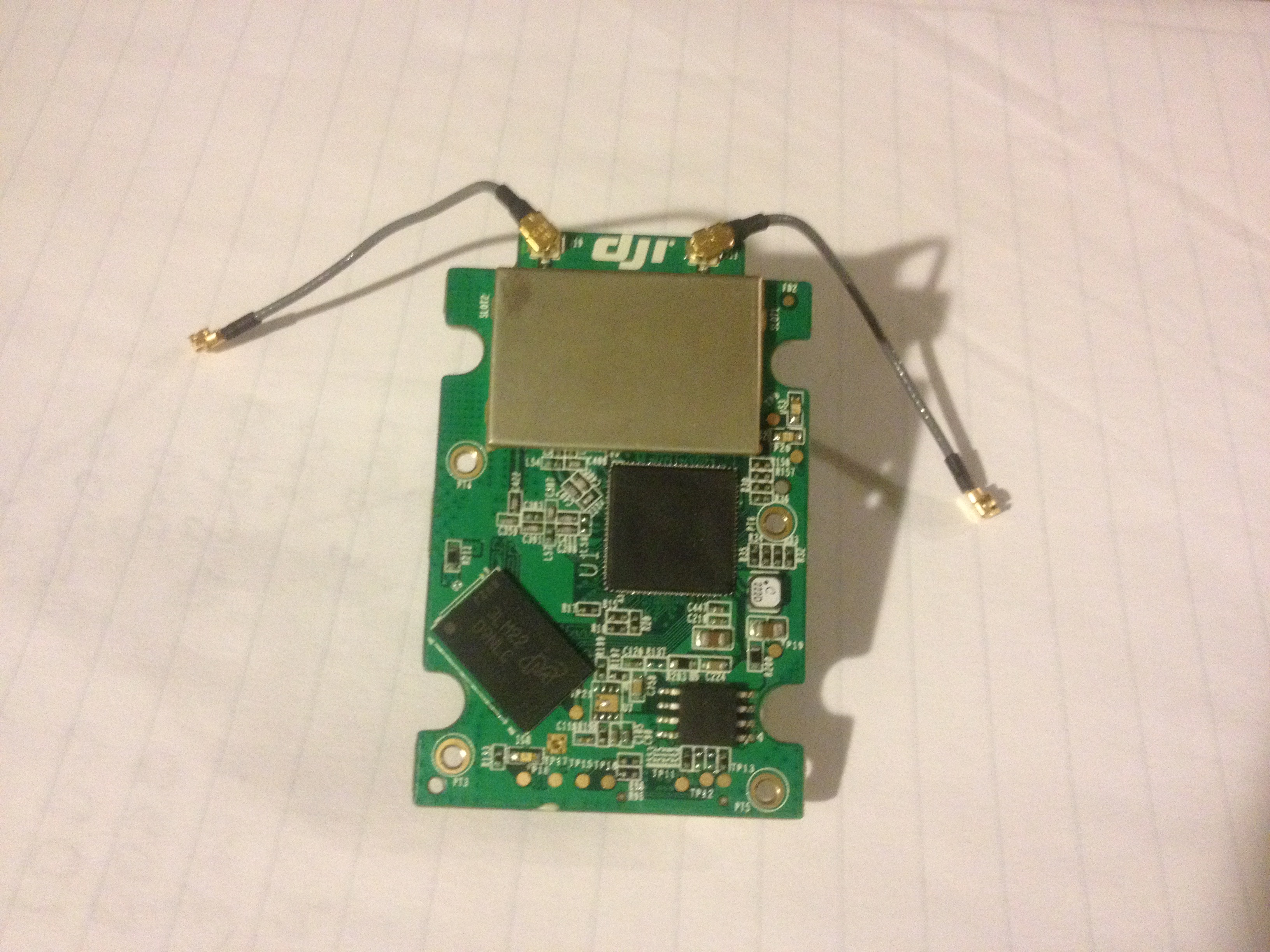

Either the wifi module or most likely gimbal mainboard is bad! You can test the wifi module with ( InSSIDer app ( android )) look for
( 60:60:1f:??:??:??)
If you get this signal than wifi module is good ( mainboard of gimbal is bad ) if no signal than module had failed!

On The DJI vision FPV, it says that. It also has the signal you were talking about, 60:60:1f:??.??.??
Than you have a bad mainboard in your gimbal, I've seen it time and time again!
Search " DJI vision gimbal mainboard " to find a replacement.

Here is a breakdown of a fc200 p2v non-plus camera
This is a picture with top plate, and rear cover removed! From here out boards are in order top to bottom ( even though camera is upside-down ) top board #1 board, bottom #4! Ect.

1st thing you remove are the 2 screws holding the camera lens unit and board on. Located 1 each side of camera base, Phillips screws. ( must lift clip on board #1 to remove ribbon cable )
Camera lens unit
Ok now remove 4 small Phillips screws ( 1 on each corner of board )
Carefully pry board straight upwards to unlock, and set aside.
Board #1 camera board
Next remove 2 small Phillips screws opposite side of board #2, ( power board ) carefully pry up and away ( be extremely careful with this board, as the cooling fan leads attach to it, and can break easily ) gently lay over the side of camera for now.
Board 2 ( I removed fan, fan good, board is bad ) but only for picture purpose

Next is board #3 ( culprit )
This requires a small flat screwdriver, as they are special screws, remove 2 post screws, pry board up and away!
Board #3 ( this is board that fries )
I believe the processing board?

Remove 2 Phillips holding metal housing into camera top shell, remove housing with board #4 attached
Turn over, remove the 4 Phillips screws holding board #4 to housing
( take special note, if you SEPERATE this board, you'll need thermal paste for reassembly, goes between IMU/housing , you'll see the white dot )
Board #4 ( wifi board )
