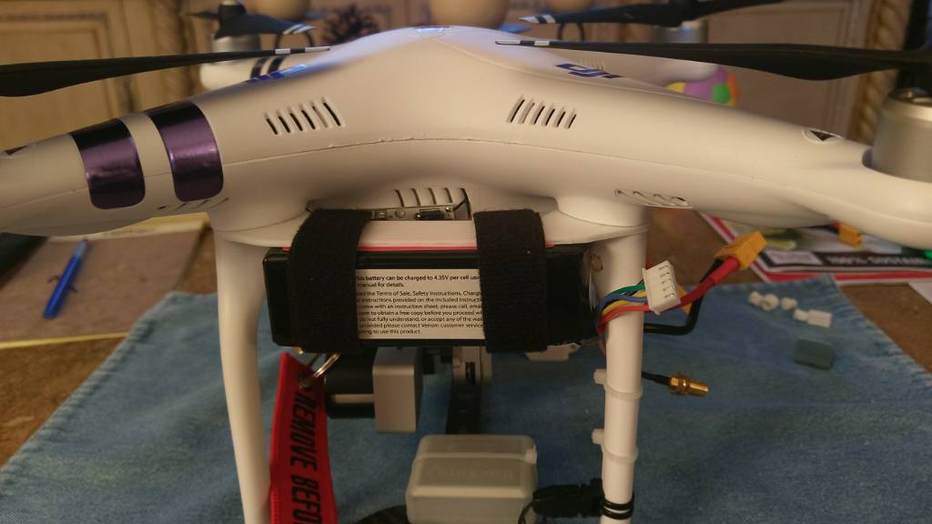

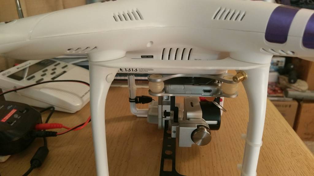

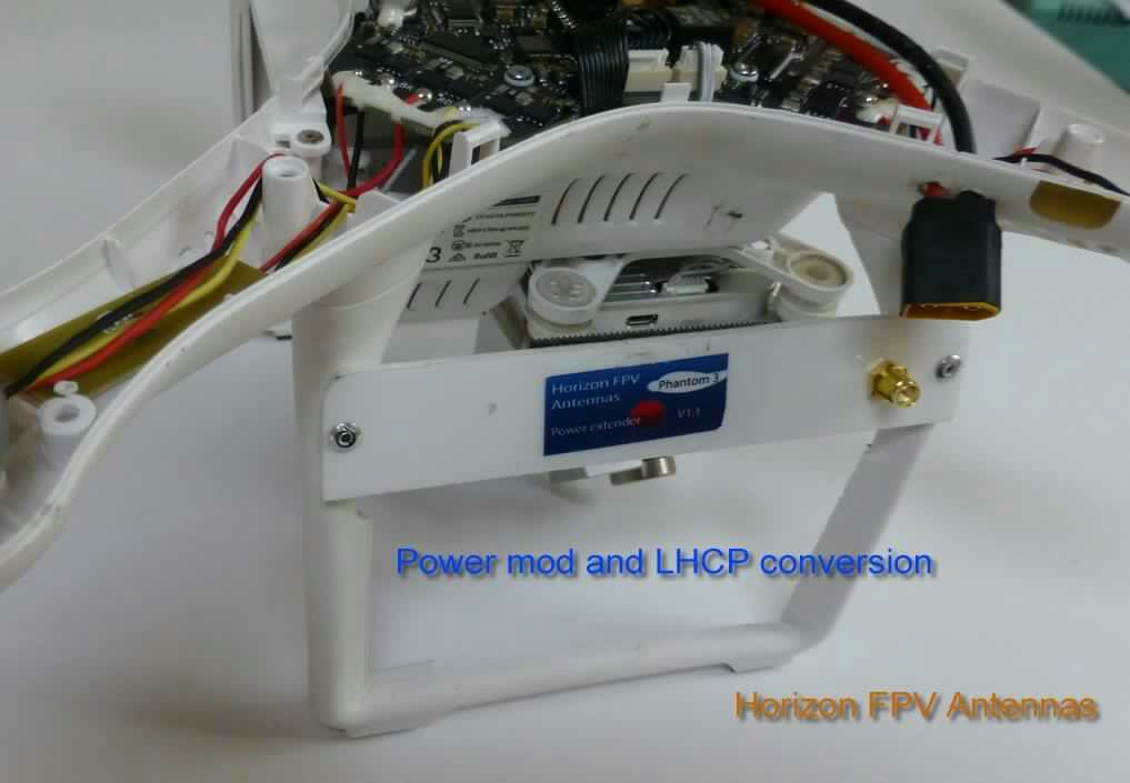

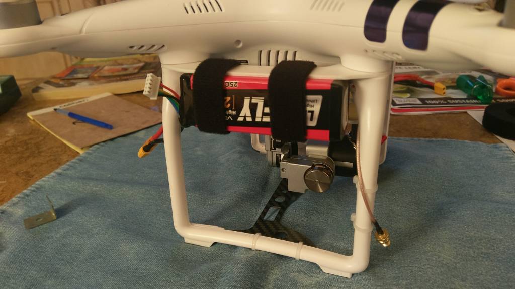

Just installed my new battery mod, but had to remove the dipoles. Anyone have any suggestions on where and how to reinstall them? Need to find a place to mount the two 5.8 connections.
I don't remember, I tried so many, LOL. It worked well enough to get me to my lake though... 3000 feet away.
The factory antenna is only 2.5 dbi, so these will be an increase for sure.

Maybe something like this?
Something like that might just work, thanks for the suggestion. I'll take a trip to Lowe's later and see if they have a strip of plastic that I could attach to the legs like this. It would need to be below where the battery is though, so to give room for the cable to run.
