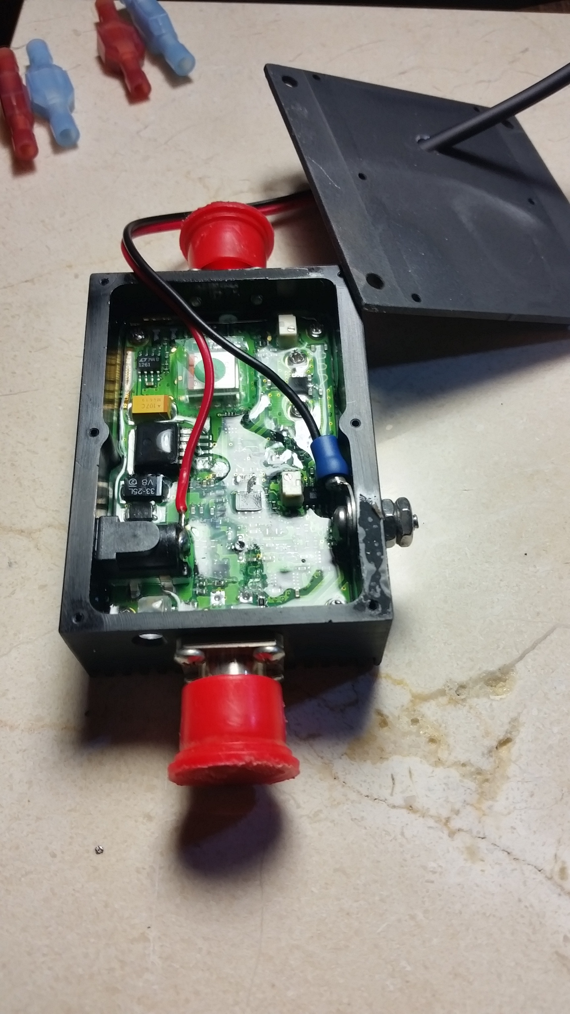

Power bypassing the hidden jack on the RF-Linx 2400-SAXU
I thought of drilling out the jack port, but ddn't want to damage it. This works and now just waiting for weather to test them. I still havn't figured out how to adjust the power output. There are two adjustment pots, which one to adjust?? I guess I'll use my rf meter, but hopefully I don't damage them while adjusting..... Supposedly, they can max at 1.5 watts.
With my 8 watt amps, and my 4 watt amps, I just wanted these to work due to the RX 20+ db. potential.
R18 in this diagram adjusts the output.
Reactions: GrammatonxXXxCleric
THANKS!! I'd ask where/how you got that, but then you'd have to kill me and burn the plans. ....What's the other pot do? db.?
Lol, I haven't the foggiest, all I did was email the RF-Linx tech support folks and they sent me the build diagram. I'd ask them, they'll probably tell you!
