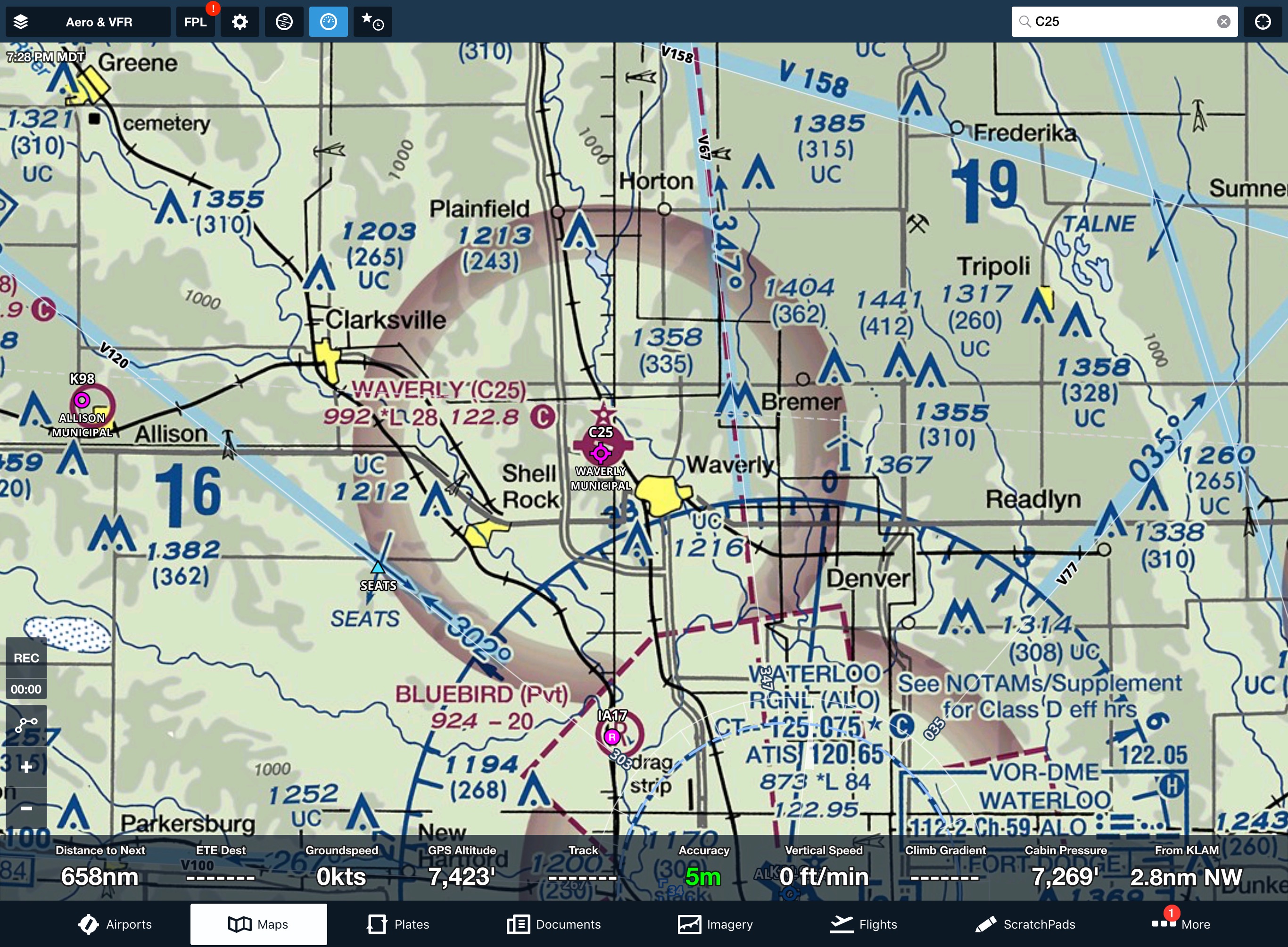

From the Google Earth image of the water tower, taken on 3/10/15, the solar azimuth is 167°, meaning that the image was taken at 1135. That puts the solar elevation at almost exactly 45°. The tower shadow is 205 ft long, so the tower is clearly approximately 200 ft tall (205tan45 if that's not obvious).
Or look up the sectional chart. ;-))

That would be interesting to see. I'm not sure how the altitude could be that far out though. The tower is listed as 216 ft tall and the aircraft was reporting 166 ft AGL - i.e. 50 ft below the top.
