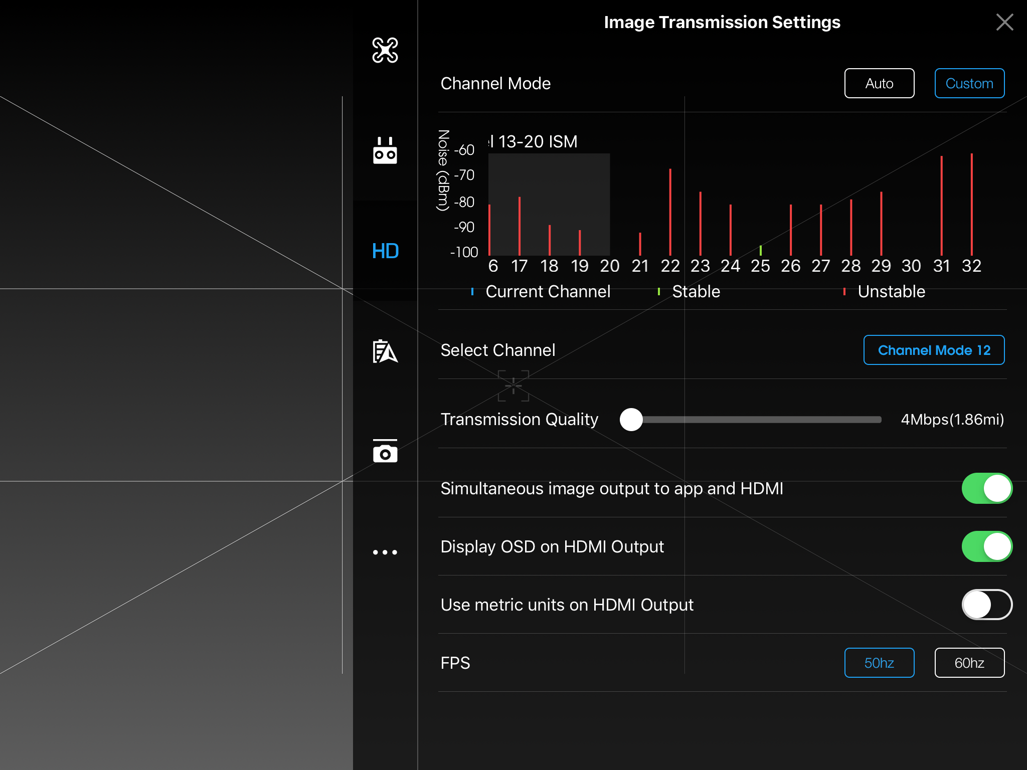

The video / telemetry are different channels from control. You may have just lost video feed. In that case, use the Go4 tools to check signal strength and interference in your area.
Find a clean channel. 5Ghz is usually the better choice for shorter flights.
