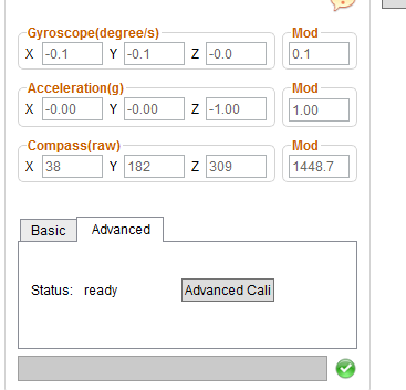

Connect the P2 to its software go to the tools an look at the settings and they should be close to the following photo. Then do advanced IMU (not a basic nor a check) but a complete IMU calibration. The compass MOD value should between 1300/1600 if it's either below or above those figures the compass itself may be magnetized. Once you have completed the IMU cal take it outside and do a compass cal that is if IMU numbers are correct.

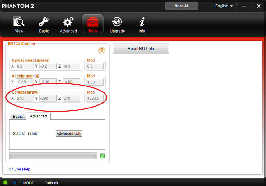

Thanks for the reply. I ran the calibrate and got the results below. They are not in the neighborhood of the numbers you sent for the compass. How can I fix this?
Thanks

There's nothing with those numbers as they are within the the limits of 1300 - 1600. have you tried to calibrate the compass yet? If not do so and see if there has been any improvements in the flight since the IMU cal.
