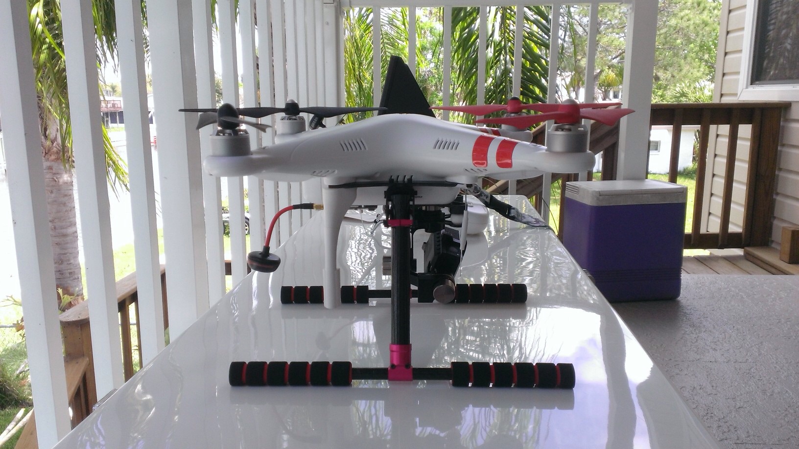

I bought a half way decent third party landing gear, they are red taller and wider, I got these to avoid the legs ever showing in a video after the fact
My question is, are there any tips on relocating the compass and other things that are too big to fit through the holes in my new landing gear?
The new holes are big but the compass and that other fairly wide jack won't fit without being cut off and fed through and re soldered
