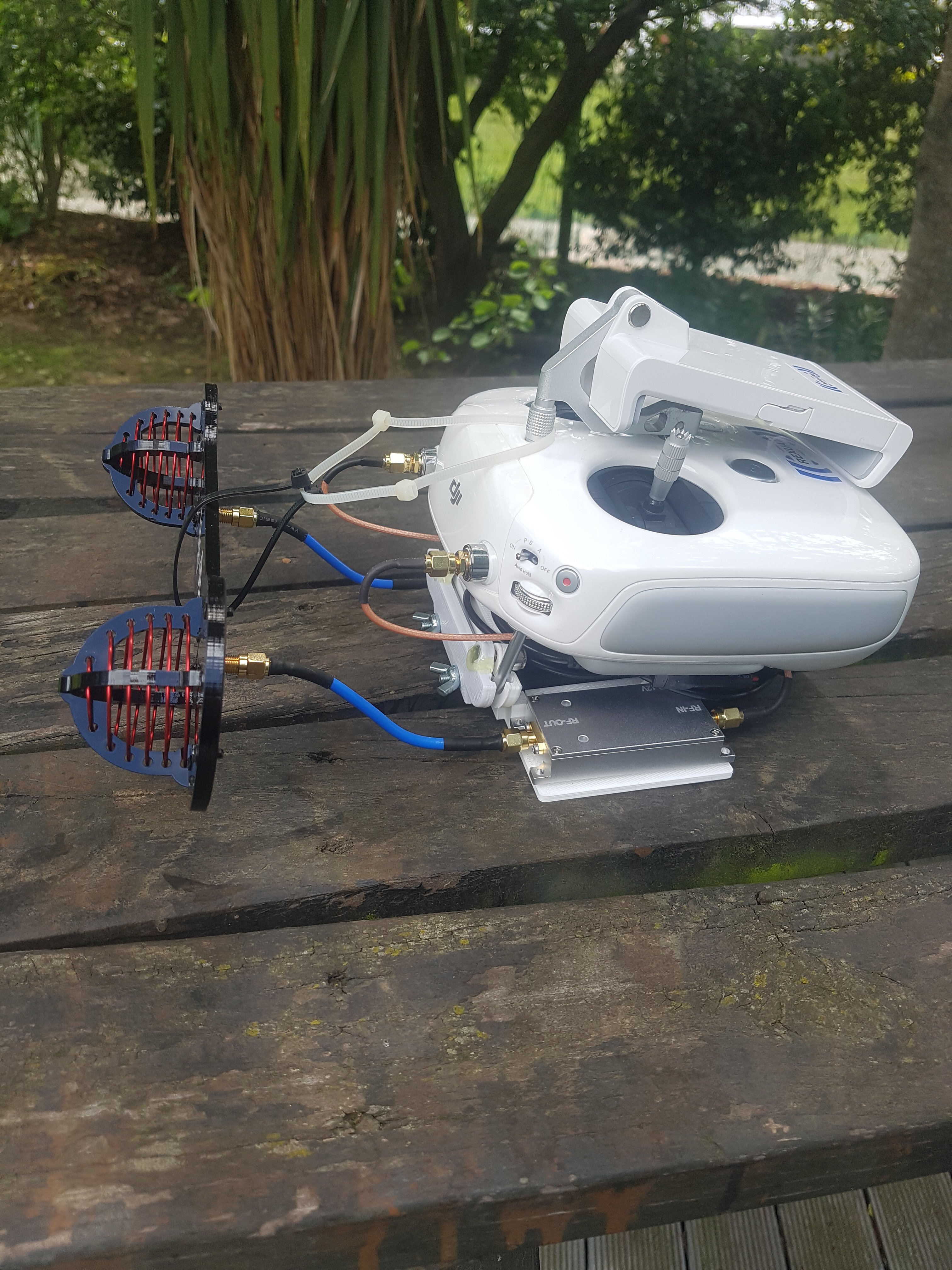

My setup for P4P. Signal strength is amazing at distance with 4w boosters great for behind trees too. Don't fit in the case no more though has it's own special box lol
Rexuav.com
Very impressive equipment but as it has been said here for a several times - WHY!?
P4P have originally very good long range signal and with no problems it can reach 2000m. But in more than 3y of using it I haven't had the situation where I exceeded 1300m. And even that only a few times. Usually I use it within VLOS which is completely enough for good shots. I see no point in raising my adrenaline flying few thousands meters and praying that it could manage to get back. And it is illegal too. But yes, if the only goal for somebody is the number of meter or feet that's another story.
I've found in the areas I often fly , hill country & pine trees this setup inspires confidence with no dropouts, can duck behind a tree or two and still have full signal so I don't really use it to go long distance as such but a far better signal at all times...that's not to say I haven't tested the long range capabilities but that was not my primary purpose for modding. Don't forget I'm in a country where CE transmission is a lot lower than FCC. we get 0.1w whereas U.S has 0.4w so the range is a lot lower to begin with.
