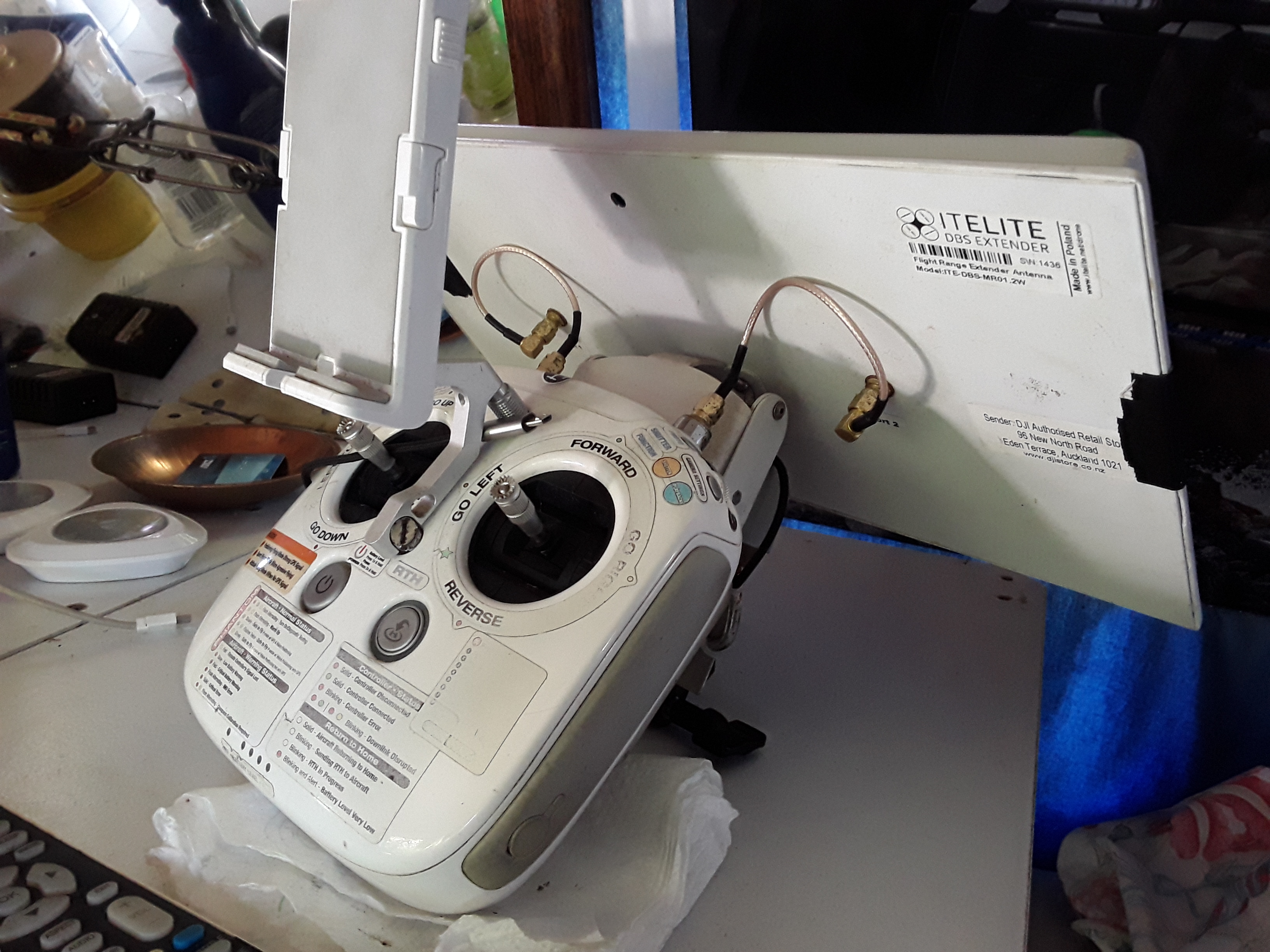

I use itelite on my p4,,,these panels and one you posted are awsome and will improve your situation ...unsure on range due to I like to have it return,,,makes for good image aswell
I use itelite on my p4,,,these panels and one you posted are awsome and will improve your situation ...unsure on range due to I like to have it return,,,makes for good image aswellView attachment 118831
Wow very nice. What did it cost you ? Was it easy to install ? Any down side besides bulky?
also what are all those markings/stickers on your controller ?

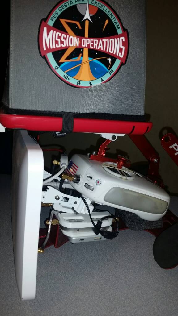

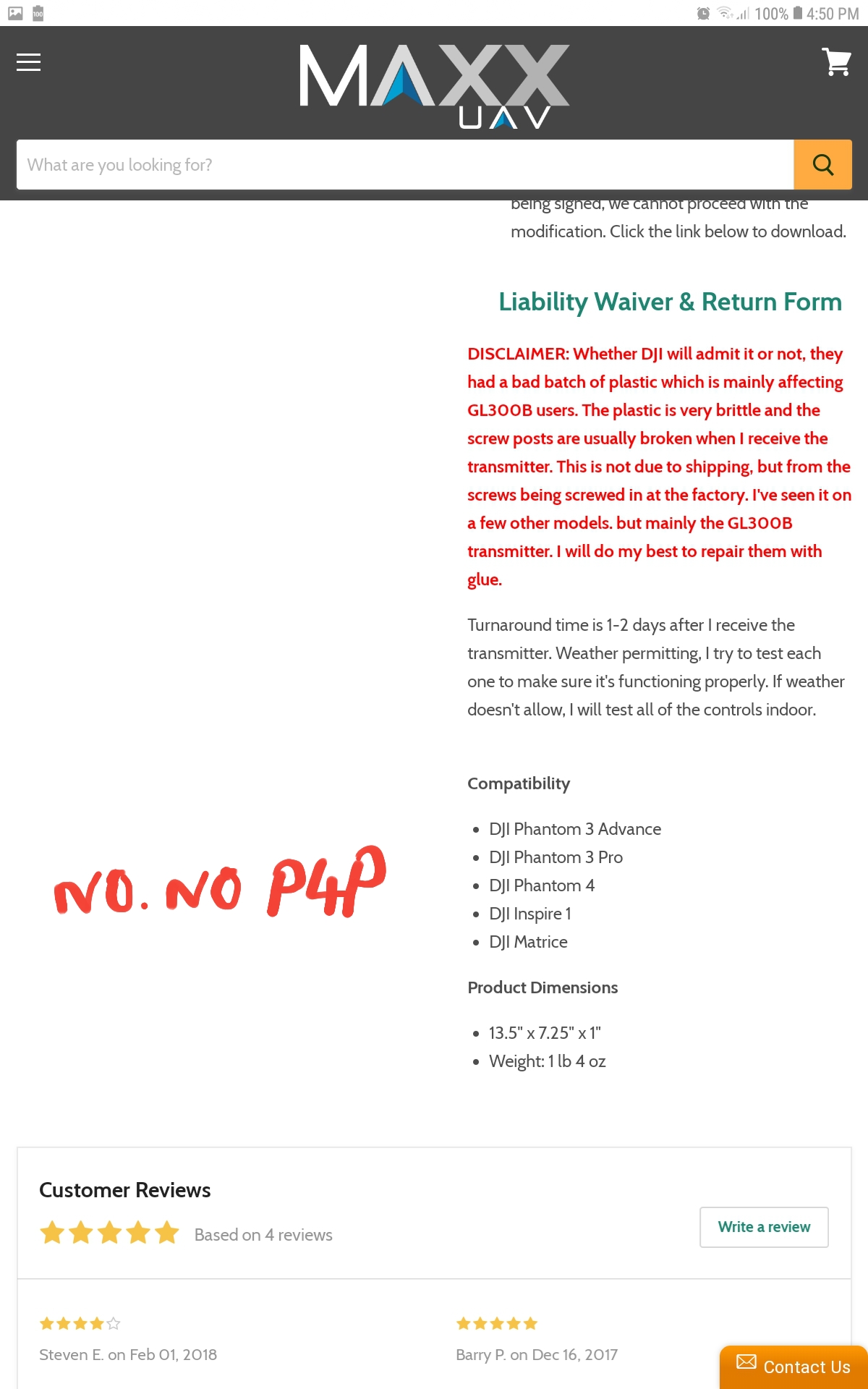

Yeh dont fit in box no more ha,,this was it here,,I also use Samsung TAb A6 10/1 for my screen,,its like holding a brick but can handle that,,I got tripod for remote and harness for remote depending what I doing,,I normally just hold it,,it brought the full kit which came with all leads ready to clip in and go,,install was easy but take time with USB module ribbons,,this panel was best thing I ever done,,na unfortunately no p4p ones but have a search ,,I'm sure they got some

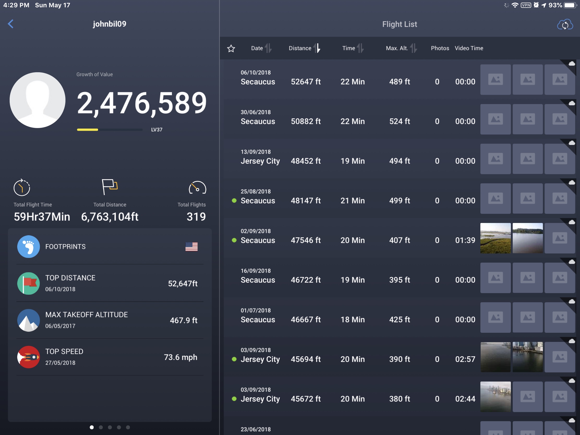

I use a flat panel antenna and like others said besides it giving you clearer reception ( no choppy feed , green screen ,it also increases your distance as long as there’s nothing between you and your drone ,go on top of a hill where you can see 5-6 miles ,on your roof , stay away from standing near a metal pole or fence when flying, it makes the signal travel further but nothing makes it penetrate structures ( and anyone who try’s to sell you an antenna and tells you otherwise is a liar and they only want your money.....
I’m usually only limited by my battery and wind conditions my video feed is rock solid 4 + miles away
  • Wow
Reactions: Capt KO
What is your range with no boosters? I would look at that first, make sure it's optimal, THEN start adding signal boosters.
No boosters were used in the above video.
