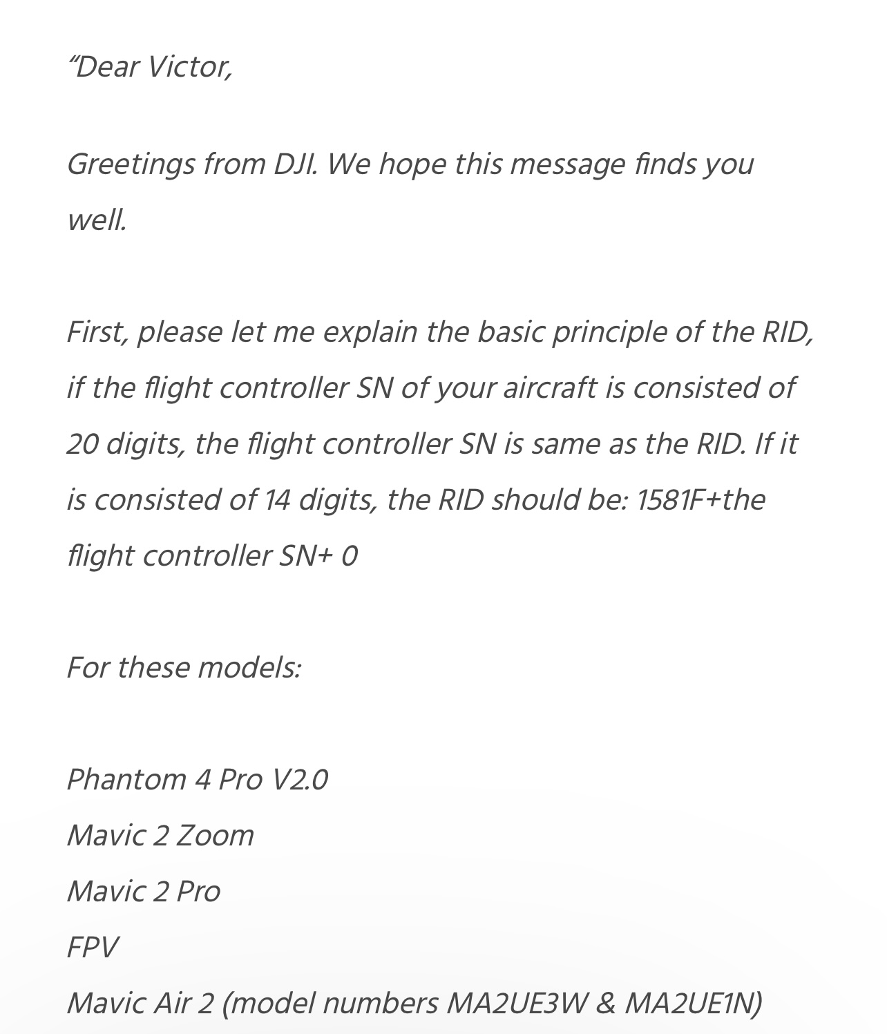

I came across an article here that explained adding your remote id info for your Phantom 4 Pro V2. I can’t find the original post, but I do have a picture of what you have to do. First update your controller and aircraft. Then follow the picture I posted of the process. Cheers!!

So you're saying even though the number I entered for my Phantom V2 were accepted, I still am in non-compliance?
 Thanks
They aren't truly compliant until the FAA accepts the revised DJI lists of numbers.
