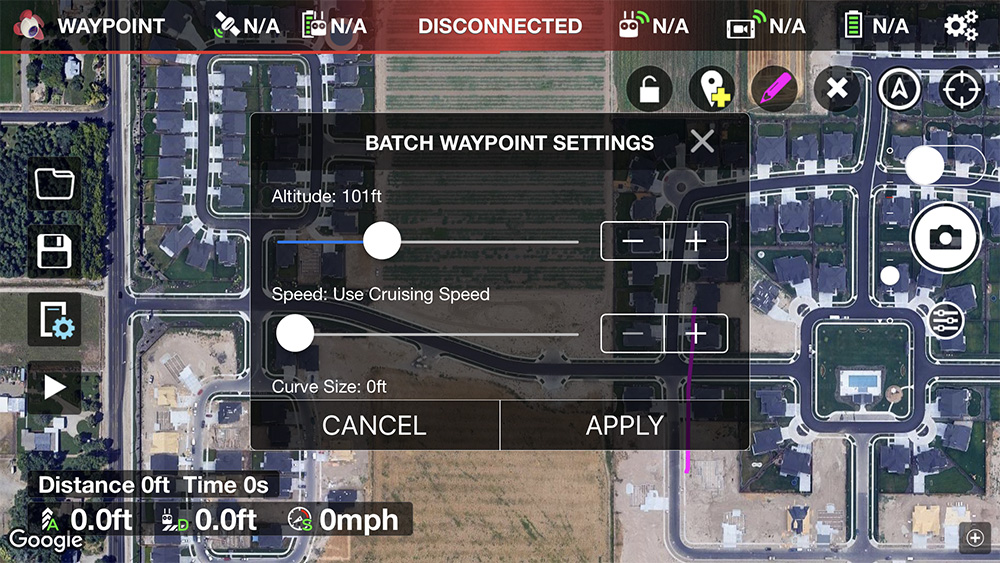

In Litchi hit the Wrench Icon when in Waypoint mode, you will see a Pencil. With that you can draw a freehand path, it will then ask how many waypoints and give you a distance between. You can then set actions at each waypoint.

Here's what it looks like

Actually, I just tried this on my app (iOS / iPhone 7 Plus) and its only giving me the following options:
Altitude
Speed: Use Cruising Speed
Cuve Size
Heading
Rotation
Point Of Interest
Gimbal Pitch Mode
Actions
I dont see the waypoint spacing that is shown in your screen capture
That menu is scrollable, scroll up, it is the very first line.

Altitude is the very first line I have, mine isn't showing the waypoint spacing.
Weird, what version of the app are you running? If an old version try updating it, this has been there for quite some time.

Says 1.19.0 under the settings. On iOS 11 and using iPhone 7 Plus as well as iPad Air (same thing on both). Are you on Android? as maybe it's an Android only feature? but that would be weird.

I am on Android currently it is there on my CrystalSky and my Google Pixel phone. I don't have my iPad with me to see if it is on there or not, I'll check this evening when I get back to the shop.

I checked on my iPhone which has the latest version of Litchi and the spacing option is not there. Must be android only.
So Litchi replied to me and said this on Android Only and that it will one day make it to iOS (but its not a big priority).
