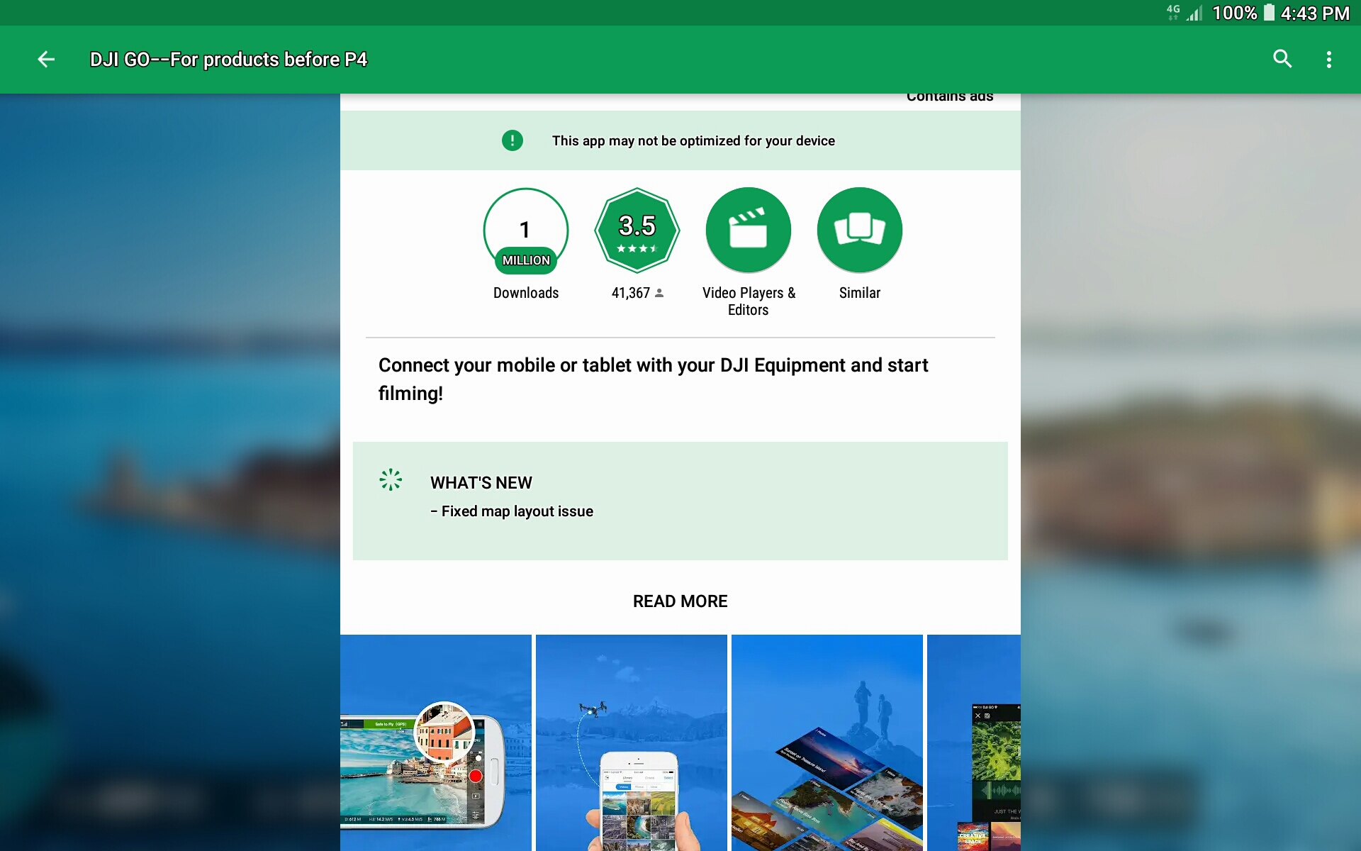

Find a google maps version of the Go app here:
https://apkpure.com/dji-go-for-products-before-p4/dji.pilot
Download the .xapk not the .apk
Uninstall the Go version xx.xx.3x. The one you have that doesn't cache maps.
Install the xx.xx.28 which you just downloaded.
Because the Go app is complex there are some other steps to jump through for the install.
Change the .xapk to zip. unzip it on your android. move the newly unzipped directory structure: /android/obb/dji.pilot matching same directory on your device.
Install the unzipped .apk. you may have to enable allow install from unknown sources in the security settings of your device. GTS.
Complete instructions here.
