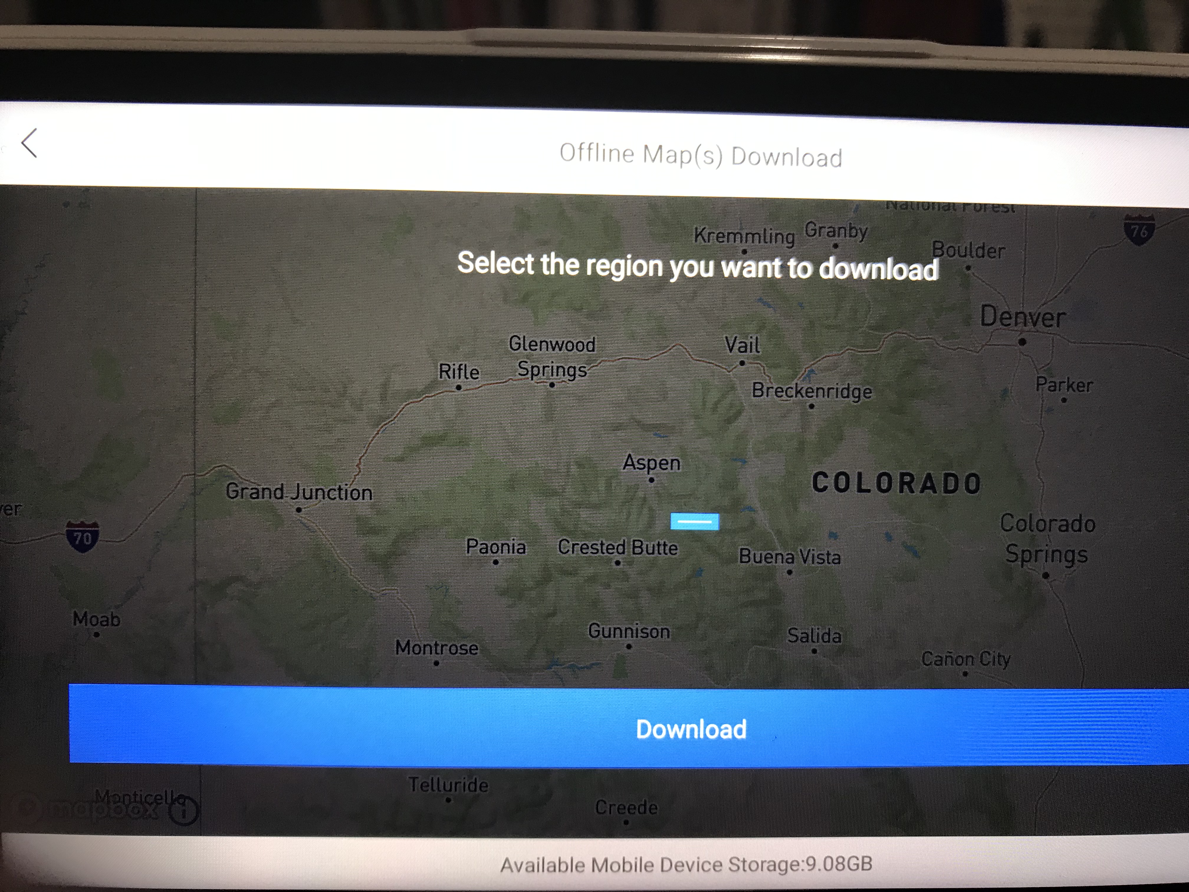

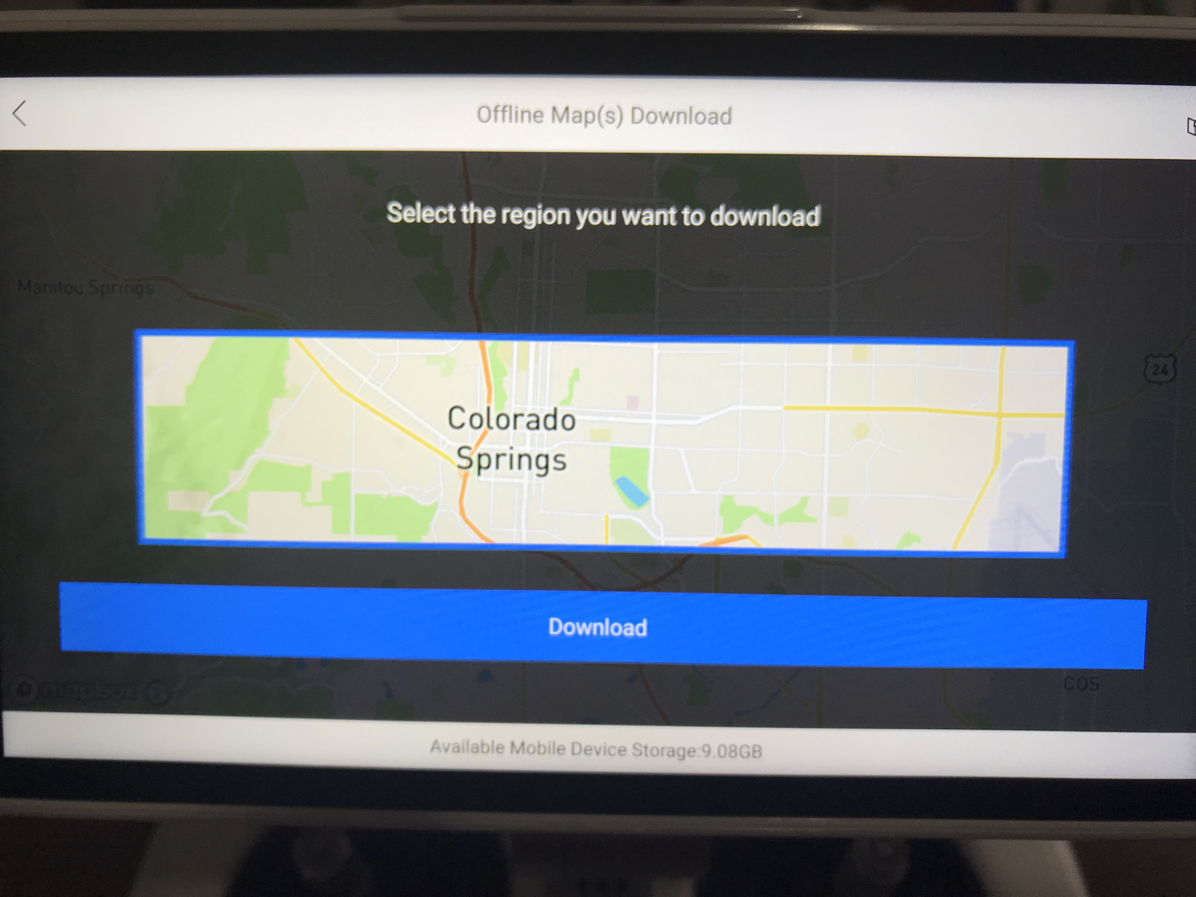

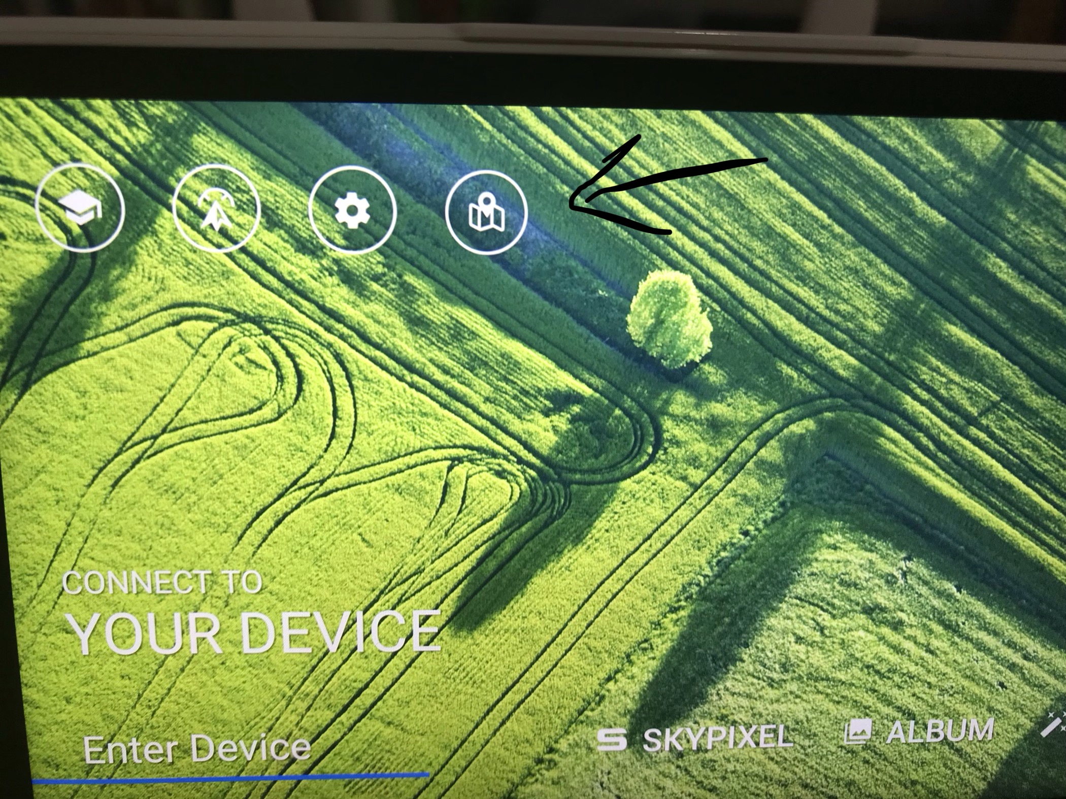

Hello CR125Honda,
I had the same problem and I think I figured it out. Bear with my bad phone photos.
Turn on Pro+ remote.
Turn on Wifi
Go back to the very first screen and choose the map icon.
There, you can put the map area that you would like to save in the blue box. Notice how tiny it is! It will change size as you zoom in on the map with two fingers.

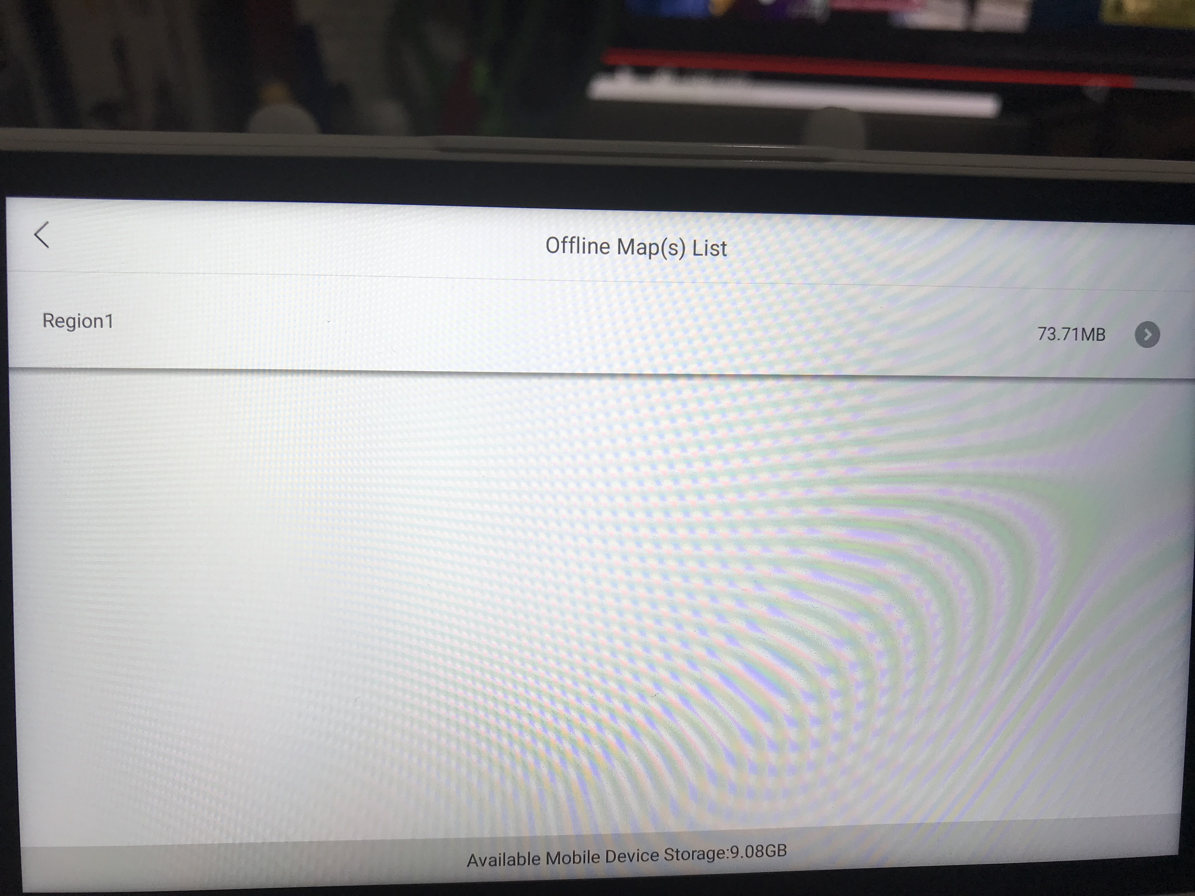

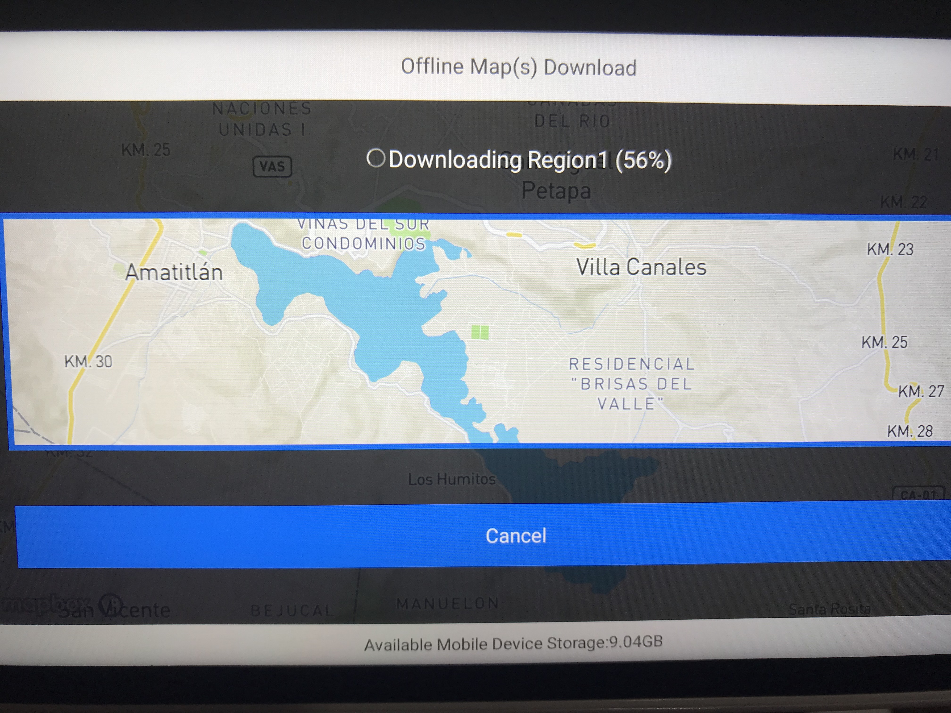

Click Download. I was unable to rename the region because the type pad has a glitch, so I just saved the area as Region 1.
After the download, you can click on the map with pencil icon in the upper right and you will enter the map management screen. There, you can press on a region and you will get a menu to rename (doesn't work for me - same glitch) or delete.

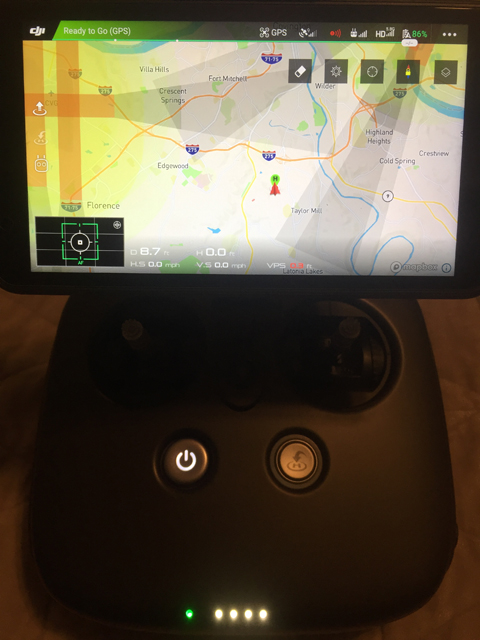

Shutoff the wifi.
Go to the GO Fly screen (Enter Device). Make sure you have your maps set to Standard. Hybrid and Satellite will not work.
My map came up automatically.
I hope this helps you. I am going to try and save maps for the area that I am visiting on Monday and I hope it will work. I will update. :) - Alexandra

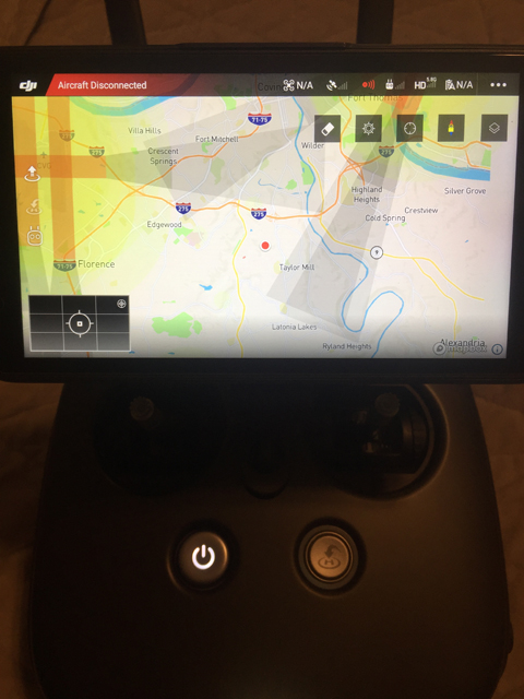

Wifi off, Aircraft Disconnected
and
Wifi off, Aircraft Connected
