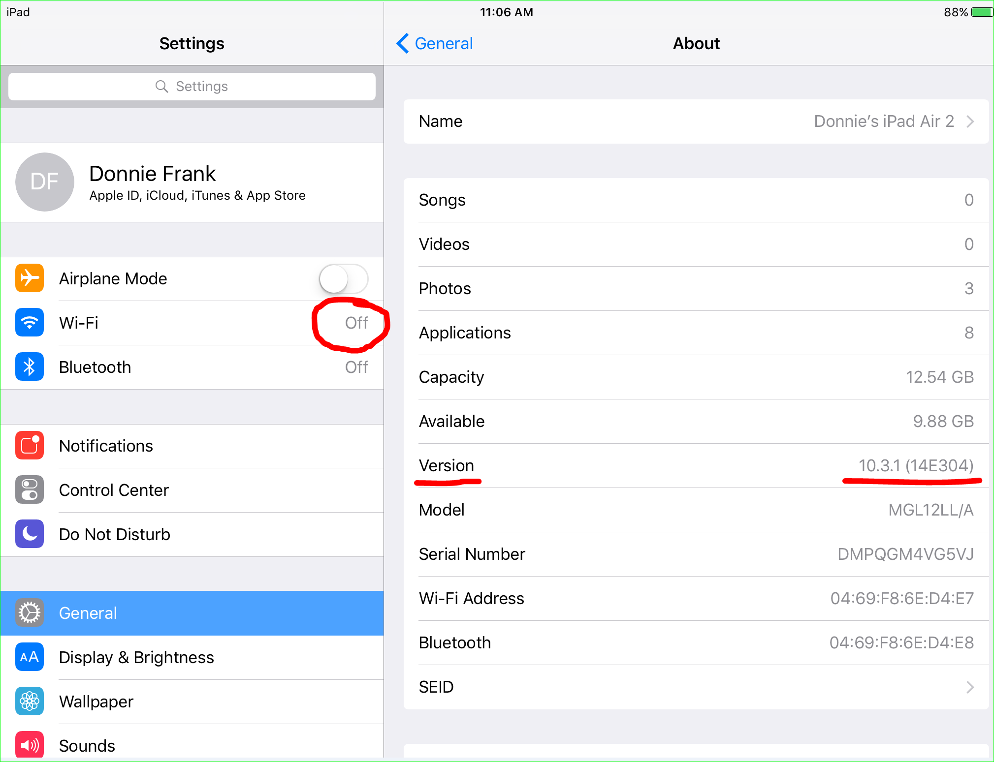

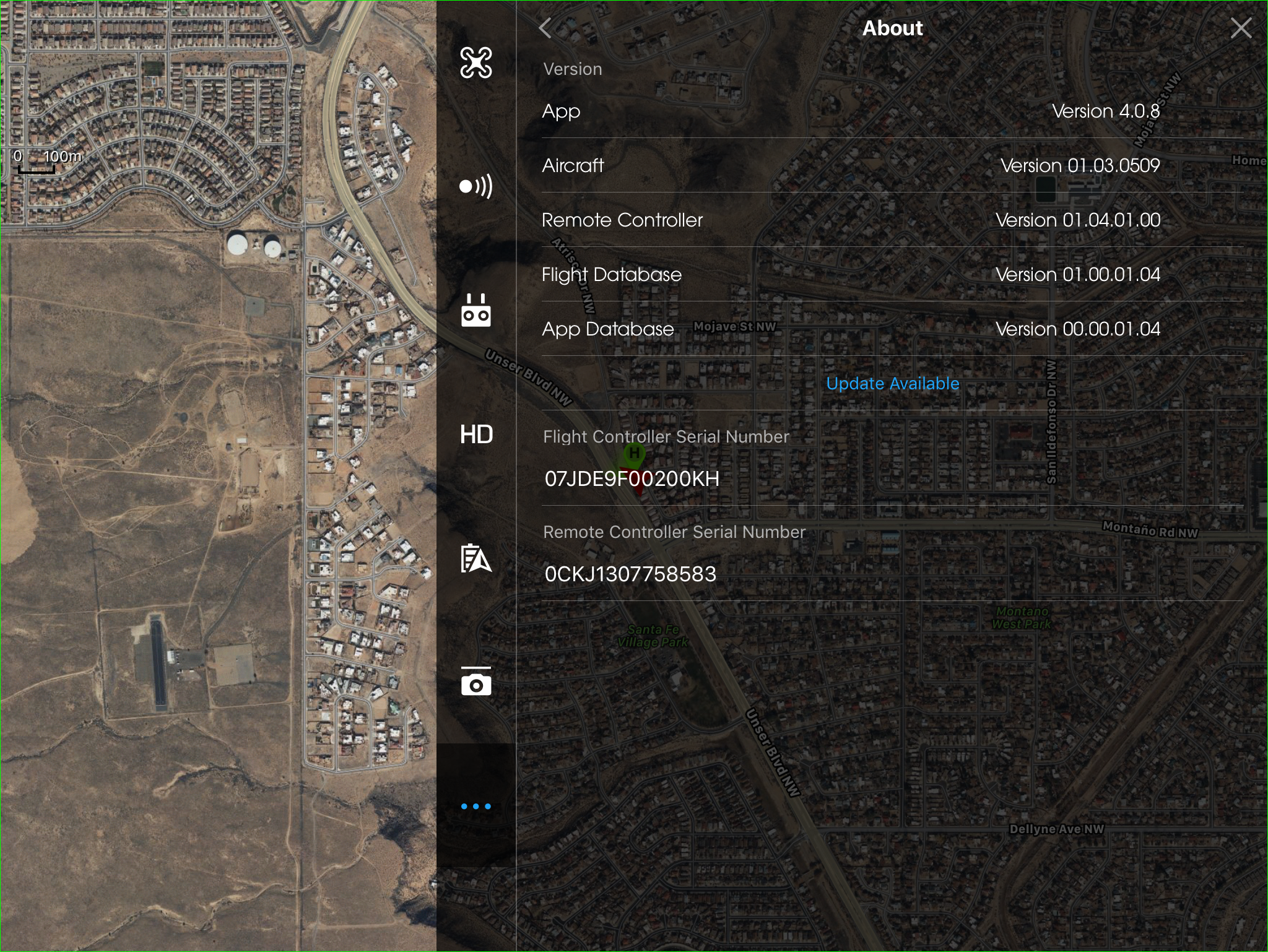

As always, the answer to every question I've ever answered in this forum is the same; "Legacy firmware. Legacy software." I'm not sure where your bottleneck is. I would guess software (because that is where map caching is stored), but it may have something to do with firmware, as well. For instance, the legacy software that WORKS with the P4P may require legacy firmware.
Use DUMLdore to roll back your firmware. Rolling back software in an iPad is much more complex, and I won't get into it here.
Here are the versions that work on my P4P (notice map cached in the background):
This information gets you 90% there. You'll have to do your own research for the remaining 10%. This effort will be the poster child for diminished returns, as most of the work, time, energy and effort will be spent figuring out the remaining 10%. It's not an exact science. So what works for some doesn't work for others. Hence, the reason I tell you to figure the rest out on your own. Look into using CharlesProxy to gain access to legacy software. I've never rolled back iPad iOS because I've never had to because I never allowed any of my 5 iPads update. They are all stuck on the iOS they came with (a hack within itself)(see above screenshot).
