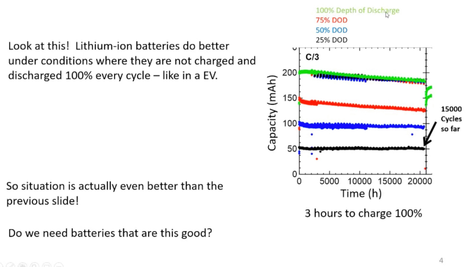

elsewhere, a world authority wrt lithium-ion batteries reports
do NOT discharge 100%.....:
Tesla battery researcher shows new test results pointing to batteries lasting over 2 million miles - Electrek
