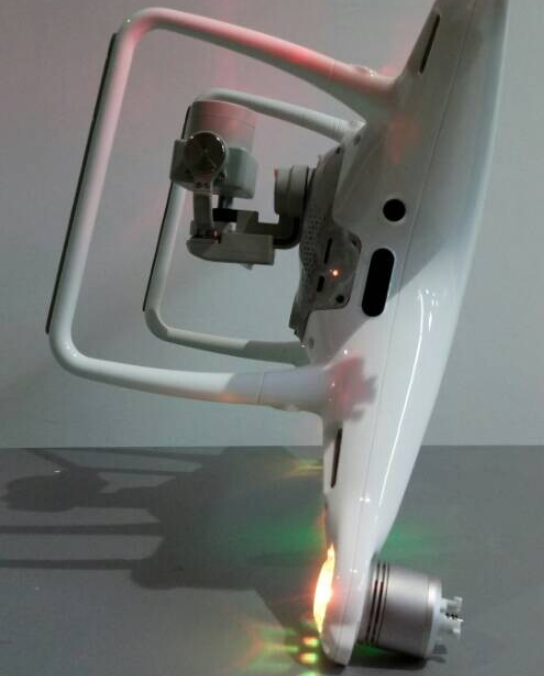

4. CROOKED CAMERA. With the craft turned on ready to fly, looking down from the top of your drone, the camera should be pointing straight forward. Many craft are built with the camera pointing left or right 5 to 10 degrees. A dual axis gimbal calibration can fix this most the time. There have been reports of DJI recommending to simply twist the whole gimbal in the opposite direction and it will eventually slip and scoot into place, but most guys are too worried it will break first. IMO, if the dual axis gimbal calibration doesn't fix it, then return for exchange with your vendor, or return to DJI for repair.
Double gimbal calibration is first executing the calibration steps on a level surface, but with the craft front pointed straight up, balanced on two motor arms and two motors cases (see SteveNPhx photo below in next post). When balanced, the craft is pointed facing up, but not exactly straight up when balanced. That good enough though. After that odd calibration is completed while point up, then immediately do another calibration with the craft sitting level on the same level surface. This dual calibration trick worked for me, and it has reportedly worked for others

Crooked camera can be fixed by a different gimbal calibration that DJI only mentions in their forums. To do this calibration, turn on your Phantom (I know this works on the standard P4 as well, I've tested both) and let it warm up. On a level surface place the Phantom as shown in the picture (it will balance) and run the gimbal calibration. After that calibration is done, cycle the power and run the calibration normally again. This causes it to calibrate on a different axis and centers the camera to the body. My camera pointed to the left when I first got it and now it no longer has this been an issue.
