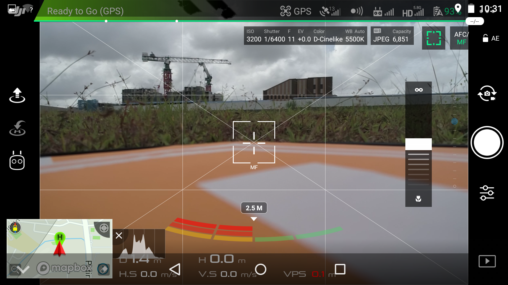

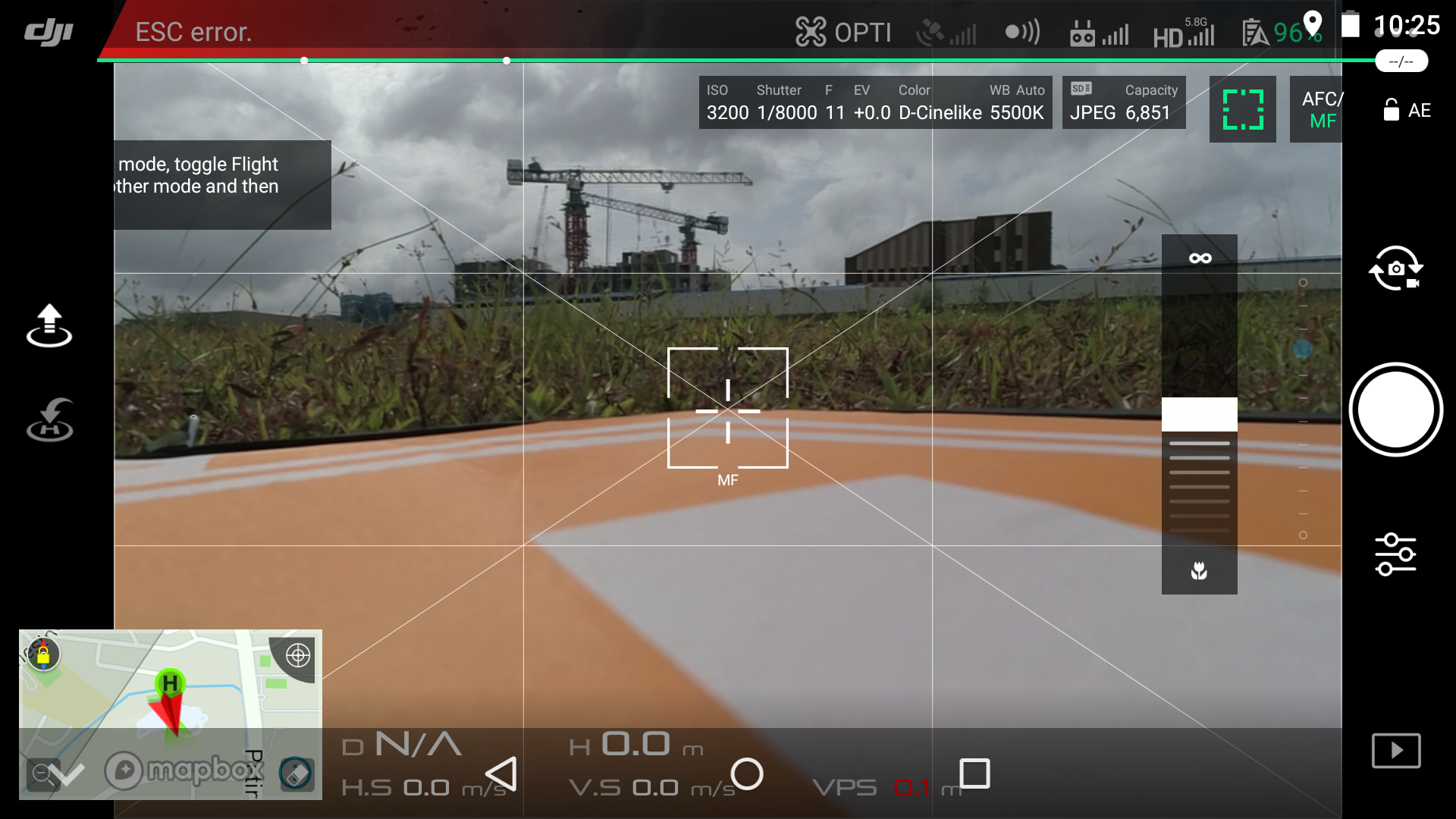

I have a P4P+. I have been getting ESC error once in a while and the AC does not take off. Once it took off and a message came to land the AC immediately. The issue is that error message is not consistent. Most times, the error doesn't show up after swapping batteries. But later the same battery when inserted shows no ESC error message and flies normal. What could be the reason?
I have a P4P+. I have been getting ESC error once in a while and the AC does not take off. Once it took off and a message came to land the AC immediately. The issue is that error message is not consistent. Most times, the error doesn't show up after swapping batteries. But later the same battery when inserted shows no ESC error message and flies normal. What could be the reason?View attachment 123278View attachment 123279
Have look in warnings in app and clear it in case its poping up from its memory,,maybe a IMU calibration might fix anything small goin on
1. I have refreshed the firmware using the DJI Assistant.
2. All sensor calibration seem to in order.
3. If popping up from memory, it should come every time before take off.
4. I am not sure if this is a hardware or software issue.
